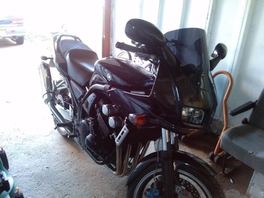

pics: Me sat on it before I bought it, and in its new home. If I look a little haggard, well 6 kids will do that to you.

Looks tidy  8)

Hmm dont want to worry you --and I may be wrong, but I think that your decals are wrong for a black 98, has it been in a crash before you brought it.
Here is mine and you can see yamaha on the tank and fazer on the fairing.
.jpg   IMG_058712.jpg (Size: 119.3 KB / Downloads: 138)
A mate took it out for a spin to check it out, pulls like a train he said, its noticeably more powerful than his Bandit. Fazersharp  a couple of fairing brackets weren't quite straight, so I do believe it has had some sort of minor shunt and a new fairing fitted. I quite like the minimalist decals though.
Quote:I do believe it has had some sort of minor shunt and a new fairing fitted
That would explain the lack of "fazer" but also if not a respray the tank if off a later model - hence the logo instead of yamaha.
