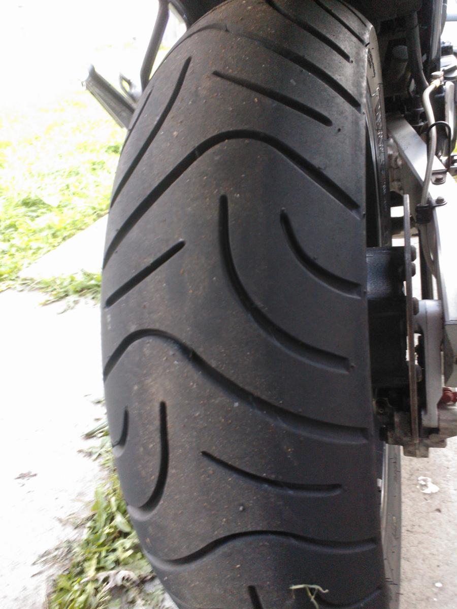

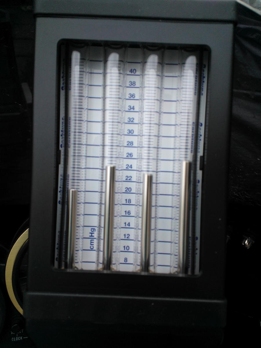

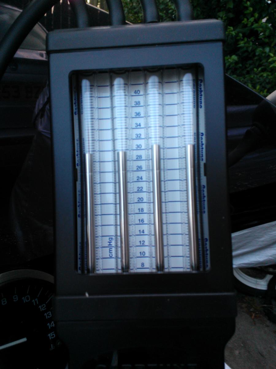

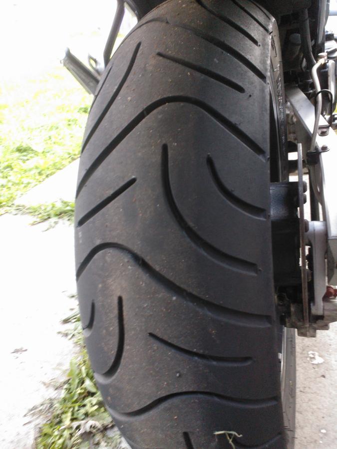

Then I set about doing EVERY service item in the Haynes manual. 31 jobs in all. New fluid all round. New front pads. New rear tyre. One of the items was carb balancing, so I got myself a Morgan Carbtune. See pics of before and after.

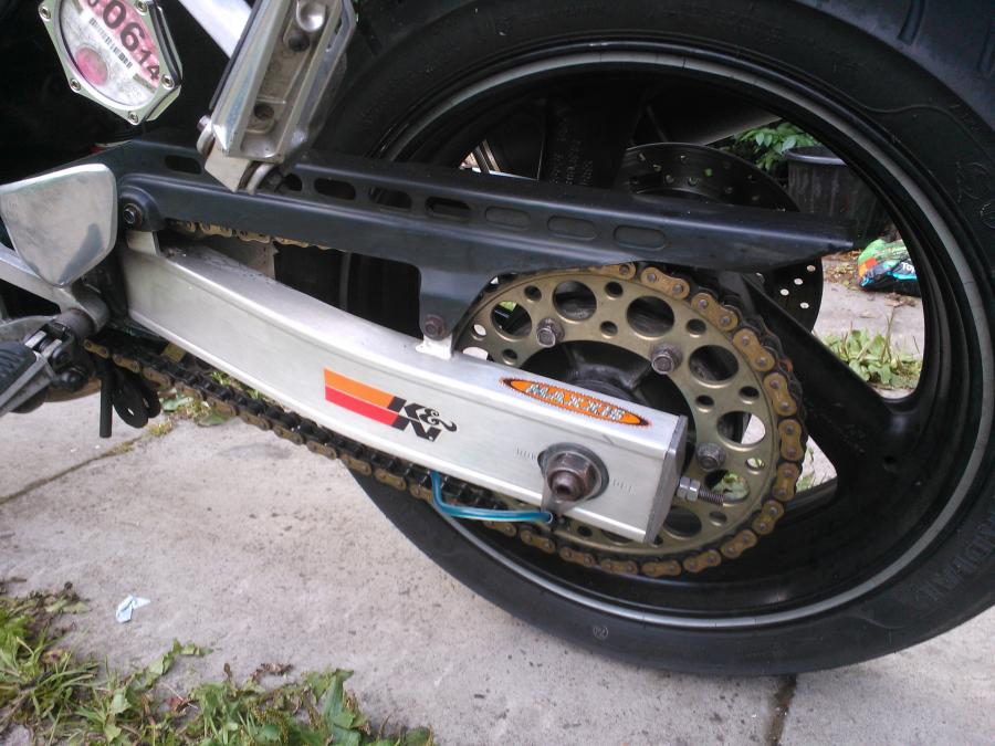

I also posted about chain adjustment when touring. A Scottoiler V system seemed to be the tool of choice, so I got one of those too. Works a treat.

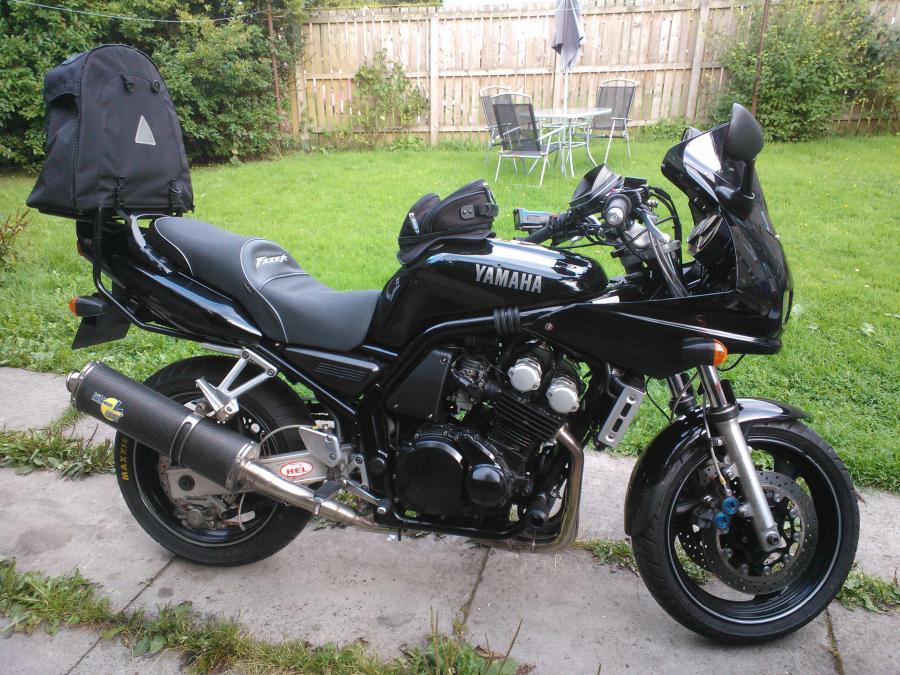

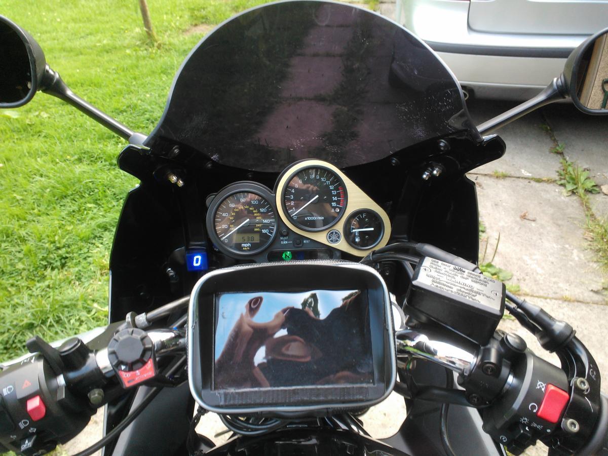

I also got a Ventura luggage system, Mini tank bag, Viper touring seat, sat-nav mount (for my phone) and a waterproof sports camera.
I got out yesterday for the first time in a couple of months and had a 110 mile run to bed everything in and see how the bike is feeling post alterations/service. I have to say, I am very, very pleased. The carbtune did its job, well worth it. The new pads are street racing grade, and with the Hel lines, it stop's well. The luggage hardly affected the ride and the seat is fantastic.  Got that tyre scrubbed in too  :lol . There is a wee bit of test ride footage from the sports-cam below. You can blame youtube for the poor quality, the original footage if much better.

should have given me  a shout adeejaysdelight - I would have happily loaned you my carbtune and saved you some sovereigns Smile

What a difference that carbtune makes though. My mate that I am going touring with has an SV650. He is a pro mechanic and a very technically clever guy, but he was not keen on doing his until we returned for fear of fu**ing something. Now that he has seen the improvement on mine he is coming down midweek to do it. Well I'm thinking I'll do it for him and he can fit my HID lamp kit instead  :lol

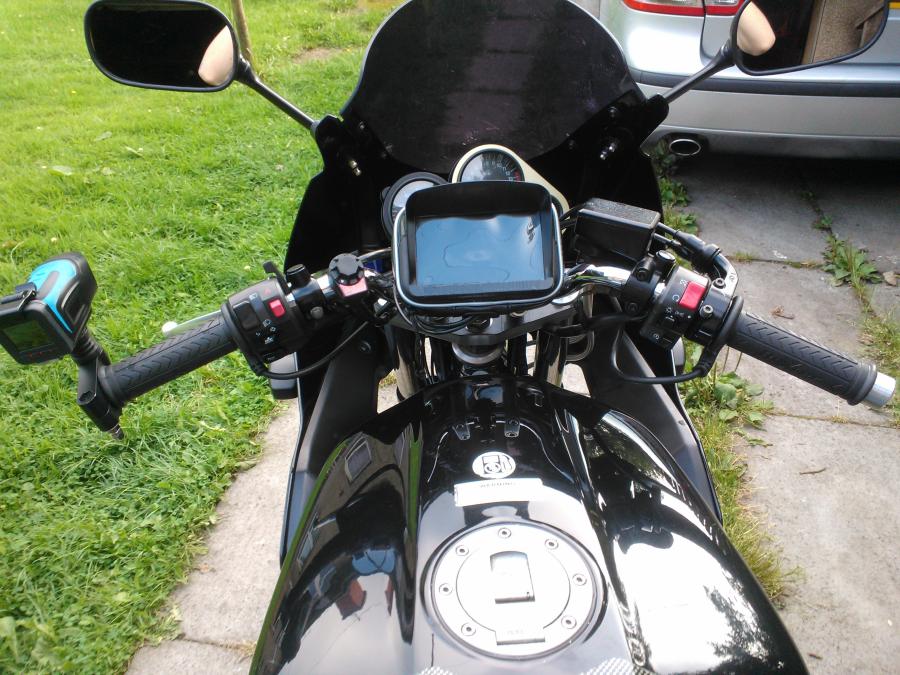

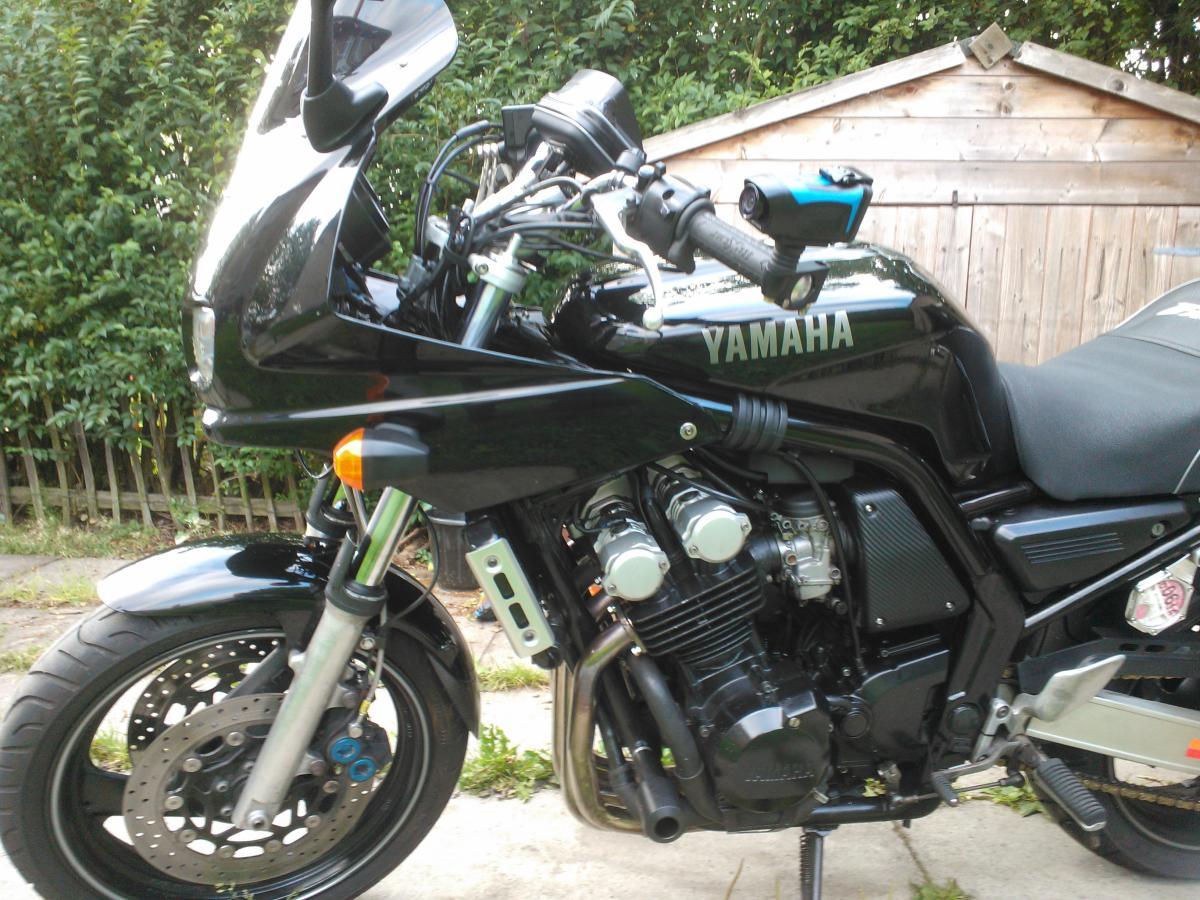

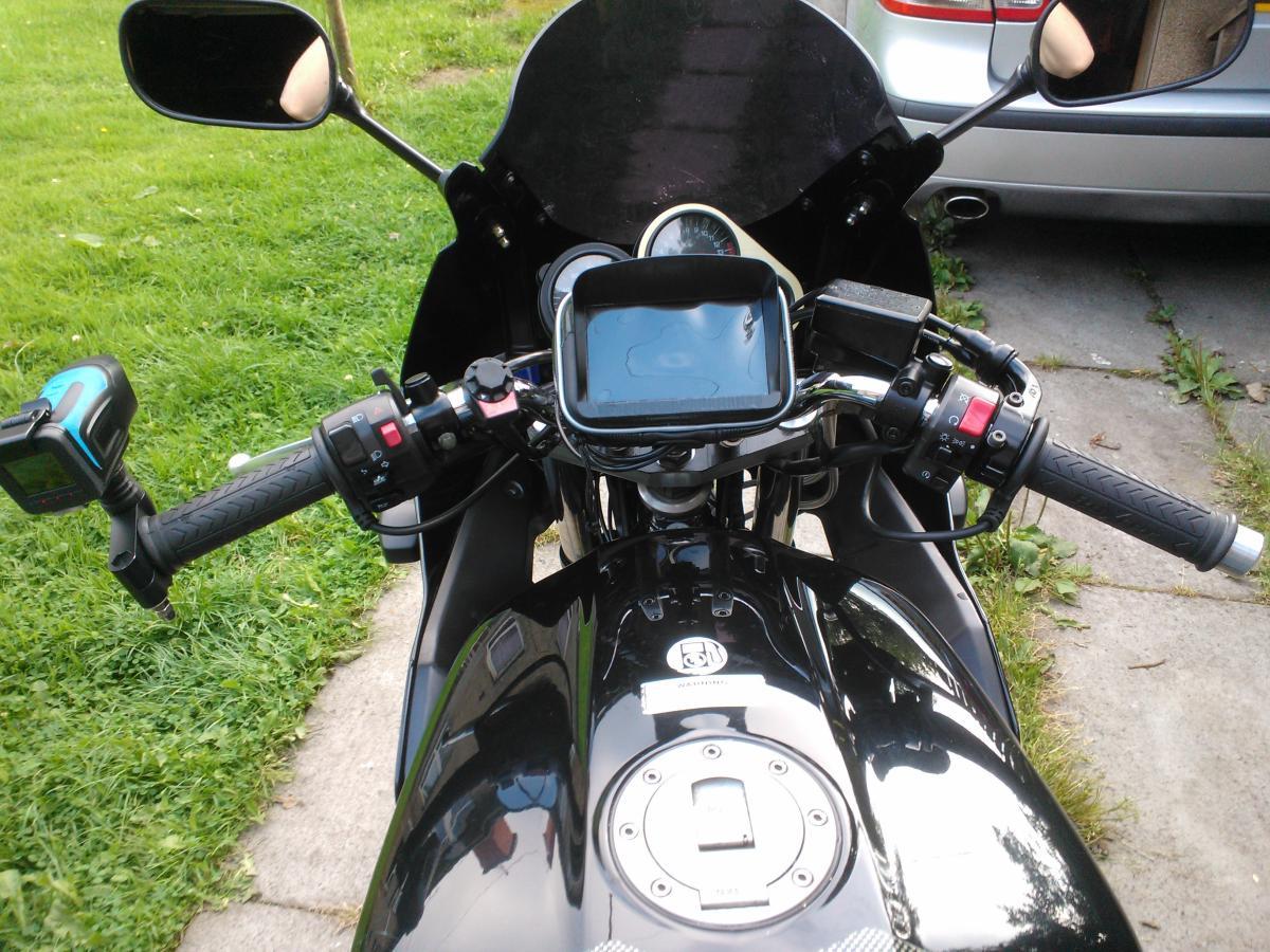

what kind of camera is it you have got, looks a pretty good picture, and where have you mounted it, front forks/fairing I assume?
good road too the brig o turk road is Smile
I went for this camera - http://www.ebay.co.uk/itm/140935087681?s...1497.l2649
You can see it mounted on the left hand bar end in some of the pictures. The picture quality is far better than YouTube has it. It has selectable quality, can record upside down, up to 32gb card, external mic option (not used in this film), waterproof (tested in bath  Wink ), good build quality and a load of other features making it stand out in that price bracket. And yeah, that is a great road. Not often used by bikers either.

Oh aye... How did I miss that on the handlebars :lol
