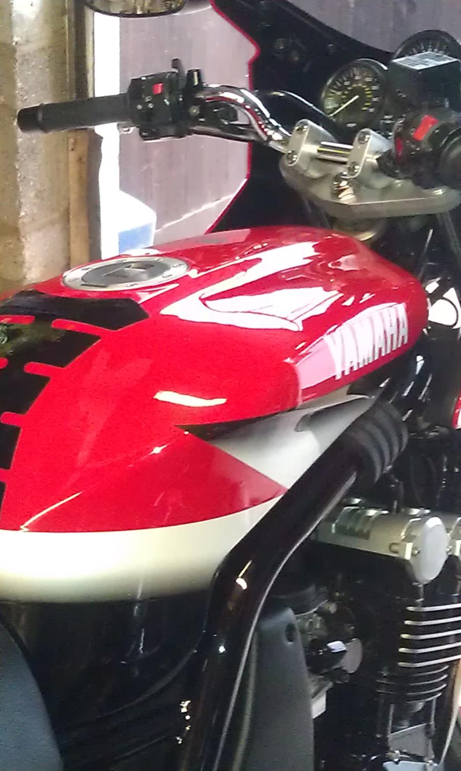

Clean the bike then dry it off. Apply a THIN layer of carnauba wax and leave it for half hour or so, wipe the wax off then buff it. For a really deep shine, apply another coat a few hours later once the first one has cured.
Whoops, dunno why that pic came out so big?????? :eek
