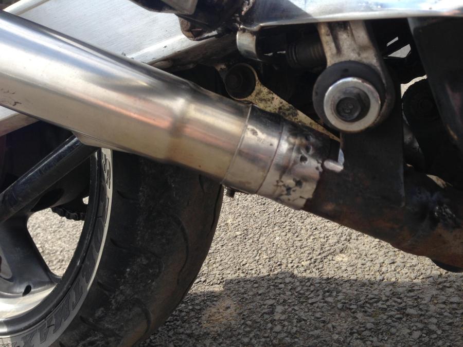

Just went for a spin on my cousins bike for the last time before I have to bring it back on Friday and the exhaust fell off about a mile from home, just split at the joint under the peg, had to pull it forward and onto the peg and hold it with my foot against the peg so no rear brake the rest of the way home, now I'm panicking. The end of the exhaust looks like it completely rusted and doesn't look like there's any exhaust left to clamp the down pipe from the slip on onto the exhaust. Any ideas?
Aftermarket or stock exhaust? By the looks of the photo its the link pipe that has gone - if so I would guess it just needs to be replaced which is easy enough if its aftermarket as the cans are typically separate. If it's a stock exhaust then the whole can needs to be replaced as its sealed on to the link pipe I believe.
If on the other hand its snapped off from the downpipes then... I don't know. They aren't the cheapest things to replace unfortunately Sad
Looks to me like the part of the downpipes that goes inside the link pipe.. Don't know about fixing it without replacing the downpipes though...
Not your fault though buddy, it could have happened any time. Sorry I know that's not much help...
Give your cousin a ring and let him know what's happened, I'm sure if you're straight with him then albeit a pain in the ass it's noones fault and it's not like you crashed the bike or something.

could it be welded ?  Wink
I'm not sure, it's the stock down pipes and from there back I think it's aftermarket, it may just be the link pipe, if that's all it's not so bad, I told him, he sounds very pissed of but like was said it wasn't my fault, driving on straight smooth road and just came apart. Never touch exhaust before this, just unfortunate.

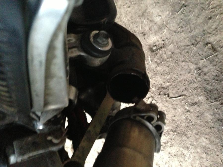

Ok it definatly looks like the gasket is gone. :'(
put a piece of smaller pipe inside, add a bit of exhuast putty, then hand back the keys job done . 8)
(03-04-13, 10:18 PM)reillypadraig link Wrote: Ok it definatly looks like the gasket is gone. :'(
I have a brand new exhaust gasket. I'll sell it half price (€8) plus whatever standard post is. Probably easier to send it by that courier for a €6. Let me know if you want it.
Can't tell from your photo, but the if the link pipe sheared/rotted, maybe you can get a sleeve welded over both pipes.

As for the exhaust I was looking at it and don't think the gasket will work, think its a aftermarket slip on job, just the end of the manifold has rotted away a good bit, I guess it good it happend to me in a way cause he is a f**king egit on it, and if it came off and him doing 110 and over could do some serious damage

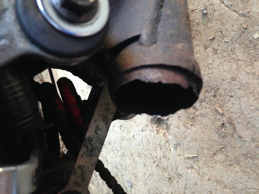

He really hasn't any clue about looking after them, he said he thought bike was 100% when he gave it too me, oh never again, mistake well learned. Going to fix exhaust this morning, not a clean break but it is a break after all, now have to go get the bloody thing welded

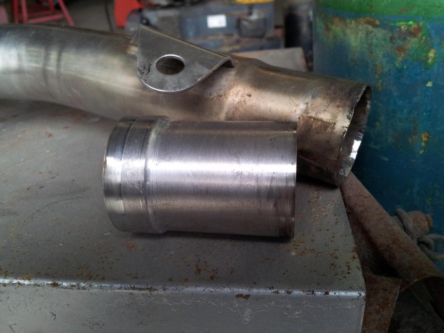

Also, that metal looks very thin and exhausted. I had similiar type of problems on one of my old pipes and from my experience is that it will go again which i'm sure your welder will tell you also. So warn him of the possibility so he can keep an eye on it if he chooses. Also, don't be a bit surprised if it can't be welded at all. The metal is so thin that the welder might keep blowing holes through it in trying to fix it. Best of luck, anyway.
Thanks dude, gona need luck with this, it is very thin indeed, might just have to cut it of and weld a short new bit of pipe in its place, hope its easy job, don't want handing out a fortune for something that wasn't my fault. Also packie yes my own bike is flying, apart from the little splutter from 1k to 5k( which I have yet to investigate) (maybe new plug caps) it's running sweet, just Ur man has his street fightered ( horrible in my opinion.  And he wanted to show it of on the parade, that's all, otherwise I would have brought mine. (Would have been more reliable

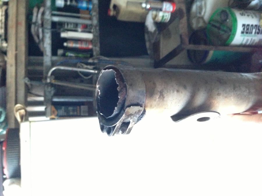

Got it fixed now, 55 quid out of pocket but I made Ur man put 65 on the receipt, fuck it, good job though, definatly get my own tidied up for next year. He also fixed carrier bracket, that's what caused the break, exhaust was rotten and with the loose end can it just shook it until it snapped
