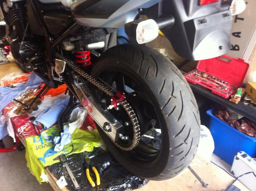

So after 20 hours of labour the swingarm is complete, polished and reattached to the bike.... including lots of shiny nuts and a fazer thou shock conversion(not for the faint hearted).... what do you think Foccors??

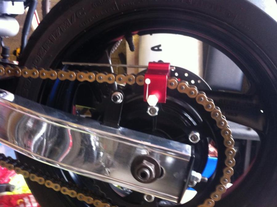

and another shot

First shot didn't do it justice, but the second looks very nice Big Grin
Will be good to see a final shot once everything is back together and its on the road Smile Gonna be a right b!tch to maintain though Tongue
Looks lovely, but you're not going to want to take it out on our filthy salty roads now are you? 8)
Nice one, love the dedication. takes so long to get it to shine like that  8)
[Image: 208008.png]
Stupid question probably but what's that red thing with the bar sticking out of it?
Eagles may soar, but weasels don't get sucked into jet engines...
looks like one of thoes gizmos to clean the chain
do believe thats a chain adjustment / alignment tool. Wink
ohhh so shiney! 8) you could lacquer it to help save the shine.
love it
A set of red radiator hoses would really set off that rear shock nicely  Wink
I'll shut up now... Ooooh, look at the shiny shiny  Big Grin
