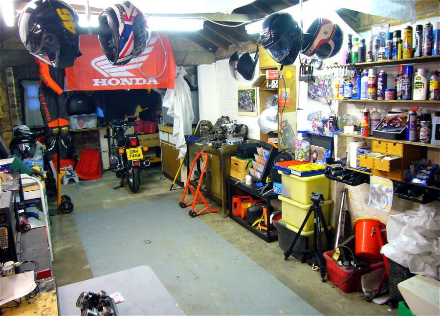

(29-10-12, 10:01 PM)triker link Wrote:I used PVA glue ,mixed with water.  Soakes in and sets. Did a great job in my garage  Big Grin  Cheap to.
yep..........same here. I actually PVA'd mine 3 times before i painted it (grey). each time i uped the PVA to water ration.
Done before new bike arrived
[Image: file-6.jpg]
