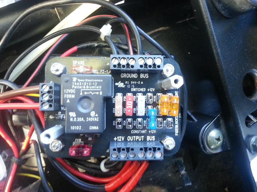

What is a fuzeblock ?  If you've got a number of accessories on your bike like heated grips, heated jacket,  USB power for phones/sat nav, and any auxillary lights or even wiring in a optimate charge lead something like a fuzeblock.  You could make one yourself but for a neat simple device that you can take from bike to bike then this is a straightforward bit of kit that has served me well.  As each circuit is individually fused i can have one of my accessories fail / go kaput and only that circuit will go rather than everything.
A handy wee feature of the device is the option ot have an always on or switched circuit - and by just changing the fuse position for that circuit you can flip between only on when ignition on, to on all the time.  This could be handy if you are charging a phone from the USB socket or something and want it to be on while you are away from the bike.

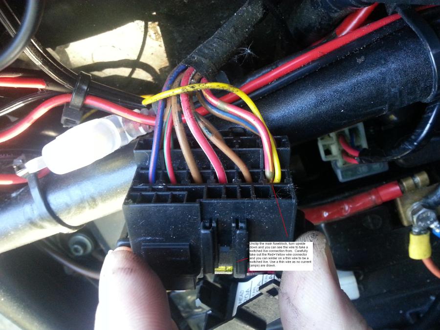

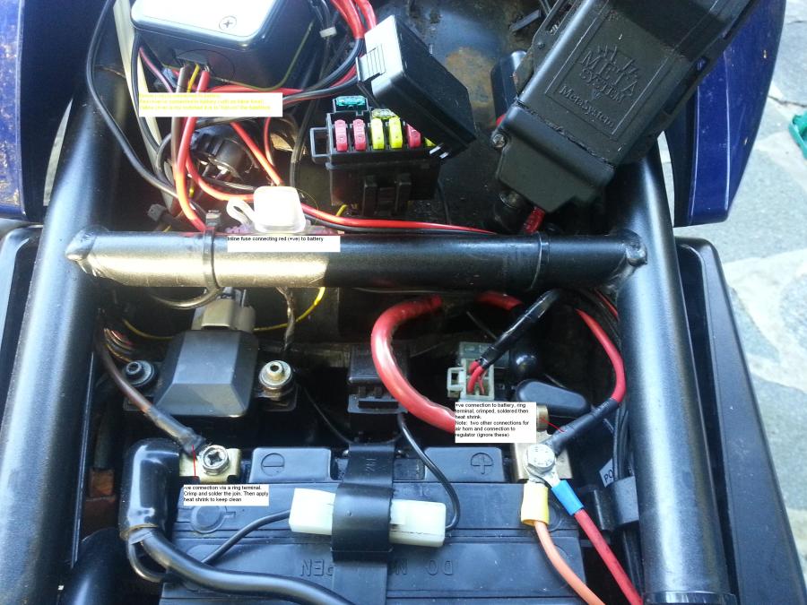

The fuse block needs 3 input connections.  A positive , negative and a switched live.  The positive and negative are direct to the battery,  you should put a fused connection in the positive wire.
The trickiest part of this is the switched live.  After searching on the forum there is a neat solution as detailed by "nastyandy" in his photos.  In the main fusebox by the battery a number of the circuits are switched on when the ignition goes on.  We can't directly power anything from these circuits (or rather we shouldn't, as we don't want to add extra current to them) but they allow us to use them as a switched live feed for the fuzeblock as a feed will activate the relay and turn on the positive feed from the battery in the fuzeblock.  I don't know the current needed to power and activate a relay but it is in the order of a few milliamps - basically a negigible amount and it won't cause side effects or other problems with the electrical circuits on the bike.
If you look at the thread below see the photos from nastyandy as he shows you how to wire in a switched live wire.  This will be the wire that connects to the switched live of your fuzeblock.

[size=1em]You can take a switched live from a variety of places on the bike, but as i mounted the fuzeblock on top of the CDI unit the wire run is small and convenient.  The fuzeblock mounts with some sticky pads, i used some that were for sticking on a car numberplate, and it has enough room for the seat to go on.  [/size]
[size=1em]When running the wiring to the fuzeblock you'll want some wiring suitable for 20A @ 12v , this may seem excessive but if you run a number of accessories off the device you don't want any voltage drop.  Some 10 or 12 AWG wire would be very suitable.  [/size]
You are now ready to do that heated grip install, install those extra lights etc.  I wired up LED lights to handguards and converted my Oxford heated grips to run off fuseblock rather than straight off battery. Althoguht the grips claim to turn off when the voltage drops i forgot to turn them off a few times and whilst they did turn off, there wasn't enough oomph in the battery for the bike to start after.  So to save being stranded the grips now turn off with the ignition.

I followed the instructions above when fitting a Fuzeblock FZ1 recently, and would make one small improvement to the wiring solution. Rather than connecting the switched live wire of the Fuzeblock to the Red/Yellow wire under the main fuse box (which is the fuse protected side of the headlight fuse), use the other side (the brown/Blue wire) instead.
If the headlight fuse should blow, and you are connected to the Red/Yellow side wire, you'll also lose power to the switched wire to the Fuzeblock, which will in turn off all your "switched" accessories connected to the Fuzeblock.
Whereas, when connecting to the Brown/Blue wire (the battery side of that fuse) you'll still have a power signal to the Fuzebock switched wire, and hence all your accessories will continue to have power.
