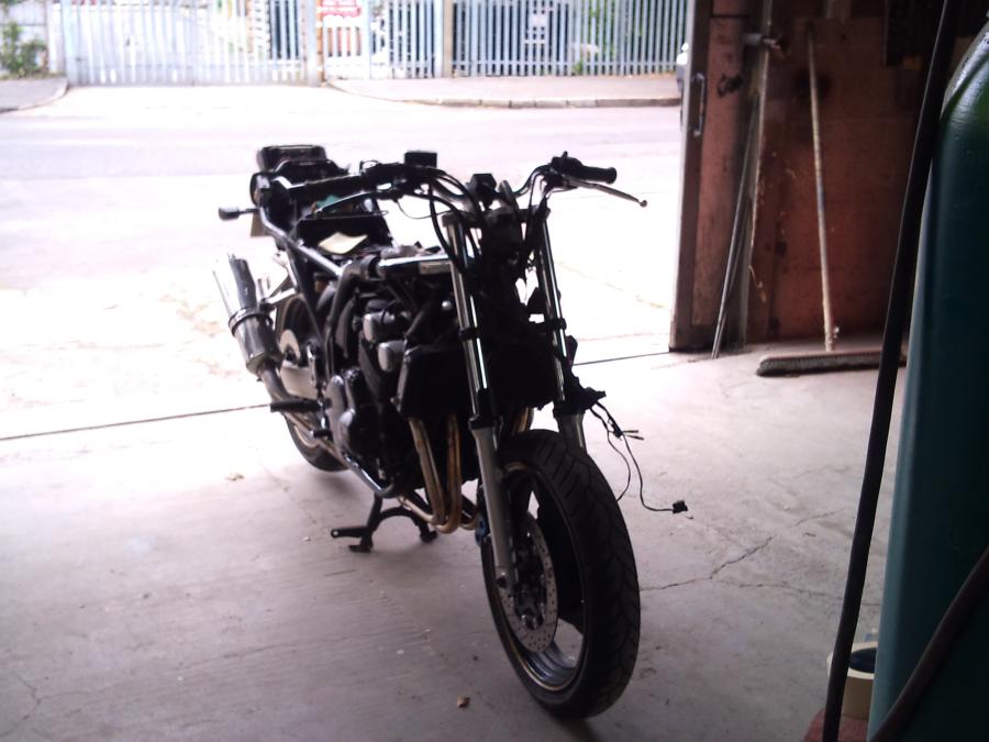

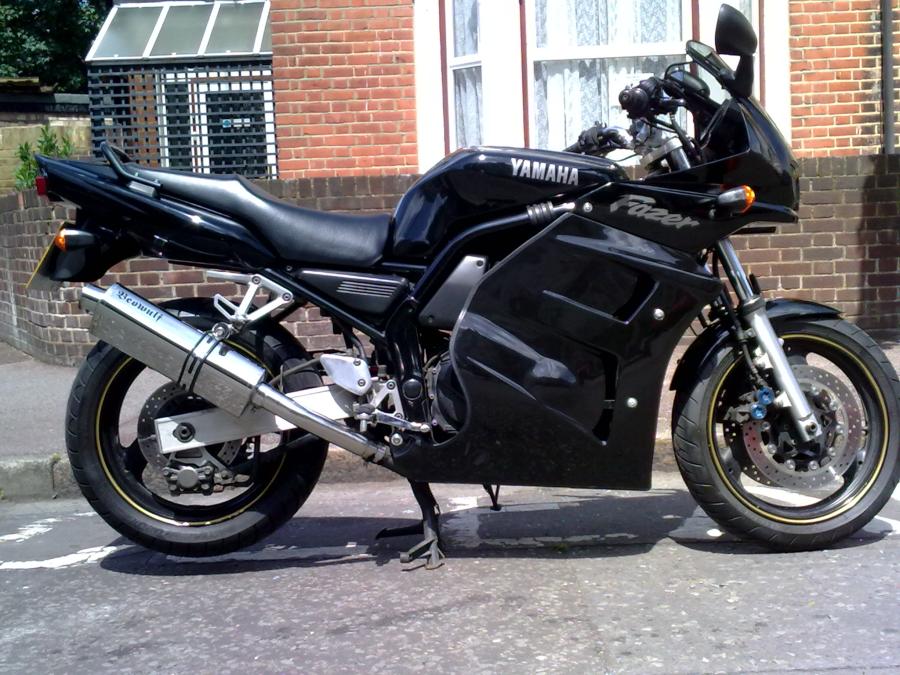

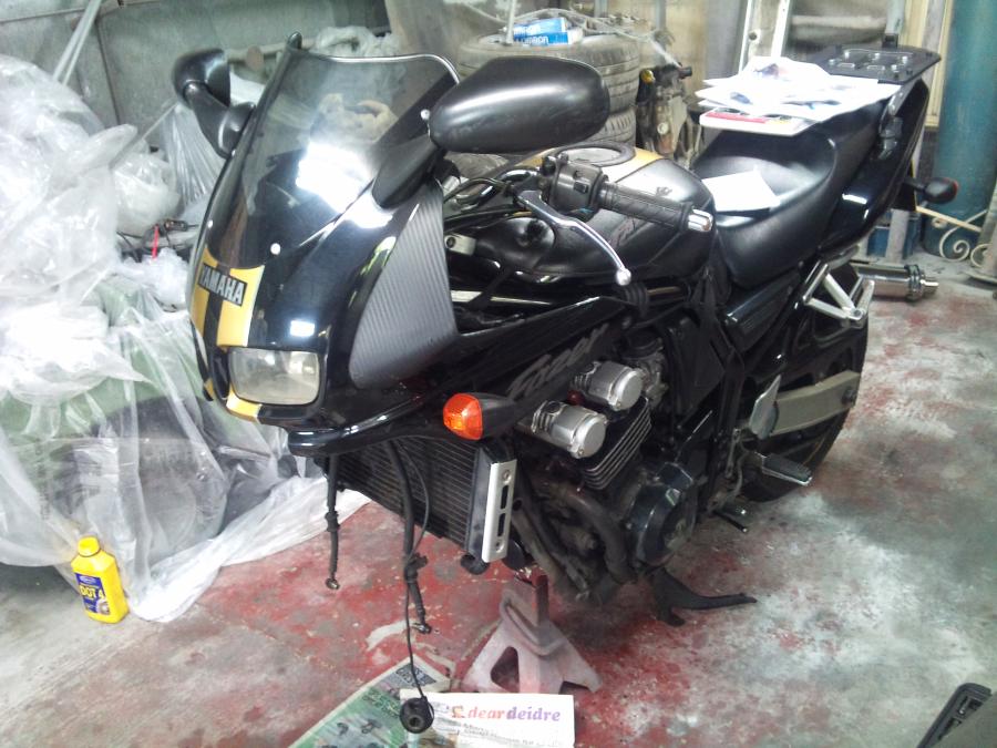

Before: extensive damage to body/ paintwork. Front wheel bearing, leaking downpipes, seized front brake calliper etc...

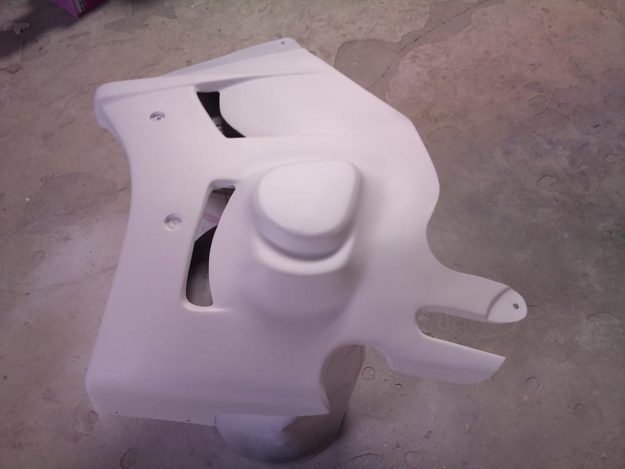

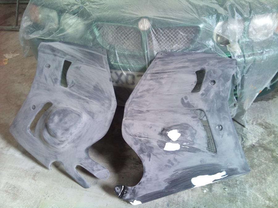

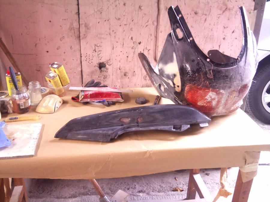

Chapter 1: Fibre glass repair on cracked pannels using chopped mat and resin. Finished with body filler to smoothen out the surface. Quite a straight forward process but prep work is the most time consuming i.e sandind down with various grit sand papers, going finer and finer to attain a smooth finish.

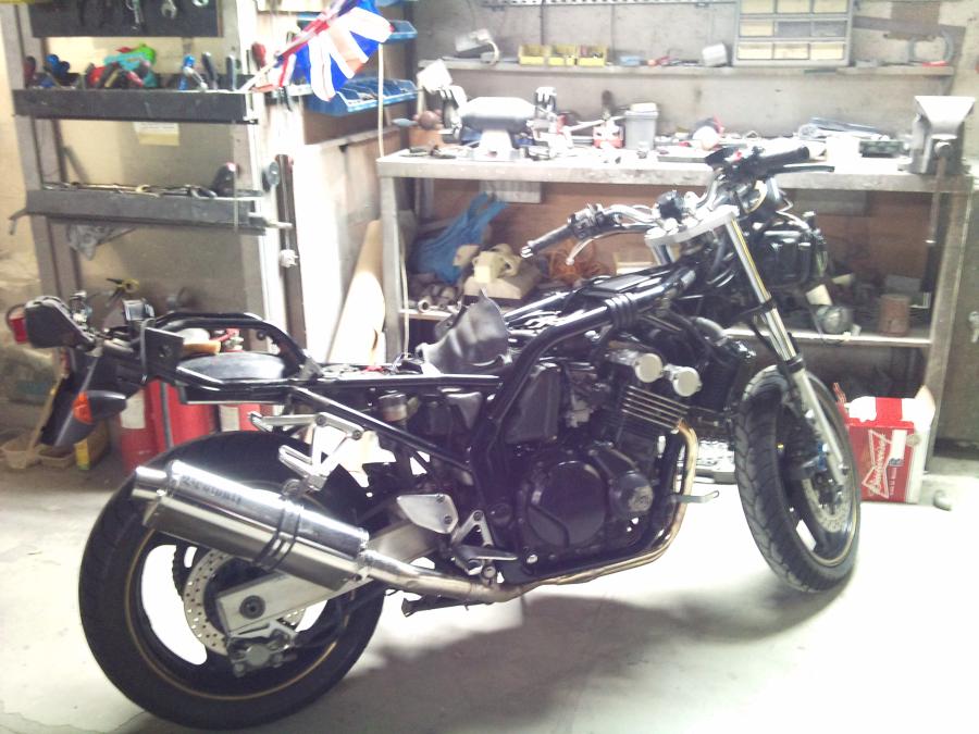

Stripping all pannels of ready for reapir and respray. New motad venom stainless steel downpipes, k&n air filter, ebc brake pads, fresh fluids and front brake calliper.

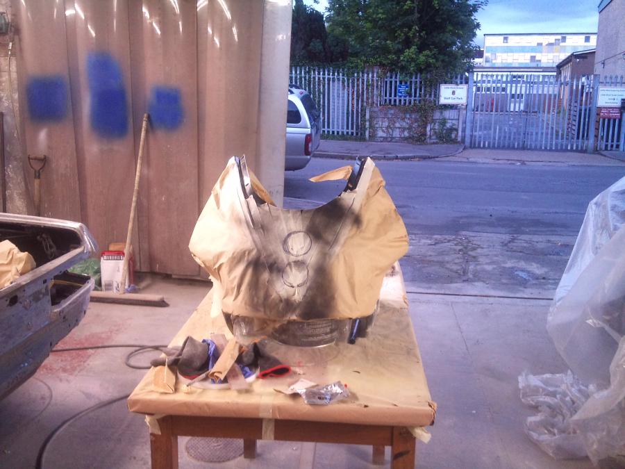

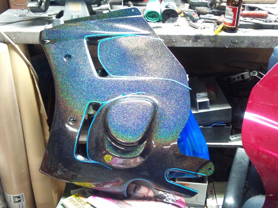

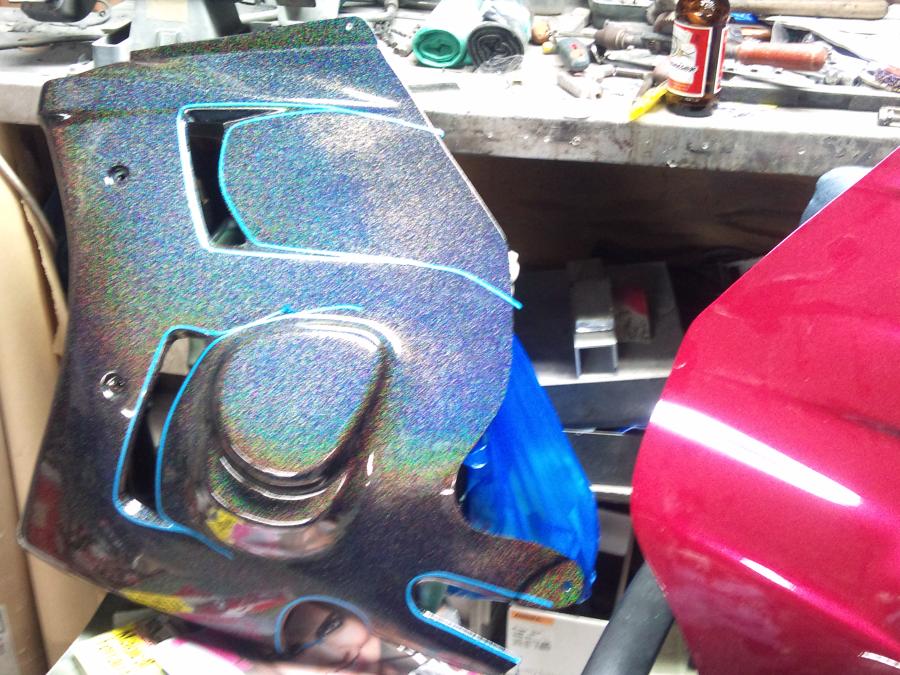

priming pannels and custom rainbow flip paint with a black base coat (didn't go with it in the end)

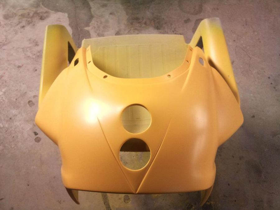

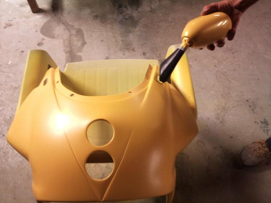

Mock up of the front fairing, idea was to make it more streamlined and curvaceous whilst getting rid of the blocky headlights (said headlights for sale) and replacing them with 2 projector lamps positioned vertically.

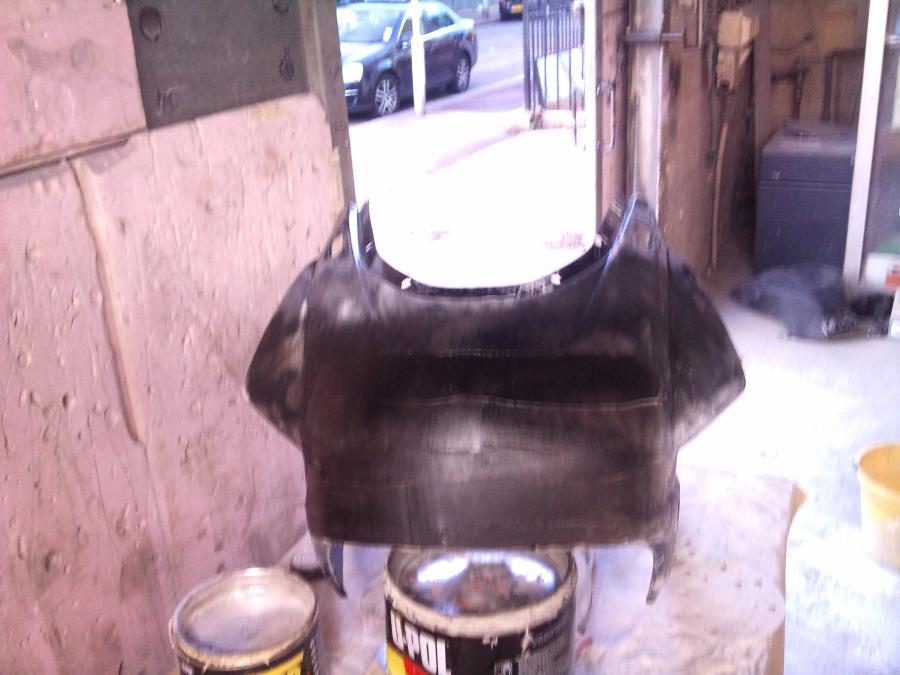

Plastic welded, fibre-glassed and  fillered front fairing.

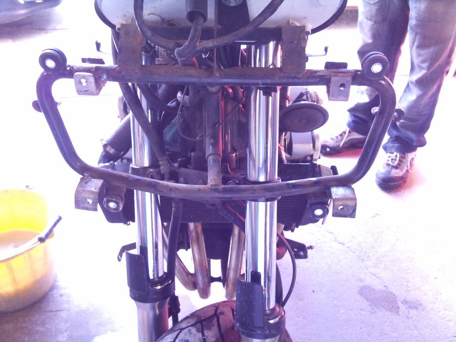

Chapter 2: Headlight and bracket

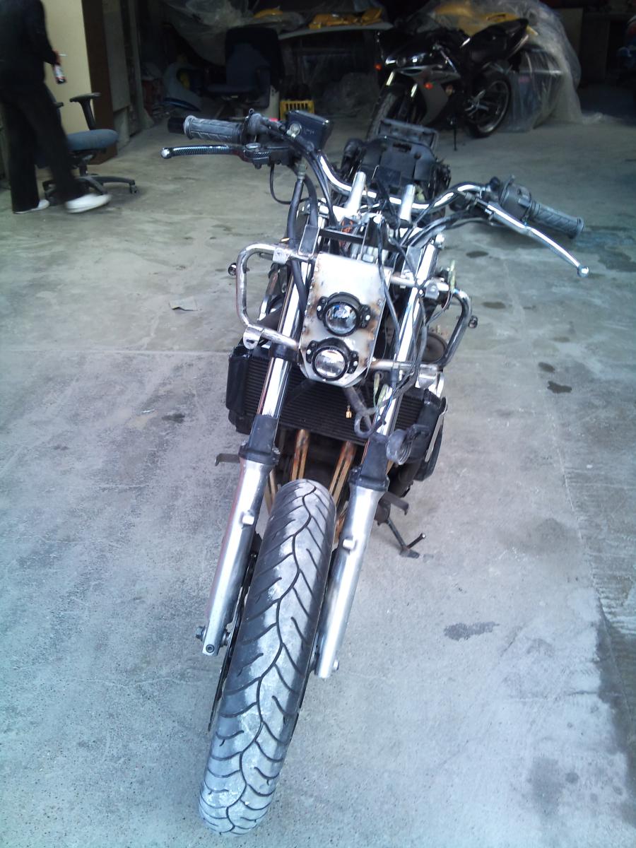

Was only 5 days into the project and work on the headlights began. Fabricated a headlight bracket using the existing subframe and creating a housing for the projector lamps. My buddy Joe amongst other things , wonders with metal. After a lot of tweaking finally got them positioned and function correctly. Going to be using an LED strip light underneath the fairing as a daytime running light. End result? Headlights that actually work and look great!
pictures of headlight and bracket
Is that a headlight from a Thumpstar?
Smell ones mother. Yaas!
No headligthts are not from a thumpstar but 2 projector lights (one main and one dipped) with 40mm lenses. Bracket and headlight housing completely custom made from a sheet of  good'old stainless steel ;-)

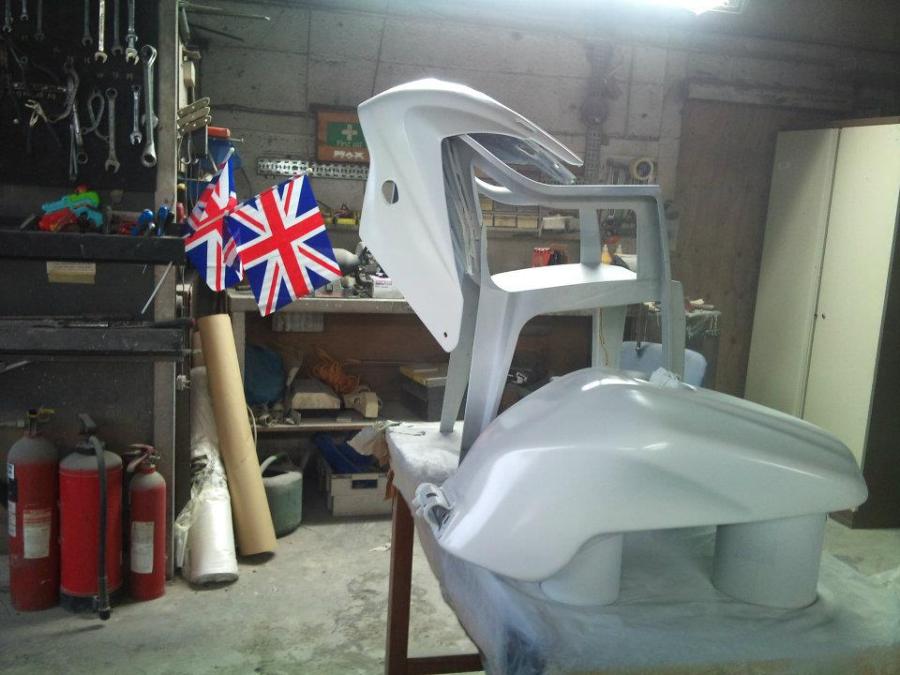

Chapter 3: Custom Front Fairing

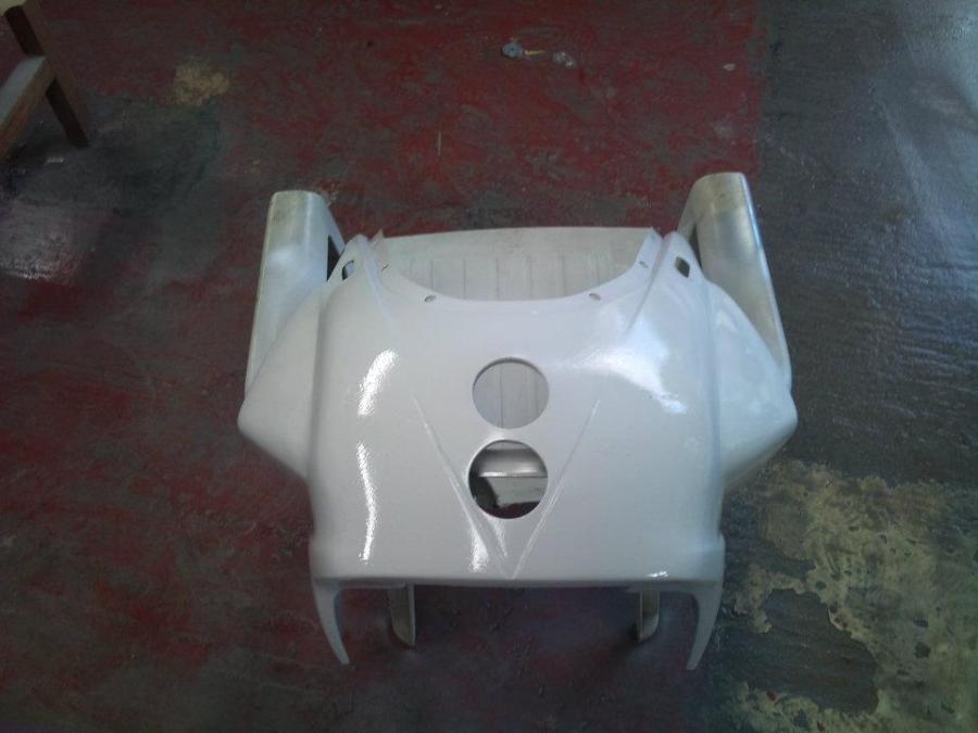

Was by far one of the most ambitious parts of the project so far. Aim was to create a curvier sportier front fairing whilst retaining the Fazers identity. Covered the little air scoop/vent at the bottom of the fairing to make it more streamlined. Also wanted the mirror swage-line follow through to the bottom of the pannel. After hours of fibre-glassing, filling, drilling, sanding and sculpting the end result speaks for itself. Going to get rid of the stock indicators and replace them with flush mount ones and have an LEd strip under the nose-cone as a DRL.
Ooh, thats great that matey Big Grin
You are a skilled sprayer then,nice skill to have,along with the workshop.Keep us updated.
I know its only the internet but they are real people ! ain't they?
Very impressive, looking forward to seeing it completed Smile
Now that looks like a very good result  :thumbup  Particularly the nice rounded edge where it meets the lamps. Top work matey
I assume you've already set the lamps up to summat like they should be in regards to beam alignment or is there enough room to do it with the fairing on ?
nice one.....i like that...old sponge bob is looking a bit dated now.....great to see it finished  Big Grin
:eek Great work m8ty,looks awsome so far  Smile
