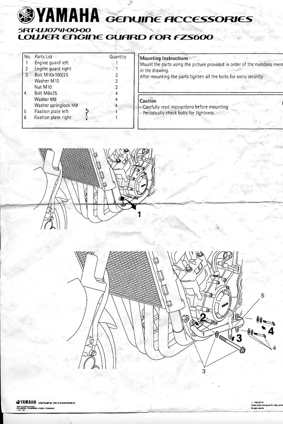

Quote:I managed to drag nylon bungs twice when leaning a lot,Yep I had that a couple of times -with the bars but was mostly due to a steep camber in the road. I got mine from a private ebay seller (not a shop) here is the fitting instructions with product code.

(29-10-13, 04:37 PM)fazersharp link Wrote:They dont - not rearly as I said ive done it twice and it was big lean that anyother time would not matter as it was mainly down to the road camber if you look at my picture you can see the marks. If your tyres have chicken strips then dont worry as the bars will never touch down After all my searching I only found ugly overpriced bars. 5 minutes with that part number and I've ordered the same bars from a little Shop in Germany! Just waiting to see if they actually arrive. :\ Cheers.
