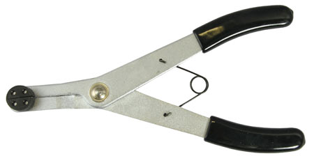

I use a compressor with a blow gun with a section of rubber tube on the nozzle to form a seal but if that fails I use one of these:
[Image: piston%20removal%20tool.jpg]
You can take one side out, clean the stuff in there, put them back in and then pop the other side and clean under there.
Or, if you use clamps to get both sides of the piston near the middle, then you can usually get one side out then just jiggle the other side with your fingers to get all out at once. If they are very stiff then that won't work.

(25-10-11, 08:16 AM)Deefer666 link Wrote:I use a compressor with a blow gun with a section of rubber tube on the nozzle to form a seal but if that fails I use one of these:
I used a pair of these and they were great until I got to the seized pots. Don't be tempted to do what I did and use mole grips, they make a right mess of the caliper pots. Looking back I should have pushed the pots out as far as possible using clamps and wood before I took the caliper off the brake line (was replacing them at the time). I don't know if they're cheap/common but conventional pliers with gripping faces made of a softer metal might help if this happens to you.

Excuse me for being thick but what are these? they look like some sort of reverse pliers that whould clamp on the inside of the piston.............if i am right where would i get something like this?

Could have done with a pair of those today... in the end a set of circlip pliers did the job (just).
Toolbox.co.uk have a nice looking pair made by Sealey for £16.35, cheaper Draper ones are also listed.
ooooooook pliers ordered, planning on clamping the brake pipe when they come and taking the caliper to pieces on my work bench
as the pistons aren't seized i guess they will come out ok with the pliers, going to repeat that on the otherside once that is done
