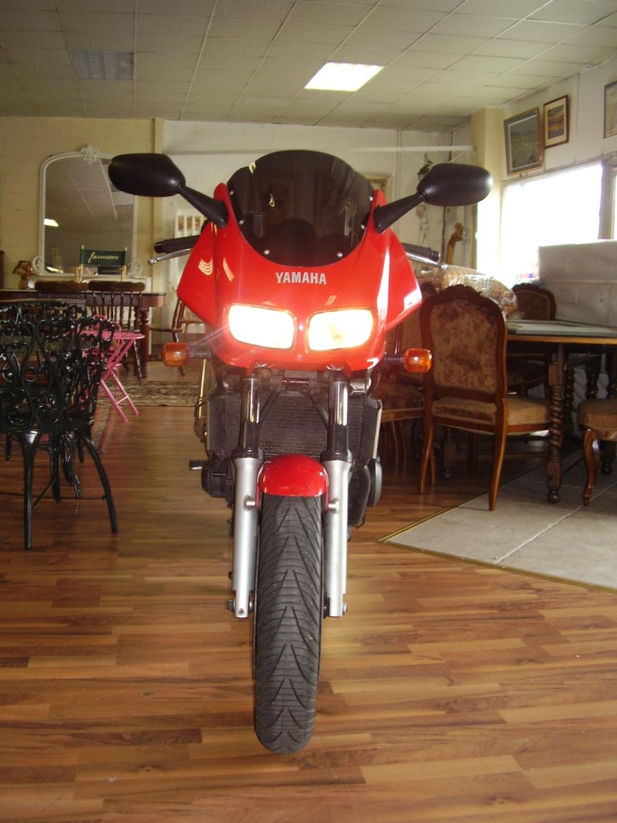

For whatever reason the offside light on the Fazer only comes on when it’s on main beam (although it has a H4 dual filament bulb fitted).
This leaves only the nearside (single filament H1 bulb) for dipped beam. Lighting levels are crap in dipped and it also looks weird with only one light on.
Whilst stopped at some traffic lights recently this bloke standing at the adjacent bus stop hollered over that only one of my lights was working - yeah, its supposed to be like that!
So lets have both lamps on in dipped and see and be seen better.
These instructions are basically those on the FOC-U (Fazer Owners Club - Unofficial) messageboard but with accompanying pictures and my own commentary.

[smg id=247[/img]
I eventually (in the process of replacing the fairing) routed the wire with the existing loom as a proper job:

[smg id=247[/img]
