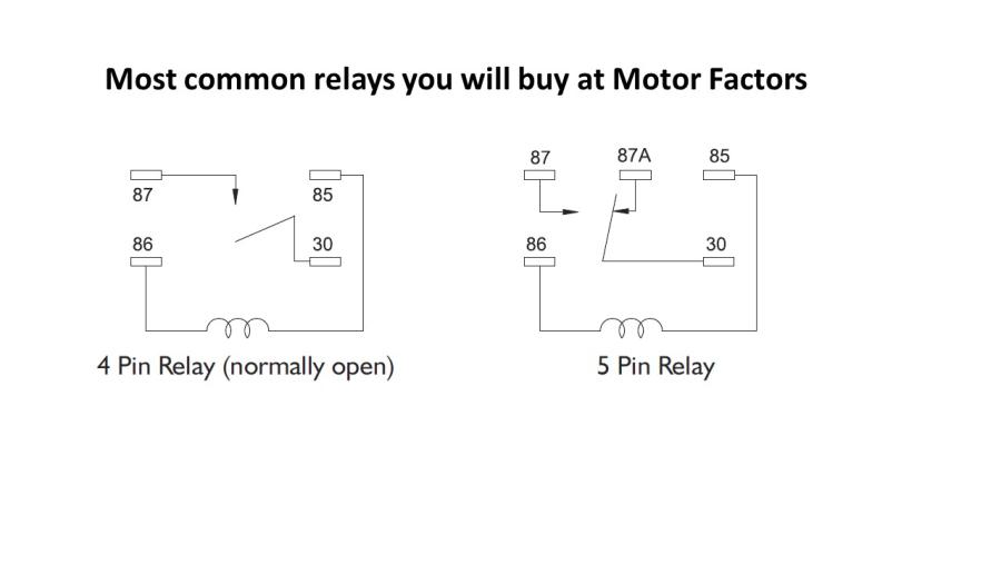

Ok. obviously rewired with minimal wiring. Look at the underside of the relays and put the numbers to the relevant wires on your diagram and I will show you how it works on your diagram
Attached is a picture of the two most common relays you will get at the Motor Factors with the inner workings shown

both are the the 5 pin relays 12v 30/40A
Ive updated the drawing with numbers, the middle pins are not used
