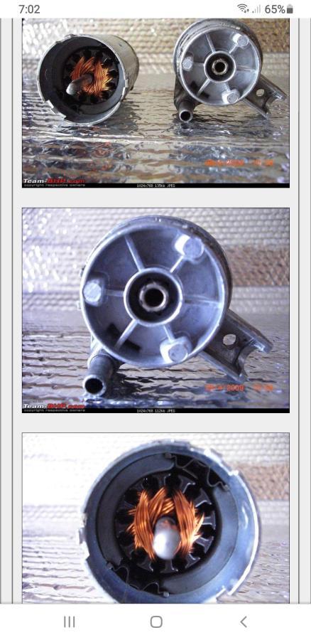

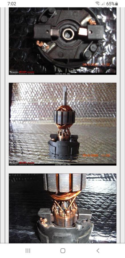

The person who took these photos quite clearly advises "Don't take this apart, you will break something."
He also says just to put a few drops of oil in the intake hole, which is a sealed unit.
So glad I found these photos, what's inside the unit is nothing like I imagined at all.

I ended up doing what I said I would.
After learning that the top section was a sealed unit, where the air intake and outlet is, I sprayed brake cleaner in it and used compressed air to blow the excess out and a load of black shit came out.
Couple more sprays and the liquid became clean.
Then i just poured some 3-in-1 Oil into the air intake hole and swirled it about a bit then blew out the excess again.
And it worked.
I put it back on the bike as I prefer the noise to the other one and the horn sound is all crisp and loud again plus very responsive on the horn button.
Job's a good'un  :woot

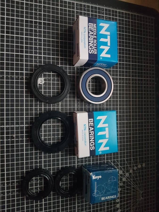

Bought a bunch of wheel bearing for the bike to get done on the next tyre or c&s change.

Are those OEM? How much does a full set cost? I still need to get my wheels repowdercoated so will be looking for a full set in the spring
Bike Bearings UK, also known as Marksman Ind, are your best bet. He sells bearing kits for specific bikes. From memory the lot, front, rear and sprocket carrier came to around £50 this time last year for my Gen 1.
