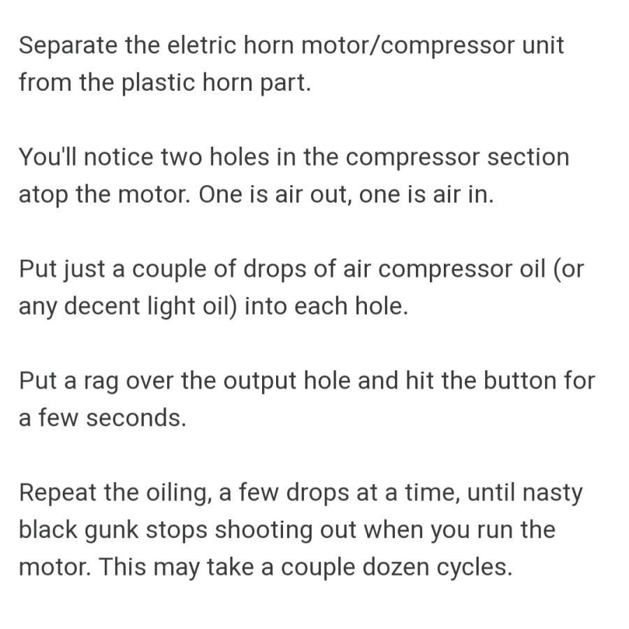

I since found an article saying that the compressor part on the Stebel horn may just need a few drops of oil to get it functioning correctly so i might have a look in a bit, plus the 2 main wires that power it are very easily accessible on my bike to test it out again.

This is what I found....

(13-12-20, 11:18 AM)b1k3rdude link Wrote: [quote author=darrsi link=topic=6412.msg322061#msg322061 date=1607853393]I since found an article saying that the compressor part on the Stebel horn may just need a few drops of oil to get it functioning correctly so i might have a look in a bit, plus the 2 main wires that power it are very easily accessible on my bike to test it out again.
Yeah but how do you get it apart, arent they sealed units..? I asl because I have the same thing on my Bandit and may have to do this work.
Think I'm gonna have to give this idea a miss.
I tried separating the plastic horn part from the compressor but it seems like it has been put together in a way so that it doesn't come apart easy at all.
If it wasn't working well at all I might use a bit more brute force, but because it is working I don't particularly want to break it while dismantling it.
It does feel like there could be a seal as well where it joins.
Just saw a bloke on YouTube separating the compressor from the plastic horn very easily using a screwdriver for leverage so it can be done.
Be careful not to break the plastic clip holding it all in place though.
I'm in no hurry at all to do this though due to my new replacement horn so I might give it a go over the Xmas holidays now as I need the bike as a power source to test it out.

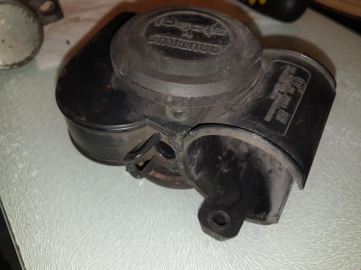

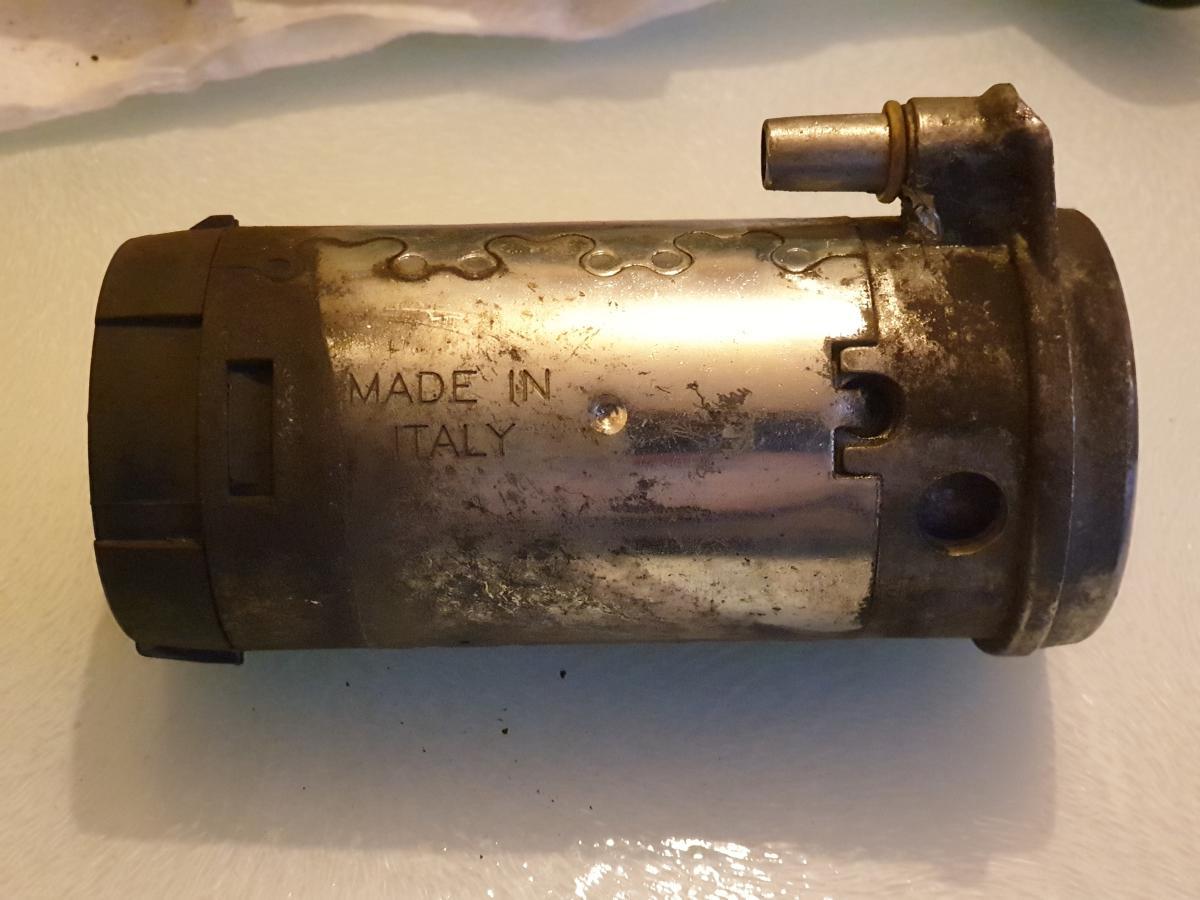

(13-12-20, 11:50 AM)darrsi link Wrote: This is what I found....
Stebel Nautilus Compact Air horn maintenance (from previous conversation above)
The hole towards the right in the photo is the air intake, and the pipe at the top is air out.
I haven't done it yet but I'll try brake cleaner first, then either WD40 or oil and keep blipping the horn to get the parts moving inside and lubed.
Be aware, when you prise the horn upwards you need to release the little round part of the plastic horn from the air intake beforehand.
