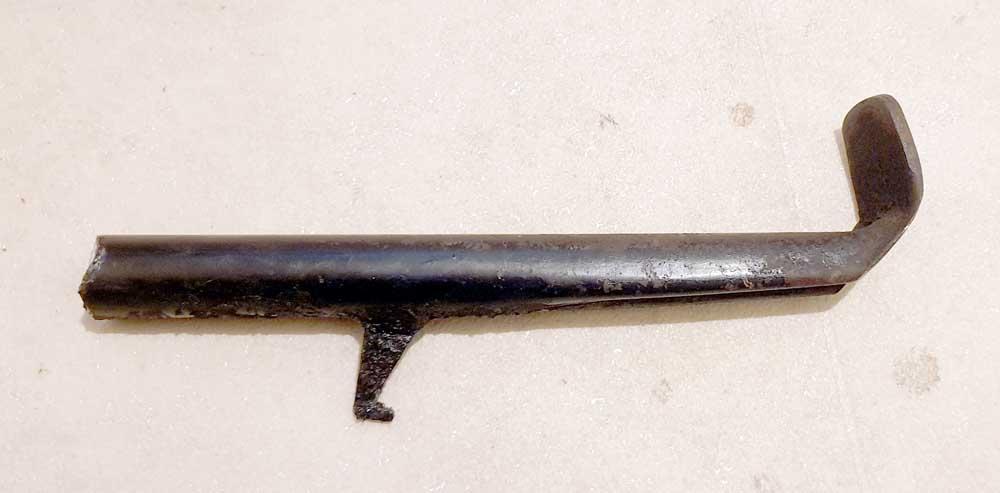

(08-07-20, 09:34 AM)Gnasher link Wrote: Glad you're okay, but what happened to the side stand, did it break or something?
The metal looks like it's just sheared away (see the pic).
It's only a hollow tube, so if it's under compression with the weight going "down" the tube, it's strong enough, but the only thing I can think of is that, because the road has quite a steep camber and I parked the bike with the back wheel towards the kerb, the pressure on the stand was pushing it "forwards" rather than the bike just leaning against it to the side.
I presume that it's weakened over the years (2006 registration) and this was just enough to push it to the breaking point Sad
ADDENDUM: It's just occurred to me that, of course, I've been using it to jog the starter (or whatever was causing the "doesn't want to start" problem) by putting it down and then "flicking" it back up to send a jolt through the starter/ engine/ switches/ whatever and that probably didn't help...
That's the first time I've seen or heard of a side stand snapping, blimey.  Even i when left down or crashed the bend, there's no real side or share weight on them in operation it's all pretty much straight down force, very odd.
It's very possible whatever's caused this to fracture has damaged the side stand switch and would go a long way to explaining your past problems with the switch.
I quick fix is to get it welded until you can get hold of a replacement, that said if it's welded correctly, bit of grinding and a paint it'll be good as new.

(08-07-20, 10:33 AM)Grahamm link Wrote: [quote author=Gnasher link=topic=6412.msg317587#msg317587 date=1594197251]
I wonder if the bikes been lowered at the rear in the past. The owner would have shortened the stand to suit the new height, is it a welded joint thats failed?
Could be mate, you do get owners doing very strange things to their bike  :rolleyes

(08-07-20, 11:03 AM)Gnasher link Wrote: That's the first time I've seen or heard of a side stand snapping, blimey.  Even i when left down or crashed the bend, there's no real side or share weight on them in operation it's all pretty much straight down force, very odd.
As I mentioned, the road has a pretty steep camber, so it's possible that the bike rolled back a bit because the rear tyre wasn't against the kerb and the "foot" didn't slide, so it's like bending a tube in the middle where it's weakest Sad
Quote:It's very possible whatever's caused this to fracture has damaged the side stand switch and would go a long way to explaining your past problems with the switch.
I had tested the switch with a multimeter and it seemed to be fine, giving the correct zero resistance/ infinite resistance responses, but you've made me think...
I was worried that the "auto kill" would cut in when I put the bike into gear as it was still running and in neutral when the stand collapsed and I didn't switch it off.
I was thinking that I'd have to push it all the way back around the other side of the block to get to the alleyway where my shed is, but it kept running (fortunately)!
But I've just had a look at the side stand switch and it's not pushed in, because, obviously, there's no stand to push it in, yet it must have been like that after the stand broke.
Luckily, though, I've bought a new (second hand) stand *with* the switch, so I'll just change over the whole unit.
(08-07-20, 01:11 PM)agricola link Wrote: I wonder if the bikes been lowered at the rear in the past. The owner would have shortened the stand to suit the new height, is it a welded joint thats failed?
Lol, nope! I was the one who was thinking of getting it lowered. I actually had bought a lowering link in the past, but in the end never used it.
As for welding the stand, the sensible thing to do would be to cut the "foot" off, shorten the "leg", then weld the foot back on, so, even if it breaks off, there's still something there to support the bike.
