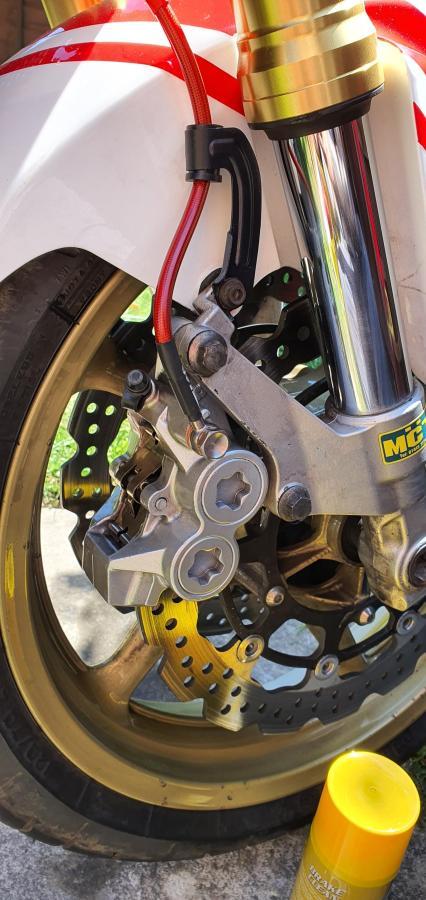

Stripped and serviced the front brakes. New seals, bleed nipples and slider pins, cleaned and polished the pistons, repainted the calipers and installed new red braided lines ?
Took a good few hours but has been a lovely morning out in the sun, although the installation was aided by a few cold ciders so no test riding u til tomorrow haha

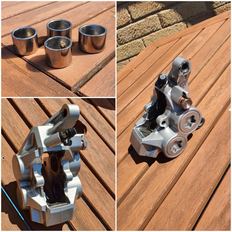

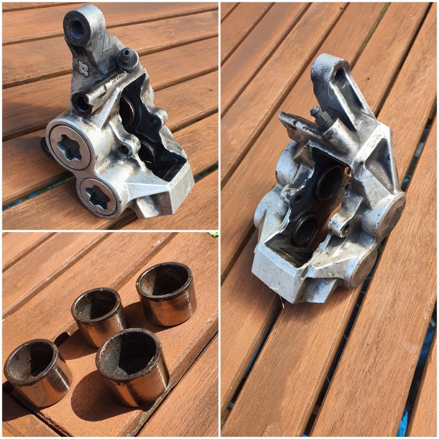

Added some before and after pics for anyone who's interested
Looks very  8)

(25-05-20, 03:17 PM)Gnasher link Wrote: Looks very  8)
Cheers. Still need to do the fork lowers though ?
Feels good doesn't it when you have taken the time and care and do e a good job. Ciders deserved
(25-05-20, 06:08 PM)fazersharp link Wrote: Feels good doesn't it when you have taken the time and care and do e a good job. Ciders deserved

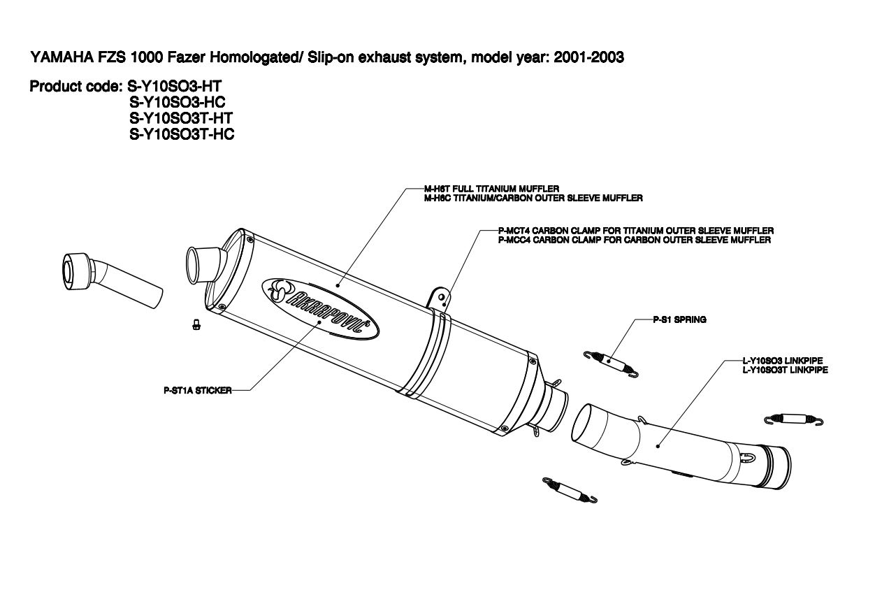

Titanium Muffler Fitted  Smile
It is 4Kg lighter than the original :eek
Undecided whether to put on the sticker or not :rolleyes
To misty to take it for a spin now, will have to wait until morning to see the difference Sad
(25-05-20, 09:08 PM)unfazed link Wrote: Titanium Muffler Fitted  Smile

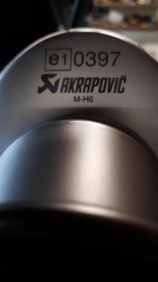

If that a genuine akra? I thought the logo was riveted?
Yes, it was a sticker on it. There was another sticker  in the box. I took off the original. I think I will leave it off for now. Not that easy to get it off either
