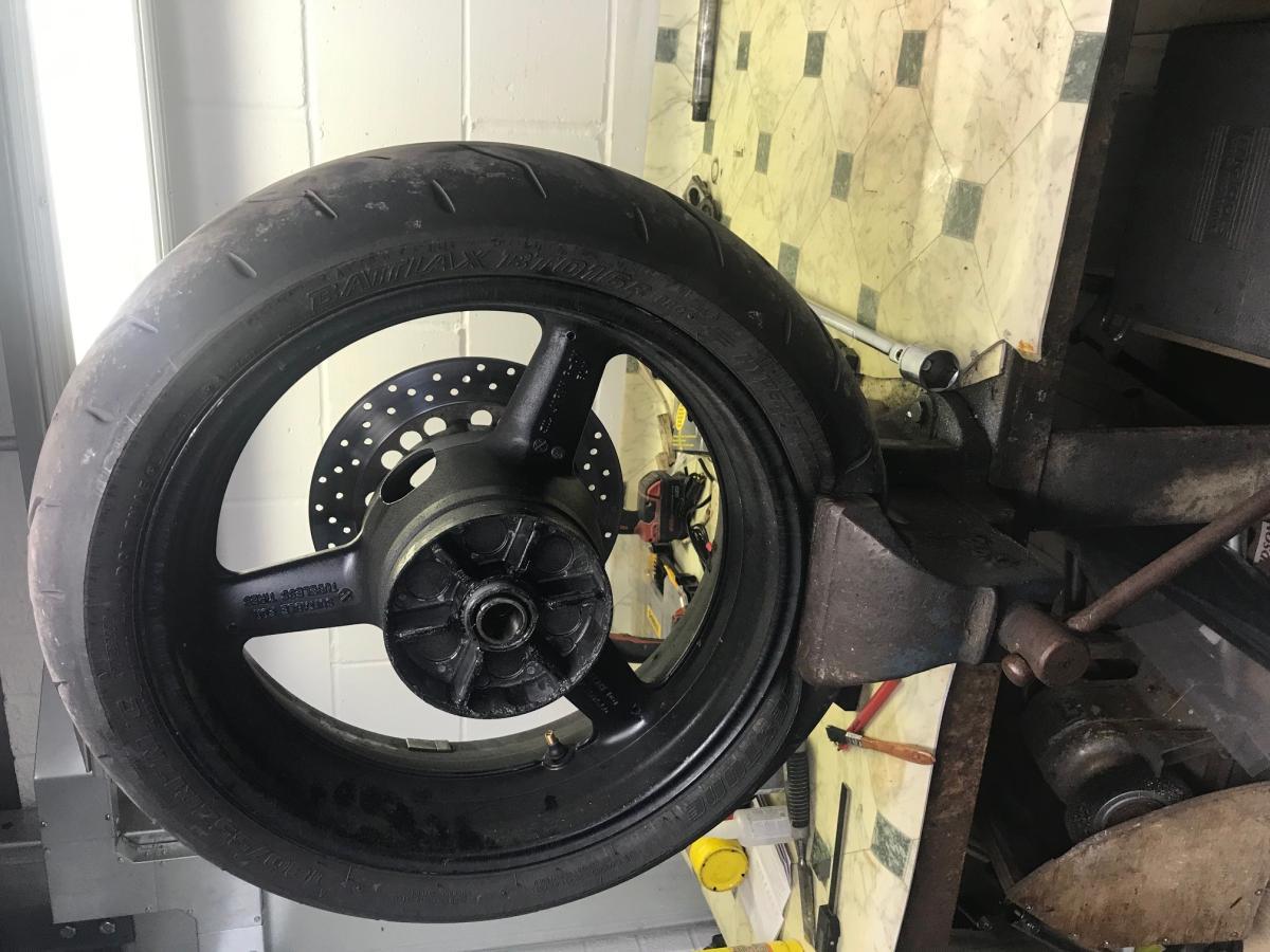

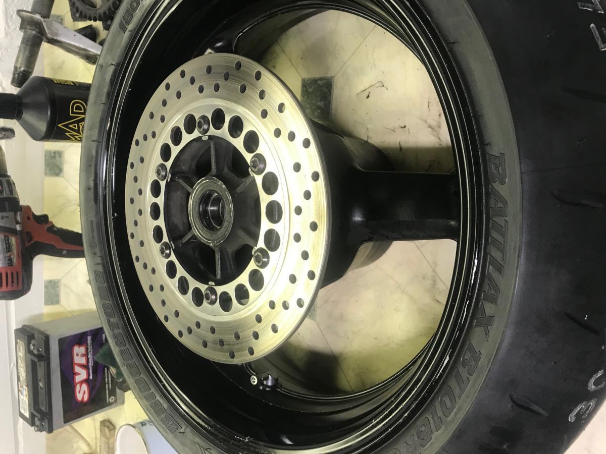

a while back I bought a new set of 016s, and promptly fitted the front, along with a triumph 90 degree valve. Then just as I was about to fit the rear, I hadta go to manchester, about a 500 mile round trip, mostly motorways so I left the old rear on. then I had to go to Newcastle. Again didn't want to square me new bridgestone so I left the old one on. another 500 mile round trip and I thought 'better get that new rear on'. that was about a month ago, done a few miles since and it will want mot'ing soon so I thought' right, I REALLY better change that tyre' :lol
Wanted to use the opportunity to fit an angled valve too. and check the rear pads, and tidy it all up....

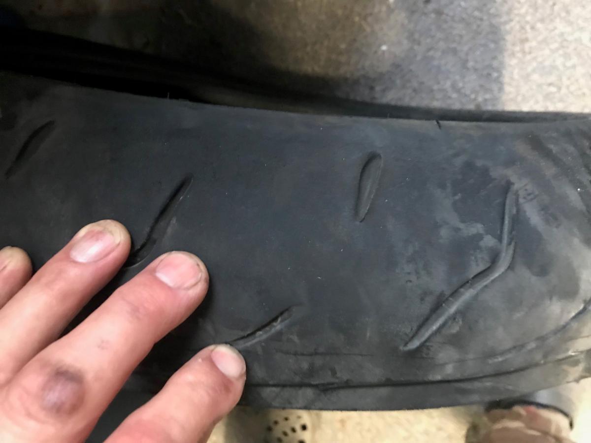

Anyhoo, I cut the old tyre in half just before I removed it, partly to make it easier to get the bead in the middle of the well when levering it off, and partly to see just how thin they get when you dick around and dont change them when you should. the answer is very... :lol disc rotor screws were a bit of a bitch to say the least.

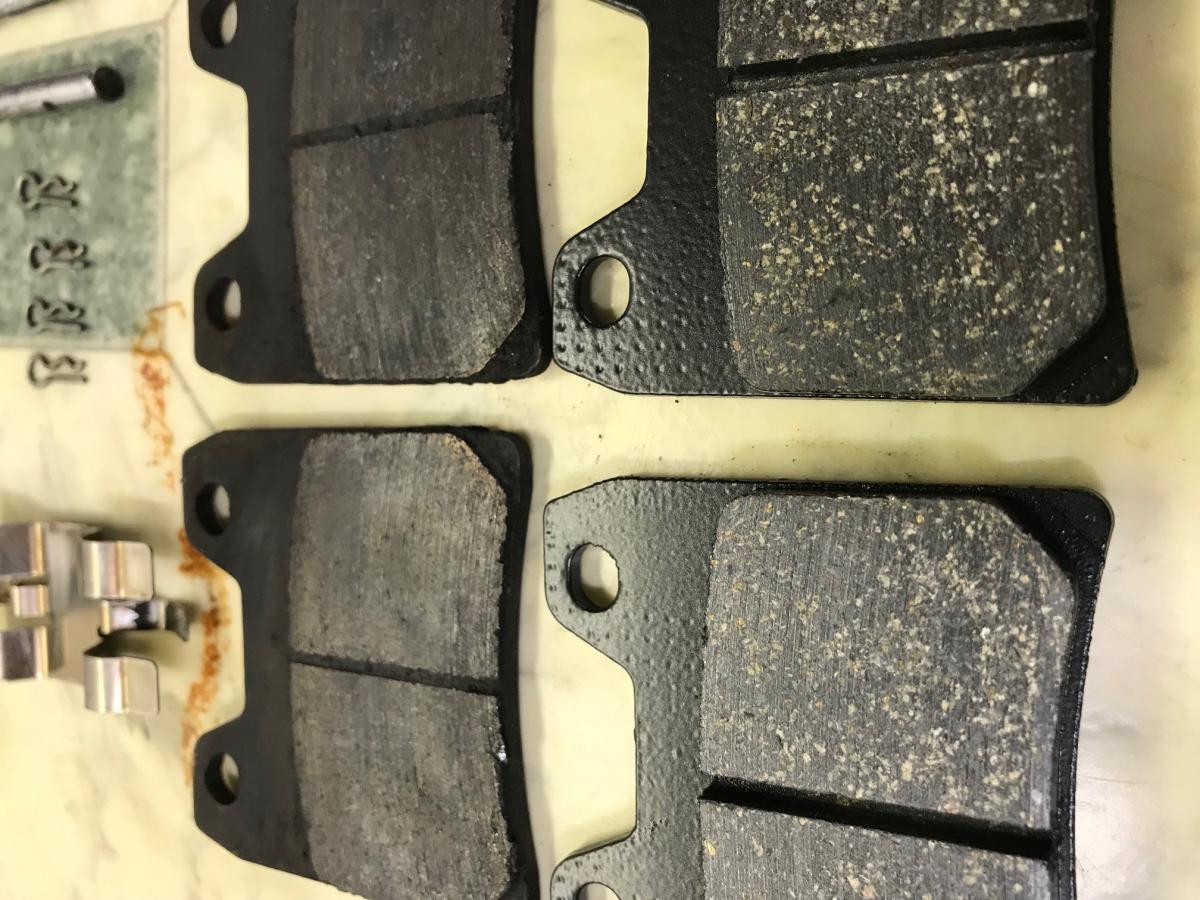

so. fitted the valve and the new tyre, then took the rear caliper off. it was pretty shitty, and the pads had 1mm left! only the second time I can remember having to change a set of rears, I guess nowadays I use the back brake as well as the front  :o :o
cleaned up the rusty disc rotor bolts and caliper/torque arm bolts then heat/oil blacked them to stop it happening again. Used the 20/50 mineral oil I put in the harley coz it smells nice when its burning... Wink
paint was peeling on the disc rotor but they are stainless, so wire brushed it all up and bolted it back together with me newly treated screws. looked 'andsome, especially with the angled valve. shoulda done that three years ago...
cleaned up everything else ready for assembly. new EBCs were a lot thicker than the old uns :eek

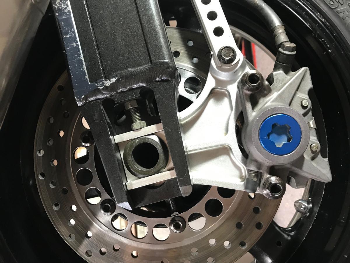

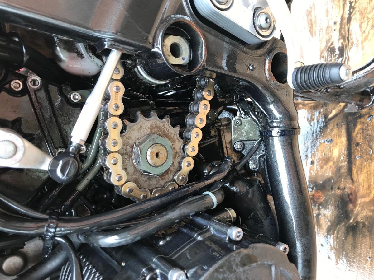

wheel back in an caliper assembled and fitted with treated bolts. looks a helluva lot better. Degreased around the sprocket before cleaning her up completely. For 44k and fifteen years shes wearing well. I foccing love this bike...
