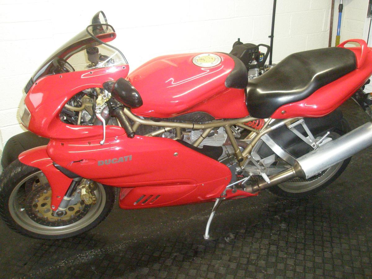

This is my latest project.....Now ready for mot

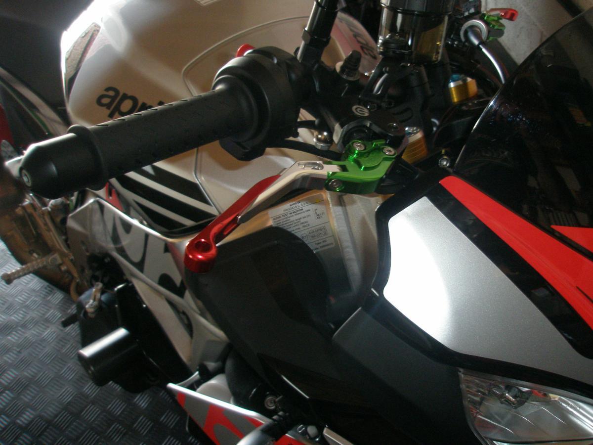

I fitted new mirrors and levers to my tuono Smile

(19-09-18, 08:21 PM)nickodemon link Wrote: This is my latest project.....Now ready for mot
From the twin discs I'd guess it's a 900 (rather than a 750) - love those  Smile Smile
(19-09-18, 08:29 PM)nickodemon link Wrote: I fitted new mirrors and levers to my tuono Smile
Lovely levers, where did you get them ?

Yes it's the 900.... I'm selling it soon... The levers were from -
https://www.ebay.co.uk/itm/CNC-Extending...Sw7GRZJWRM
