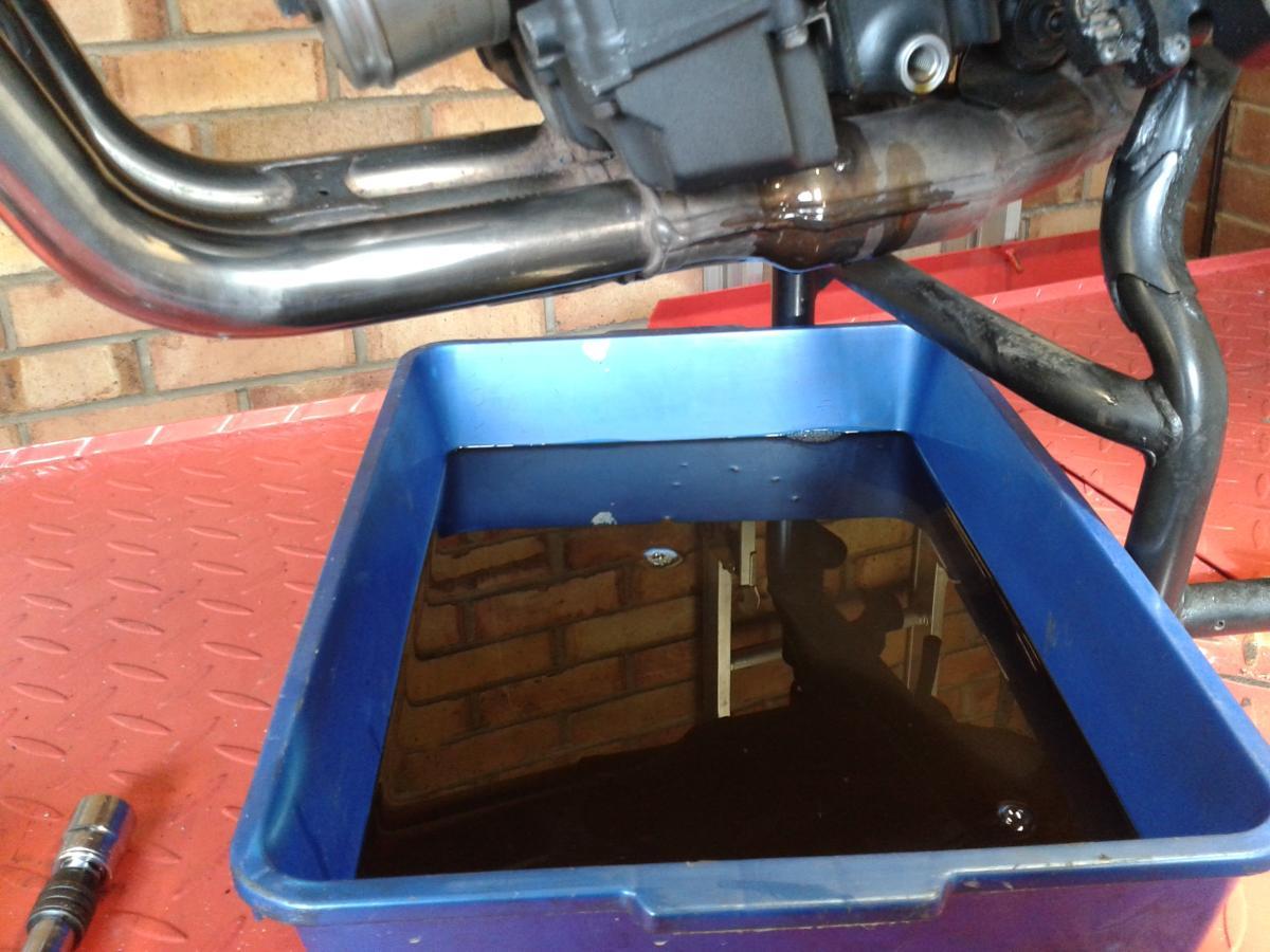

Oil and filter change. Trackday coming at the end of the month, plus I want to get 4 or 5 more in this year too. Scorpion exhaust system to fit still when it arrives. Was going to wash the bike this afternoon, but turned a bit showery

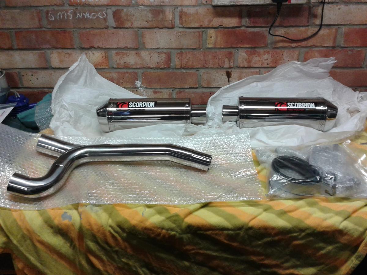

Well, I made a start. Its out of the box

Woooo! a couple of real BAD boys  :lol

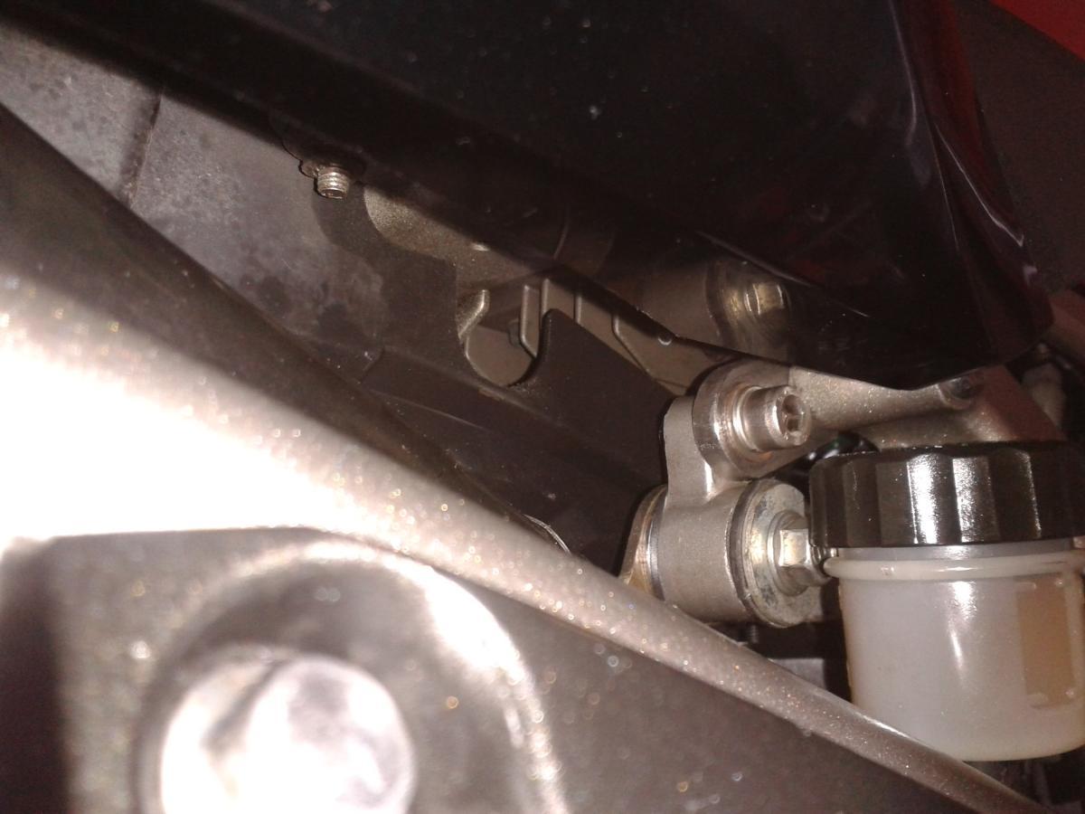

Okay. You can see the bracket I hd to make to marry up the decat pipe to the fixing point. Piece of 6mmx25mm plate, nicely radiused, 2 holes 25mm centres, one tapped M8 and the other 8mm clearance, just behind the fluid pot

Cool, cheers for the pics, looks like you have done a neat job on the fixing bracket + love the colour of the bike,  :thumbup

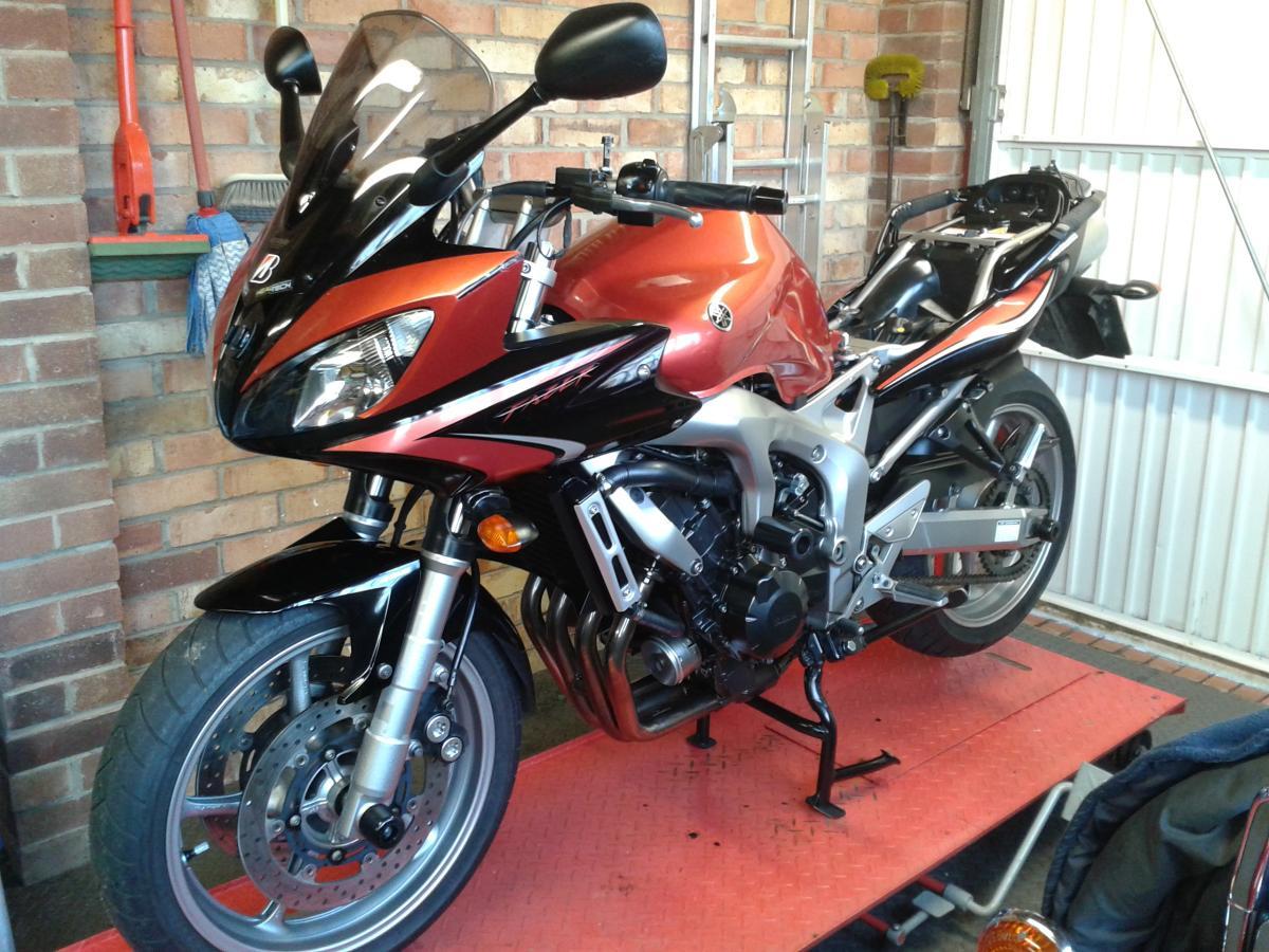

Hi Agricola,
What tyres do you have on the bike? The back one looks quite low profile or is it just the angle the photo was taken from.
