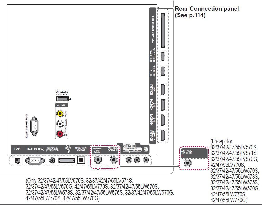

(06-01-18, 09:22 PM)fazersharp link Wrote: This is how the tv is saying to connect component --- again it is showing RCA?phono to the tv but the connection plug is a 3.5 jack
Still strange to me, that is a blatant photo of a phono/RCA connector?

User Manual for the LG 55LW550T here:
http://www.lg.com/uk/support/support-pro...g-55LW550T
From the manual there seems to be some ambiguity between the input connections (page12) and the input selection options using the remote control (page 43).
The TV has AV1, AV2, and AV3 connections and a single component connection, but the menu shows only AV1 and AV2 but Component 1 and Component 2.
(the AV signals are, composite video, left audio, right audio, and screen [earth])
Is this what you find in practice? If so, what input selection did you make when testing the composite jack input?

#69
Although page 12 the manual shows the bottom section of inputs facing to the back they are infact pointing down like this the picture from the manaual below is what I have on my tv
[Image: index.php?action=dlattach;topic=23629.0;...1359;image]
#70
This close up of the manual shows the AV 3 input in question and tells me it is aduid/ video and if you follow the arrow around it points to the socket I am using.

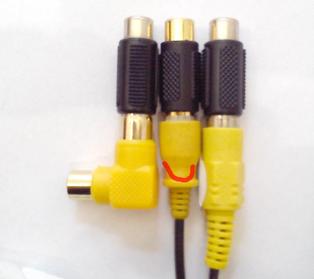

#79
Here is some comparison pictures of a standard straight and 90 degree and the one I am actually using and still hits the tv mount I have plugged them into adapters to reproduce them being plugged into to tv socket so you can see side by side.
Yes shortest is the 90 degree but the one I am using is the middle one and I have paired back as much plastic as I dare down to the red mark and as that you can see that it is a lot shorter than a 90 degree adapter. Also the 90 degree adapter has quite a big and solid square block and the one I have paired down is to a thin point
#80
The final solution then will be to get a new tv bracket that gives more space for cables behind the TV :pokefun
