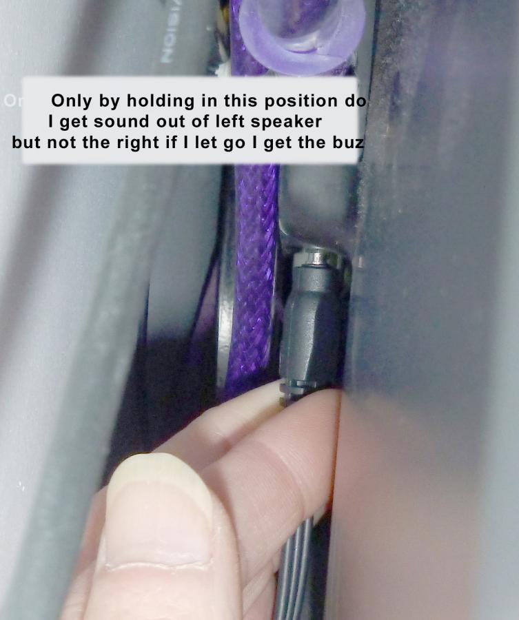

Some pictures with captions

Not helpful I know, but i think you need to cut your thumb nail!

Picture from underneath showing the original problem of the AV2 plugs hitting the tv mount and apart from that it is in practical to take the tv off the wall to plug them in even as a temporary measure leaving them bouncing on the tv mount. I hook for the tv mount is on the top so the tv is hinged at the top and pushing down on the plugs and the tv is slightly tilted up because of it.

But if you look the bottom section nearest the black plastic of that ebay one is longer than the one I am using this picture
