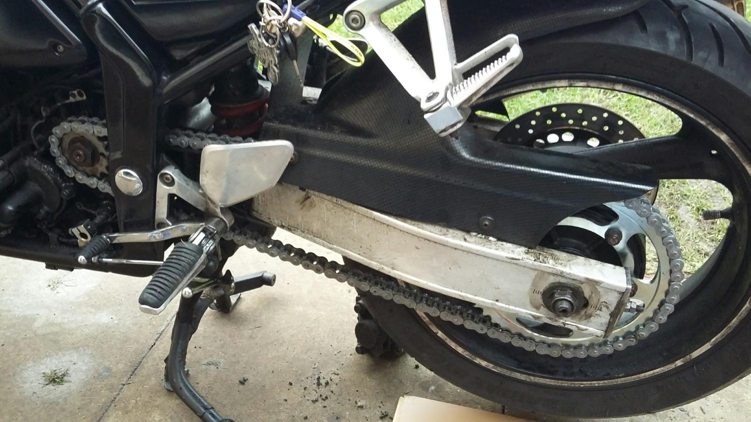

I've fitted new chain and sprockets to the old girl and I'm going to take her for a spin this afternoon  Smile
I can't complain, almost 40k on the original chain. Unfortunately I never managed to get hold of a 12mm front sprocket nut so i'm running on the original nut.
It's defo on my to do list. . .

(08-01-17, 11:50 AM)celticdog link Wrote: I've fitted new chain and sprockets to the old girl and I'm going to take her for a spin this afternoon  Smile
Just done my chain & sprockets and with the 12mm nut. I got the nut from wemoto.com http://www.wemoto.com/bikes/yamaha/fzs_6...t_kit_oem/ it takes a few days as they state that it's not a stock item and they have to order it in but I ordered it on the Saturday it was processed on the Monday morning and delivered Wednesday.
