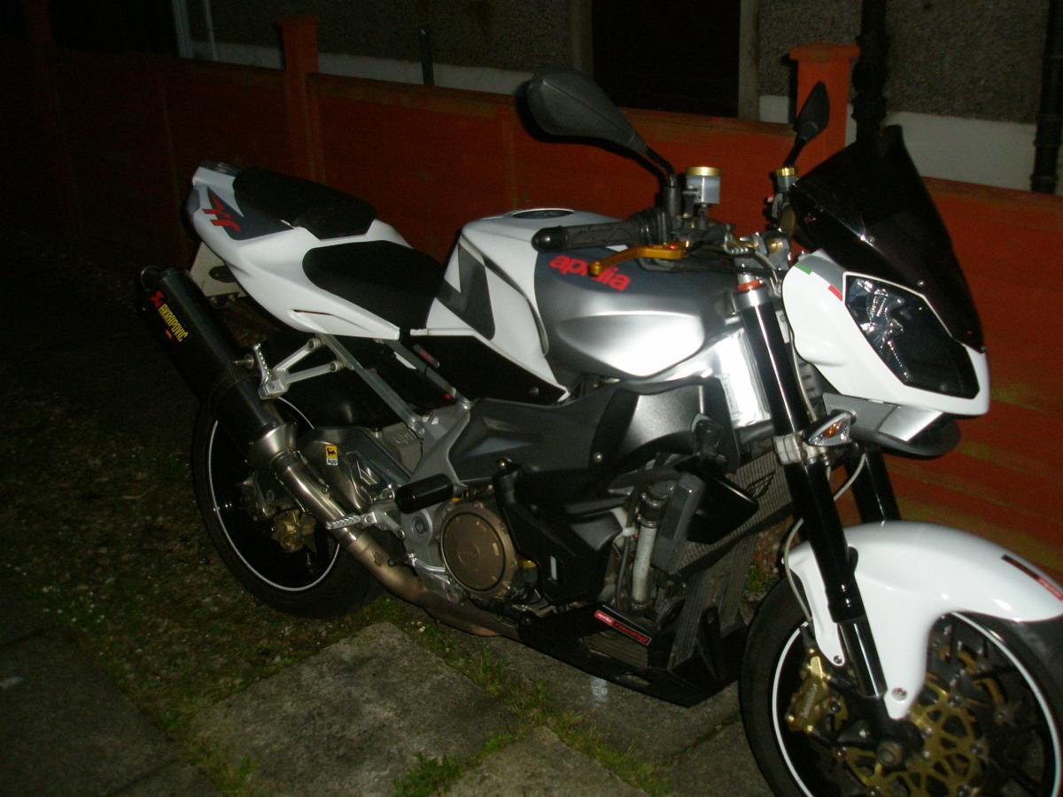

Bought this :lol
:eek ha ha good on ya nickodemon ,,better pics when your ready please,,was out on my tuono today with a few lads and am really after fallen for it very confidence inspiring,,went down to schull in west cork
He he.. Did i not sell you my mint gen 1 fazer front end? Utterly brilliant bike with loads of character. Only two bikes i will always keep are tuono v4 and gen 1 fazer Smile
Ha ha yes you did .at a time when i needed it most too  :lol
Ill never sell the fazer and this tuono certainly feels like a keeper too .so so much fun .but for everyday mile munching/touring the fazer is the one .
You are right about both bikes... Both outstanding at what they are best at Smile
