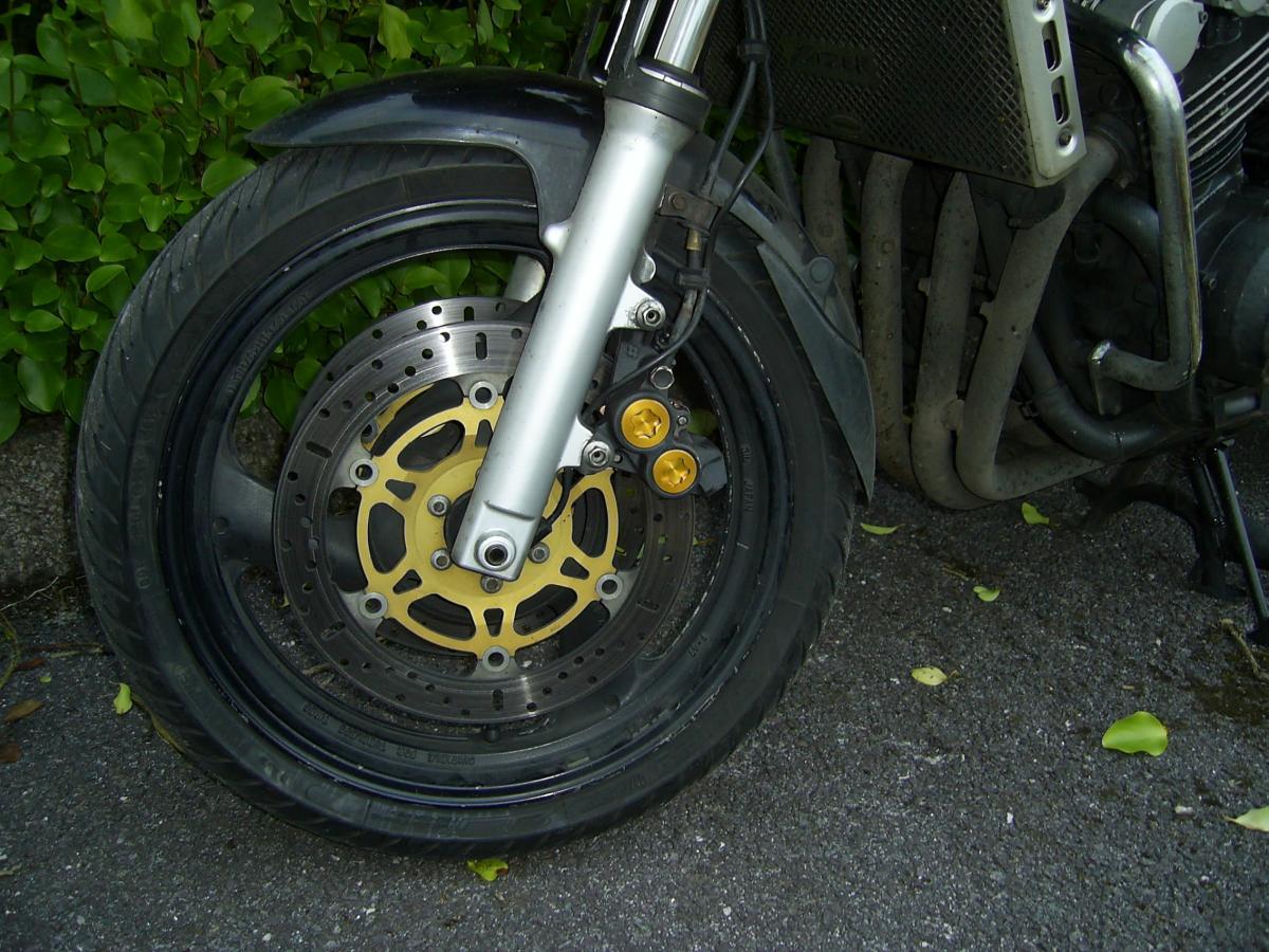

(08-09-13, 11:06 PM)unfazed link Wrote: Replaced my front Blue Spots with a set of 2003 R1 Gold Spots.
Will post a picture when I get to take it out of the garage, started raining as I was finishing up and did not get a chance to take it for a spin. They look good on the Fazer
The pistons are black and look like a teflon coating just like the Fazer 400 Brembos. They are supposed to be the best of the bunch before they changed to radial ones

A direct replacement, only extra was 4 copper washers for the banjo bolts on the calipers. They even take the same brake pads. The longest part of the job was bleeding the brakes afterwards
I got them on ebay from Germany for £120 incl postage. I was looking for about a month, but they seem come up regularly enough. They are from the 2002/2003 R1. There were plenty of them available in the US at the time.
(08-09-13, 11:59 PM)unfazed link Wrote: A direct replacement, only extra was 4 copper washers for the banjo bolts on the calipers. They even take the same brake pads. The longest part of the job was bleeding the brakes afterwards
how are they different to the OEM "Blue spot" calipers? is it just the colour, or are the pistons etc a different size?
The major difference I could see was the pistons and the only cosmetic difference is the colour.

First trip with these on today. Strangely enough these give more feel than the Blue Spot did with the stainless brake lines. Big Grin
