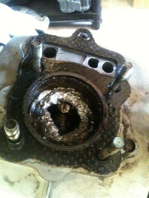

Holy crap, I'm not sure what I'm seeing. Has the piston *melted*?
Yep, piston has a big hole melted in it. Exhaust valve has also melted and the end of the plug is too. We took the exhausts off to load it onto the trailer and they rattled - turned them over and bits of metal fell out :lol
Jees :eek following on from breadlords comments, the damage looks horrendous, would it of been repairable ? i.e. source a new piston and valves etc or would the engine be totally fubar'd and the only economical solution to buy a complete new engine? mainly curious as i've have never stripped an engine down to this extent. Also what would of caused such an extreme failure? cheap parts, no oil, thrashing the balls off of it? I had many years ago a honda cg125 and the engine was bullet proof and outlasted the chassis and frame easily.

Not sure on the condition of the bore but I'd guess the block was scrap. Head was definitely scrap. Sump will have been full of bits of piston so that may well have screwed the gearbox and clutch... It's possible that it would've been fixable but would've cost more than it was worth. Bloke that bought it had a spare engine lying about so is going to fit that and then possibly sell it on.
As for the cause of failure, possible overheating caused by oil pump failure, possibly just not up to the job of 40+ minutes flat out down the A12 twice a day...
Oil pumps have a pretty easy life so long as there's something there for them to pump.
This looks more typical of a dropped valve: either metal fatigue causes the head of the valve to drop off or over-revving gives the retaining collets at the top of the stem the chance to jump out.
Collets were still there - cam cover came off first and the top end all looked ok until the head came off...
Maybe the valve has stuck or something and got a smack from the piston, it was going flat out at the time for a while although I don't know what revs as the rev counter didn't work...
i would say the engine dropped a valve,that would cause the damage shown,it is a shame as the engine is based on a honda cg125,where that was generaly bullet proof the chinese used inferior quality materials,some chinese bikes are ok but most are a waste of money

I'd say valve dropped and meltdown. I've never seen a valve smash a hole in a piston crown like that before, at least not on a 125. Probabley a combination of a few things. Valve, melt down (maybe very lean mixture), and maybe screaming the granny out of it. The valve has obviously bounced about in the top of the pot for quite a few engine revolutions before making its escape.
