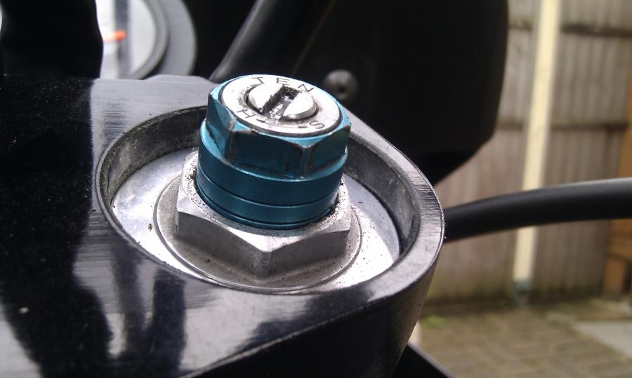

This pic shows how my forks have been since I purchased the bike but I have no reference to know what the fork height should look like as standard.
Have they already been dropped? If so, any guesses as to how much?
If they haven't.... where do I take the "drop by 10mm" measurement from?

Hi,
No, they haven't been dropped. I took the measurement from the point in your picture, raised the forks 10mm measured from the top yolk to the indented ring on the fork (both sides!)
(this drops the bike down a bit, think you've got a bit confused by the terminology of dropping the forks - They actually stay in the same place!!)
Hope that helps Smile

(19-05-12, 12:59 PM)tomjimtom link Wrote: think you've got a bit confused by the terminology of dropping the forks - They actually stay in the same place!!)
I know they stay in the same place :rolleyes
My understanding is that dropping or raising relates to how much fork top shows through the top of the yolks.
If the fork clamps were loosened and front of the bike was supported securely by a jack and  raised, this would mean less fork top was showing above the yolk (dropped)
Conversely, if the front was lowered on the jack, more of the fork tops would be showing (raised).
Or am I a mile out here?

As you say if the jack was lowered the forks would raise through the yokes this is classed as" dropping the front forks". the terminology is a bit confusing all it means is you drop the front end of the bike suppose it should be called "dropping the yolks" There you go clear as mud Wink  doing this though does give a better feel to the front end & helps you keep a tighter line

mine were dropped 20mm (with no preload) or thereabouts but i was running hard springs so the chance of radiator/mudguard interface were low.

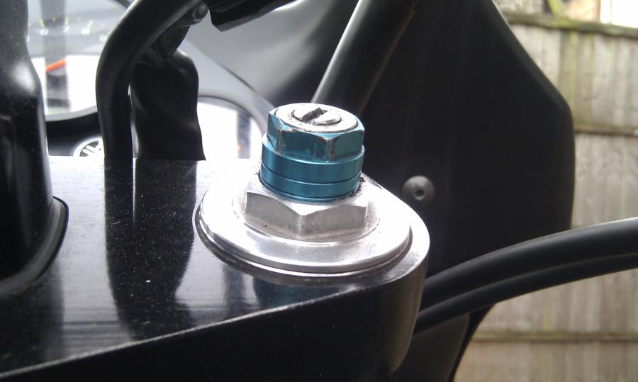

Is what I've done in this picture an option? (I have and will not ride it like this until I know it is safe).
I loosened the pinch bolts, jacked up the front and the forks dropped 10mm, (as near as but no more) DOWN through the yolks.
The front is now more raised and feels more suited for me.

You have raised the front end by lowering the forks through the yokes.  This is the complete opposite to what virtually every other Gen 1 Fazer owner has done but if that's what you want ...
By doing this you are moving the C of G even further back that normal.  The standard weight distribution already puts more weight to the rear than is ideal for good steering feel.
I fear you'll end up with the front feeling even more vague and the additional weight shift to the already weak rear shock isn't going to help that end, either.
Finally, having only half the fork leg clamped tightly in the top yoke is questionable from a safety perspective.

As I said, I wouldn't ride it like this without qualified feedback.
I was just trying to paint a picture as to whether, "does this look right?" or "how about this?"

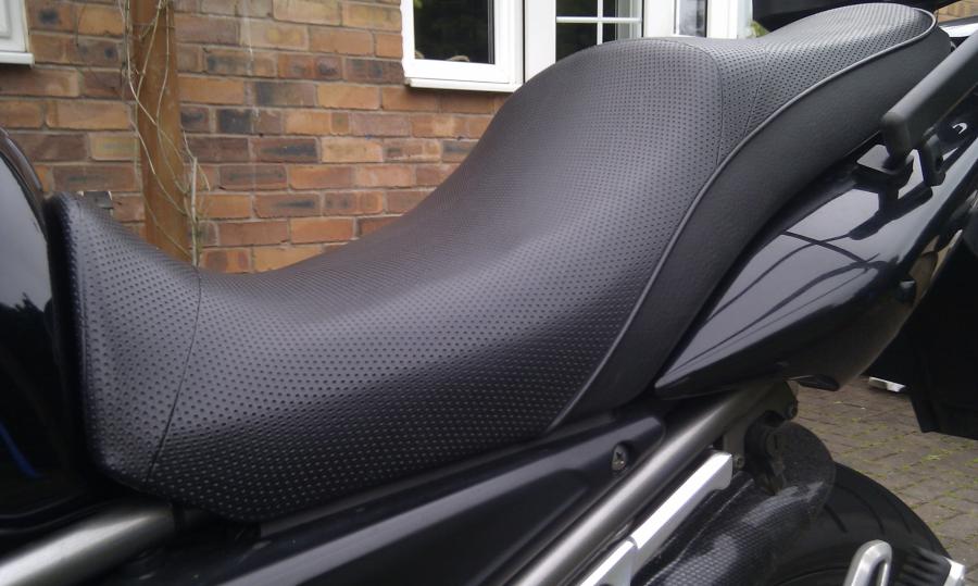

That said, there is one factor to ride height that I've completely overlooked (and thankfully I'm not alone)..... the seat.
Just looked at some old pics of my previous bike and I think the seat was in better shape, literally and possibly not as squashed as my current one.
First pic is my current seat, second, slightly grainier pic is my old seat. Any thoughts?

Could be camera angle but it looks to me like your current seat has been under the knife.
have you grown since your last gen 1  :lol
