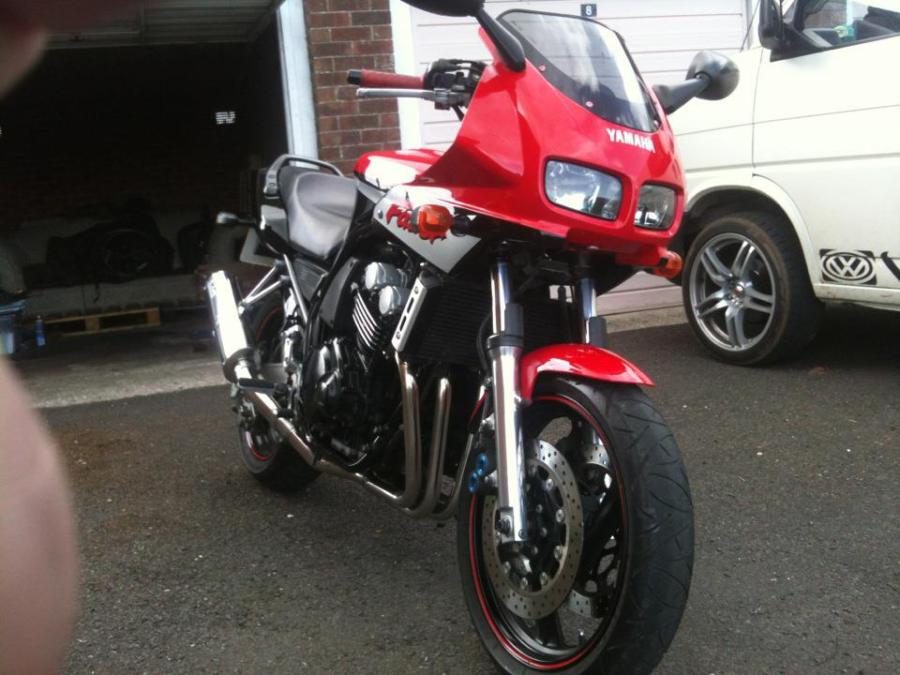

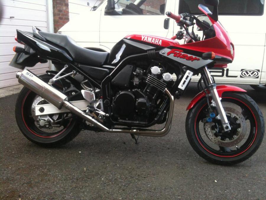

this was my partners fazer after alot of polishing, sanding and new paint job all done with my own fair hands :rolleyes
Nice! Did you do the fork bottoms as well?
(25-04-12, 05:20 PM)Fuzzy link Wrote: Nice! Did you do the fork bottoms as well?
sure did......cam end caps,generator cover, rear peg hangers etc. just a shame i couldn`t get the pi$$ing thing to run right. never mind :rolleyes
I've done exactly the same as you - just not the forks yet. Easy to do & keep on top of. Good looking naked conversion, even if it never ran right Smile

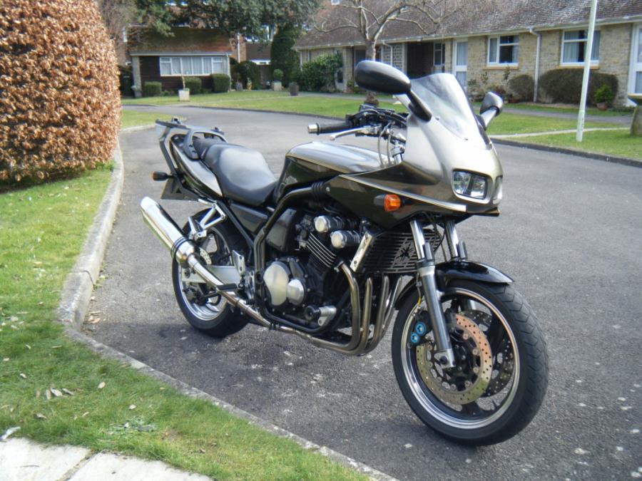

Took the cam caps off to sand down & polish but not any of the engine casings. Mine are not as polished as ade the blade's but I think it looks okay, makes the engine more of a visual feature.
thats a nice finish you got there,Fuzzy. nice looking bike. Wink

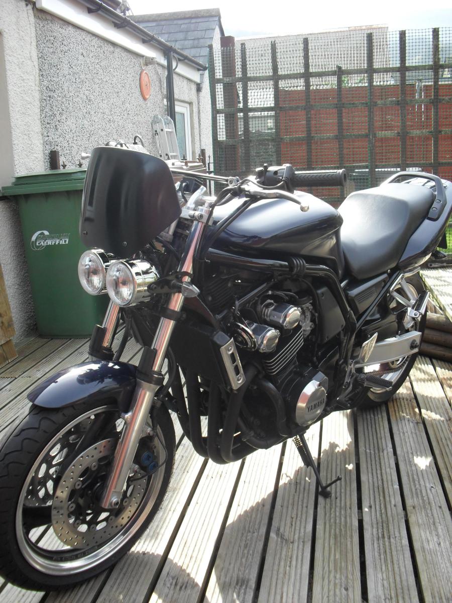

very nice, cheers ive polished my forks and cooling fins on side of engine thinking the cam covers are next, then mayby engine casings ecuse the fingers in the edge of the photo,
.jpg   485823_10150791319826655_585356654_9925386_1979640678_n.jpg (Size: 66.73 KB / Downloads: 45)
chris
Forks look awesome, good job! Must get around to doing mine, they're in a real state.
