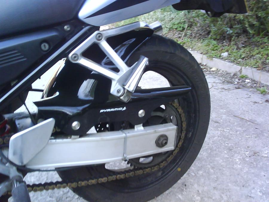

Any chance of a pic as I can't decide whos's hugger to go with  :lol
here's a couple of quick pics of the pyramid hugger
[Image: 118197.png]

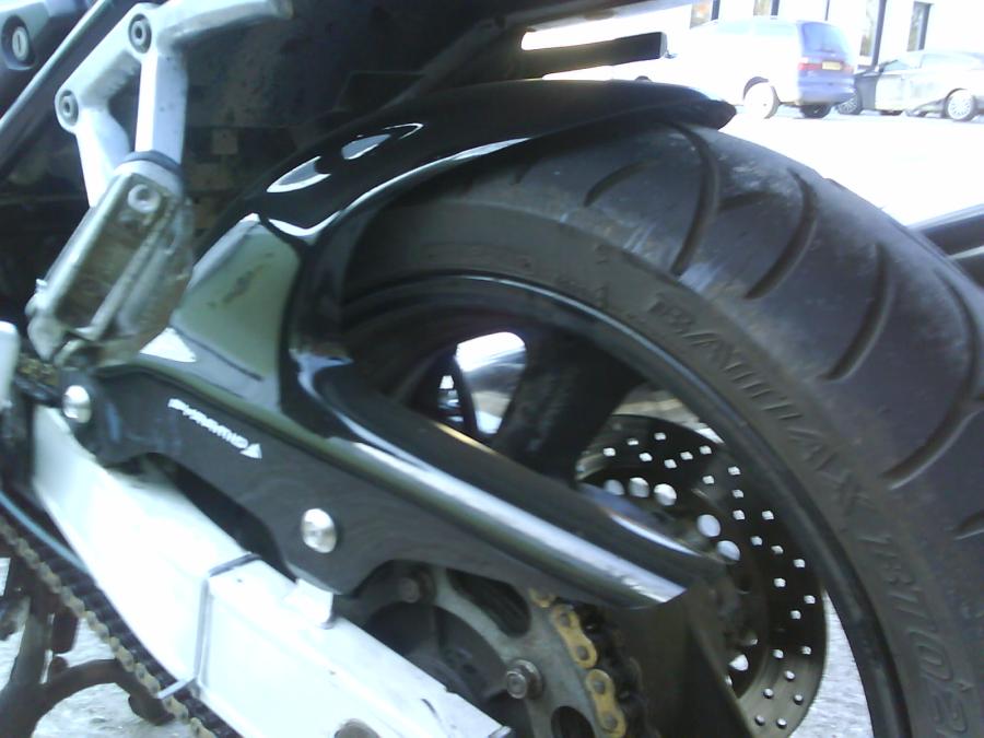

not sure why this pic didnt seem to load in my previous post?
[Image: 118197.png]
Looks good I just cant decide on the Pyramid or the the Powerbronze hugger
