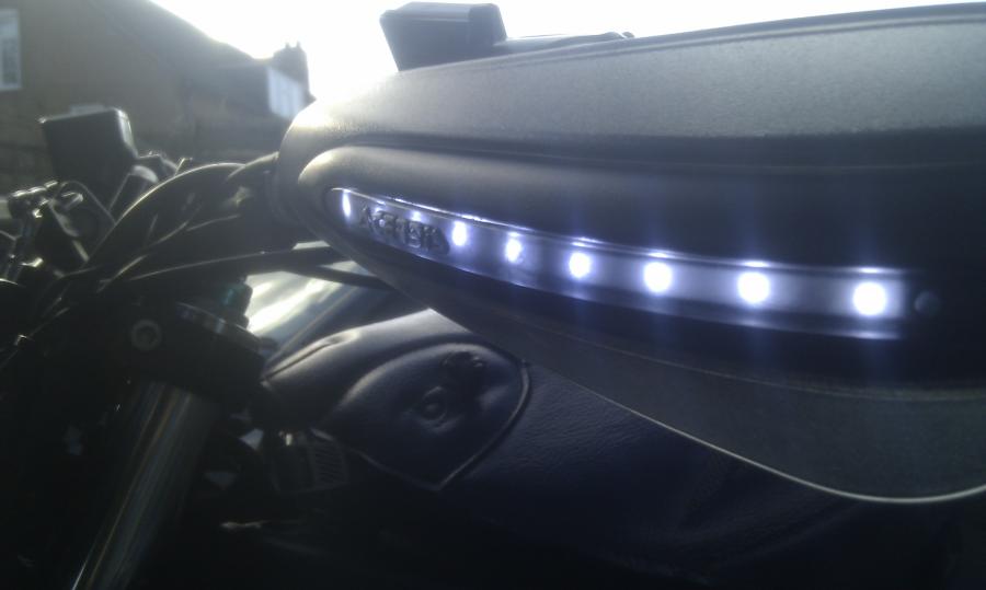

Here are the Acerbis Dual Road hand guards, i've had them for around 18 months now.  They do make a small difference to the wind blast and let you keep using your summer gloves slightly longer.  One advantage is that they do keep some of the rain off when riding (> 30 mph) and that is useful.
Anyway,  Acerbis sell LED lights for them but looking on eBay these LED strips are popular ([size=78%]http://www.ebay.co.uk/itm/1-UNDER-CAR-MO...336307dfea[/size]) If you search for LED SMD you'll see loads of adverts for these 5m spools of LED strips.  They run on 12V so are fine to wire into the bike.

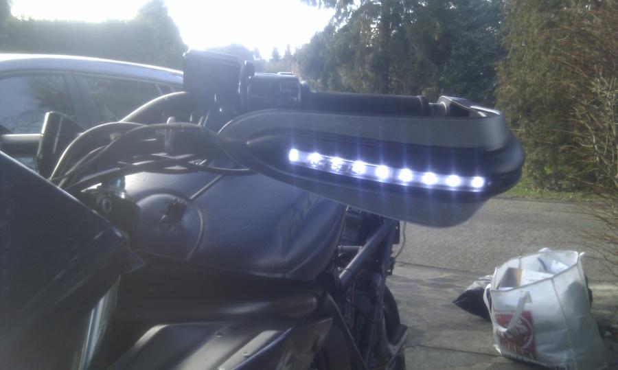

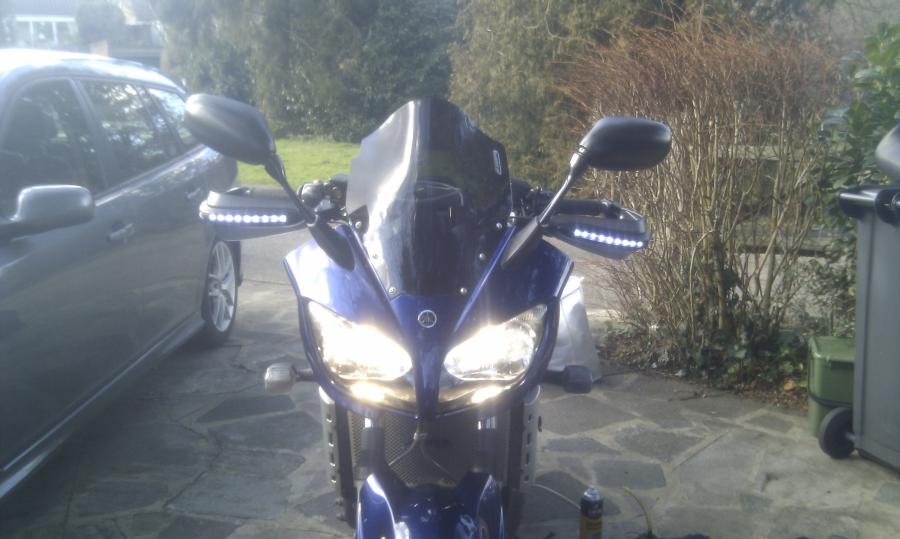

I had to slightly mod the Acerbis clear plastic strip with the dremel but the LED strip fits a treat.  It's nice and bright and gives the bike a wider look.  You can see from the 4th photo i put some heatshrink on the wires and they provide a neat installation.
The clear plastic on the handguards has a slight blue tint, very slight.  If it was completely clear the lights would be as bright as those LEDs fitted to new cars as daylight running lights.

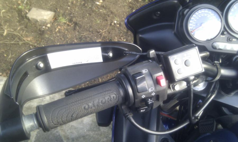

I have a Fuze Block (www.fuzeblocks.com) fitted (great device, would highly recommend) and as this is a switched live i have the LEDs some on with the ignition.  The LEDs draw milliamps so no power issues occur,  i've also taken out my sidelights (5w each, 10w total) as they were a little redundant with the LEDs in the handguard.
I hope the post is useful to others thinking about this type of thing, or just to highlight these LED strisp which do allow some innovative mods to occur.

The Acerbis handguards work well as the LEDs fit behind the clear plastic cover.  This gives a neater appearance than sticking on the led strips to the outside of the handguard.
The only slight negative ont eh indicator idea is that the clear plastic cover on the handguards does have a slight blue tint so it may affect the colour of the indicator.

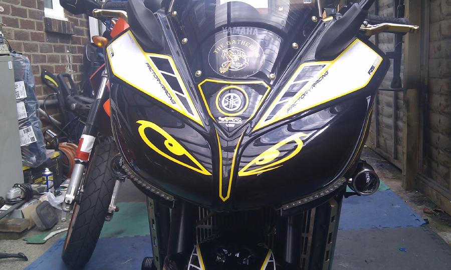

My other idea for running lights was to fit the LEDs to the plastic radiator guards.  The wiring wouldn't be visible and it might look good.
I've bought a roll of Red LEDs to fit to the Givi top box and i'll post a detailed review of that once it's complete.  It should give people a good understanding of how to cut and fit the LEDs
I had multi colour choice LED's fitted inside the rad guards for a while, still have some fitted to the inside of the belly pan, side pannels (they have been cut out and meshed), under tank and under the rear end. oh and under the clocks to lol forgot about those allmost.
did have as i said in the rad sides and under the front mudguard (again i have meshed cut outs on a carbon guard) but i had a set play up so removed some rather than buy more.
looks nice at night but because of where i placed them you cant realy see them indaylight and are totaly hidden when not lit up.

I run my heated grips, heated jacket and the LEDs off the fuzeblock.
I will post up some photos of that as it's a straight forward install, i know a lot of people aren't too sure about electrics but it is straight forward.
The fuzeblock is a well made bit of kit and as it's individually fused it gives goo protection for each circuit you connect.  You can also configure each feed to be either permanent or switched.
