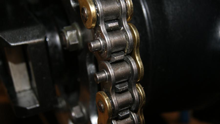

Had a bit of trouble riveting the "soft link" on my new chain. After hours of using what muscles I have I broke my chain riveter and although I caused an indentation on the ends of the soft links it was not enough to stop me being able to push the link straight back through.
The link is not hollow and I really can't see how any tool could cause it to flare enough to be safe. Has anyone else had this problem? I am thinking of buying a different soft link that is easier to flare.
Any tips appreciated.
Cheers
Ian
Photo shows the unflared pins!
I think I've worked it out. My riveting tool only has the fitment for hollow links and not solid links. It might have been nice if the tool instructions had pointed that out!

if you get some one to hold a hammer head against the oposite side of the link then if you assemble the link and then centre punch the ends af the link with a centre punch thats what i did the last time worked a treat
(26-12-11, 06:56 PM)paul.s link Wrote: if you get some one to hold a hammer head against the oposite side of the link then if you assemble the link and then centre punch the ends af the link with a centre punch thats what i did the last time worked a treat
Ditto... as quote... just whacked with centre punch an large hammer on other side... sweet
i had new chain & sprockets fitted not long ago, & above is how the guy did mine. he held a hammer against the oposite end of link then just peened the end of the link over with another hammer.

Thanks Dave - I am quite a way from you in Cambridge unfortunately. I have ordered a hollow link and will try that as it should be a lot easier. Not sure about the hammer solution as knowing me I will hit something expensive (not difficult given Yamaha spares prices).

I had this problem a while back, i am lucky in that my local shop is pretty good and have been loyal to them for a long time (since i was 16 and im now 40 Tongue ) they lent me a rivit tool that looked like it was from the ark but worked a treat where as the one i brought from a dealer broke in seconds.
I did of course give them a few drinks for the loan and was realy greatfull to them. affter i spoke to them it turns out it is a common problem with some modern chains where the split link is much harder than is needed and he has heard of many broken tools.
