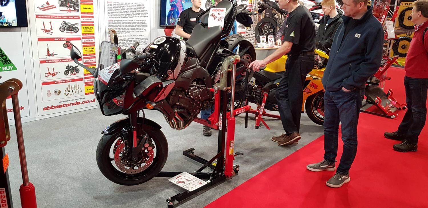

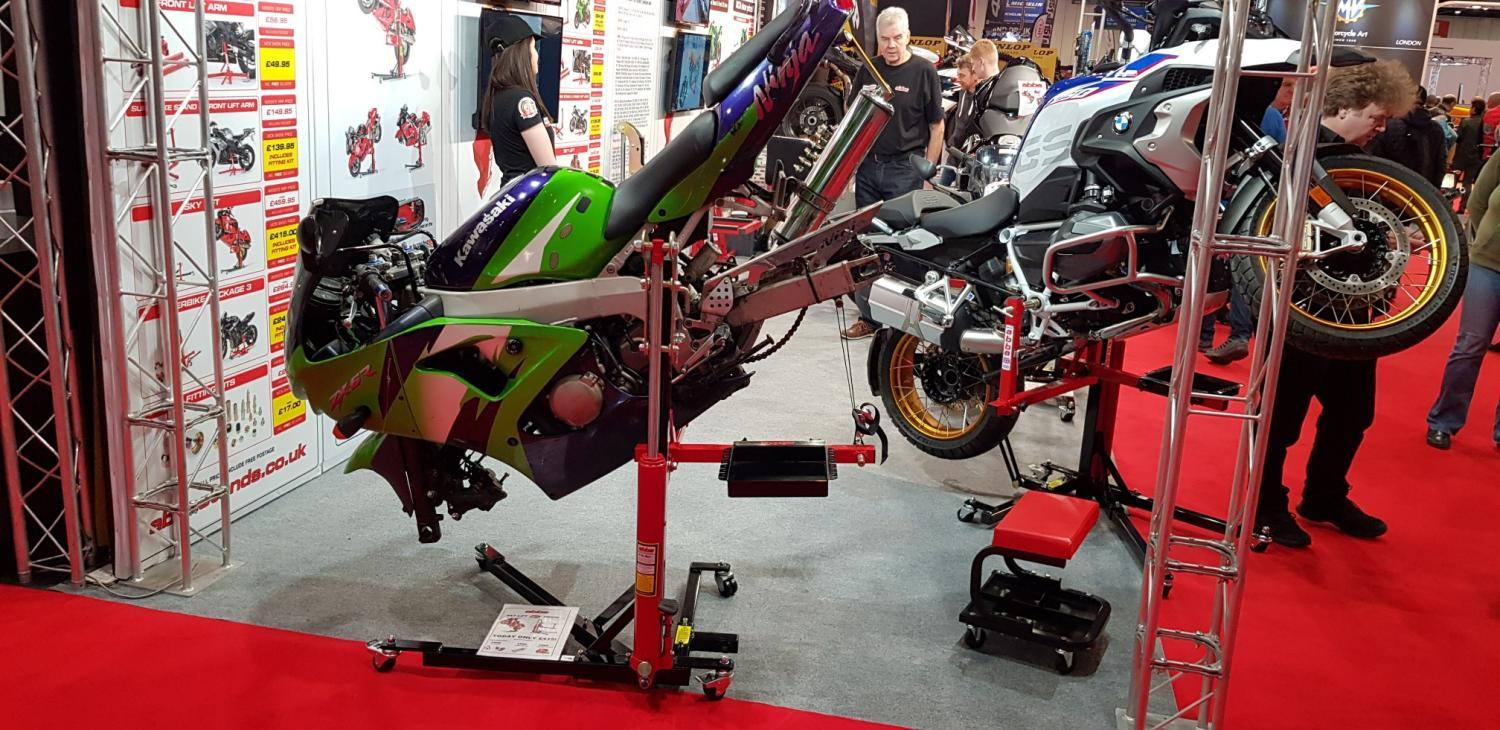

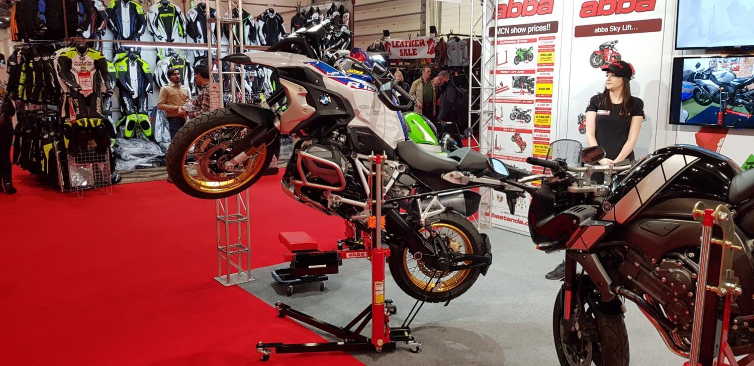

Went to the Excel today. Here's a few pics for Mr.Red, taken on the Abba stand. A Sky Lift is the way forward.
mmmmmm  very nice.......thanks for the piccies ROBBO  :thumbup ...did they have a special show price ?
Pretty sure it was £415 with one set of adaptors.
(15-02-20, 07:21 AM)robbo link Wrote: Pretty sure it was £415 with one set of adaptors.
£467 from M&P......eazy rizer lifts any bike without the need for different fitting kits....direct from quasar for £340 + £25 p+p....ive not seen one in the flesh though.....
