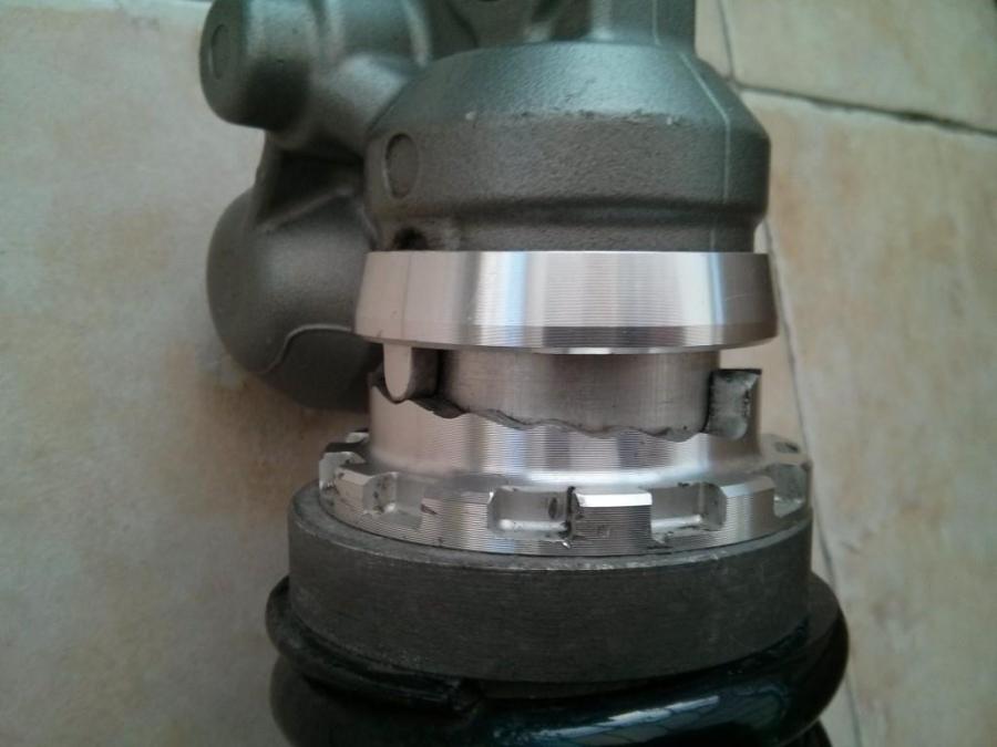

[size=1.45em]  as usual late to the party but have a question or two on this mod I've read you need to file the 2006-07 R6 2c0 shock does anyone have any more info on this like a picture ??? what needs filing ??? [/size] and what spring would i need as a 19 stone ride ???
Finally found the pictures to update.  2C0 shocks just require a tiny bit of filing on top - stops it fouling the top frame brace.
[Image: 20160705-152735.jpg]
[Image: 20160705-152803.jpg]
[Image: 20160705-152716.jpg]
Those shocks don't fit as many other bikes, so there might be some bargains out there...

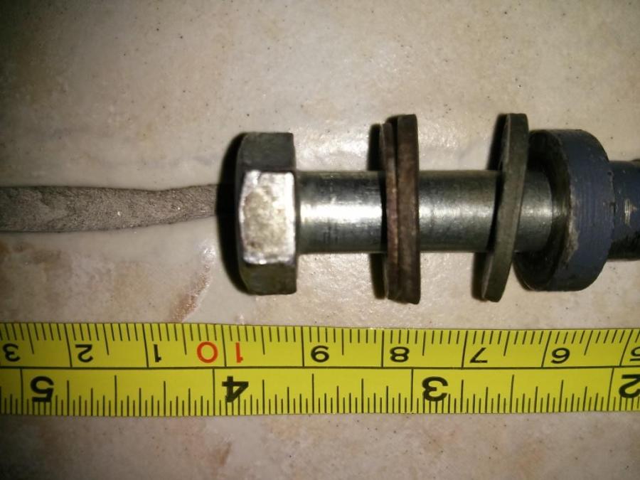

Hi Can anyone tell me is this set to preload =6.
Also the top bolt looks to have three washers is this normal.
The length is 90mm long, is this long can anyone say how much thread will stick out of the locknut.
If its too long what length shorter bolt do i need to buy....
The dogbones that came with the shock are 127mm centres, how much does this lift the rear....
I would like the rear to be std.
So where can I buy the 130mm dogbones...
Help required.
can someone tell me what the bolt size or sizes are for the suspension linkage.
2x for dogbones I assume they are same length.
2x for shock attachment M10x???mm (what length some say 75mm) top bolt for R6 shock I assume the bottom bolt is the same as std bolt.
The std dog bone bolts measure as 130mm long, the dogbones i have for the R6 shock are (127mm) these are 8mm thick.
Std dog bones are 6mm thick so is there enough extra on the std 130mm bolts to take the 8mm dog bones.
Or do I need to buy a couple of bolts 135mm long, if so what M size are the bolts.
