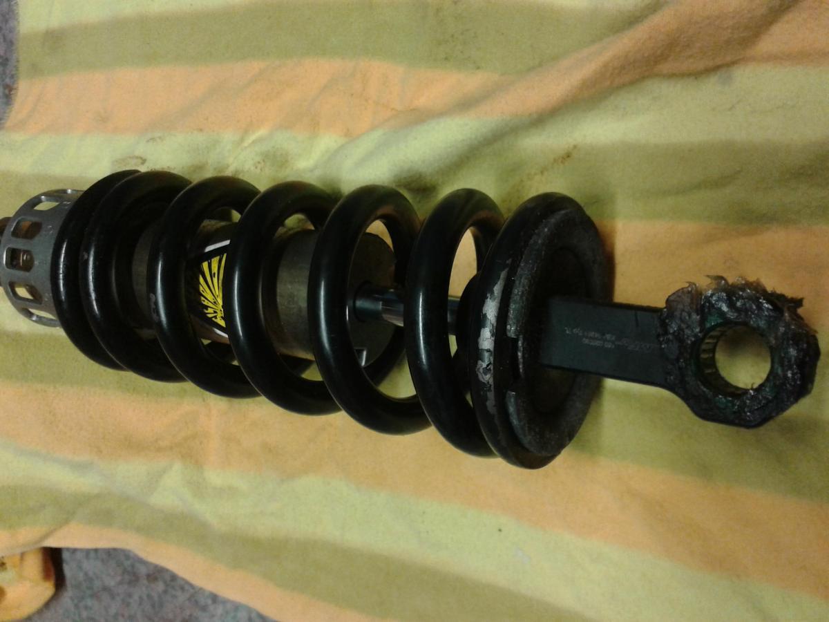

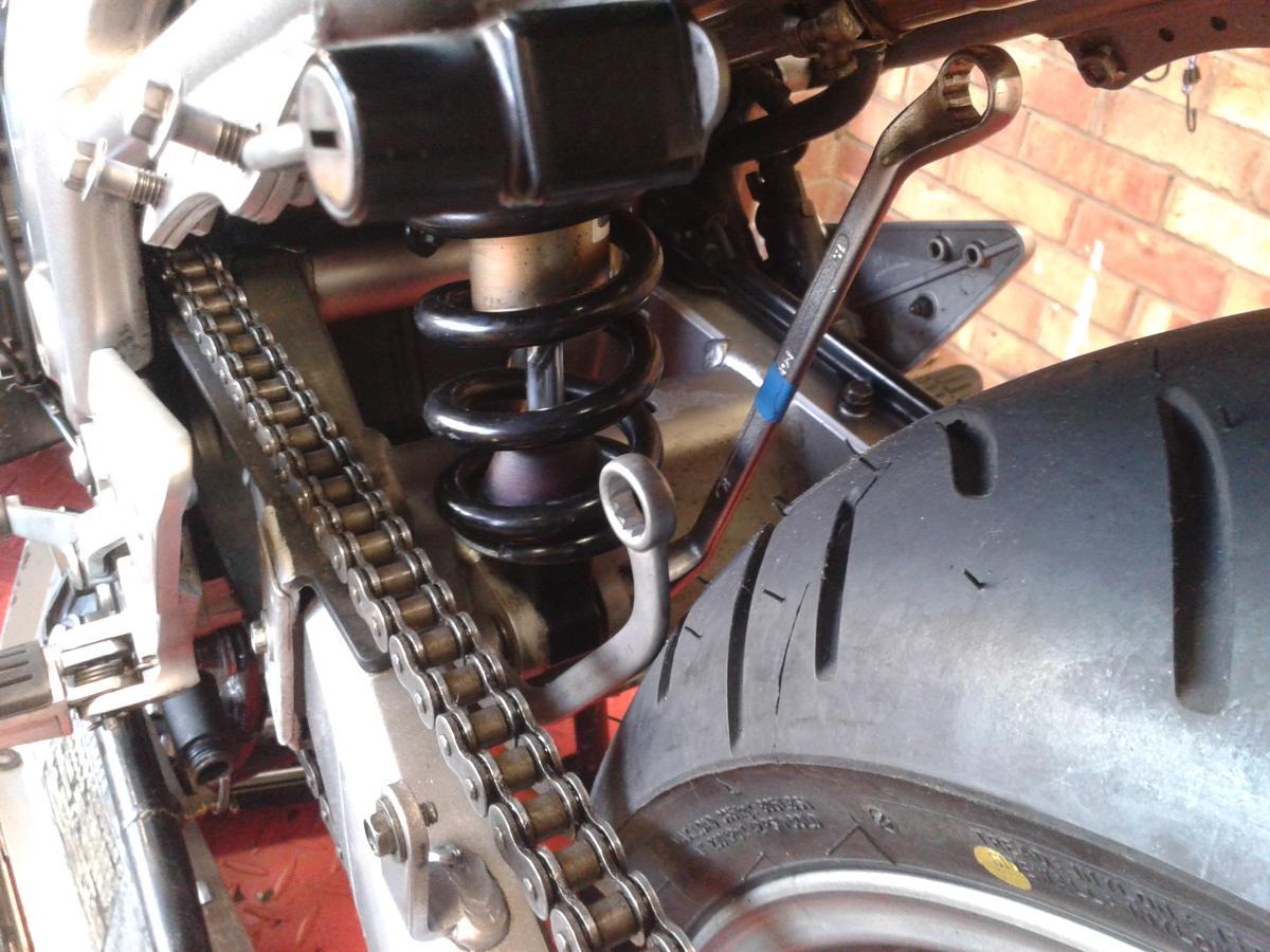

Not raining yesterday morning, so the bike got the thorough wash its been due for some while. Dried it off, then set to this morning with some maintenance. Three years since I had the shock off, so thought Id do that and clean and re-grease the bottom link. Not too shabby at all really, came off without any difficulty, think Ill put it on a two yearly cycle. Cranked and offset ring spanners in action

Haynes says to remove the rear wheel, and then remove the bottom bolt and bush first, but to be honest if you keep it lubed you can get the bottom bush out without wheel removal, and taking the top bolt out first removes nay tension on the bush too. Hope fully ill get some time to refit tomorrow, get the one tooth down front sprocket on, oil and filter change then blather the bike in ACF50

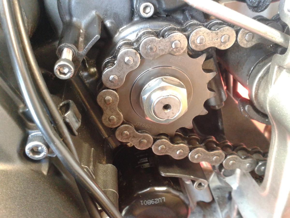

New one tooth down sprocket on, shock refitted. Hopefully, with the sun out, Ill get it coated with ACF50 this afternoon. If it stays dry, hopefully get a run in perhaps Tuesday

(17-01-20, 09:43 PM)agricola link Wrote: Haynes says to remove the rear wheel, and then remove the bottom bolt and bush first, but to be honest if you keep it lubed you can get the bottom bush out without wheel removal, and taking the top bolt out first removes nay tension on the bush too. Hope fully ill get some time to refit tomorrow, get the one tooth down front sprocket on, oil and filter change then blather the bike in ACF50
Well,I hope you have an easier job than I did when I did my front sprocket last year,it was so tight I couldn't believe it!! I ended up buying a heavy duty socket,a long bar with a scaffold tube on,a big wedge of wood through the back wheel and my missus holding the front brake on,I honestly thought it had somehow welded itself to the bearing or something,when it moved you'd have thought I'd won the lottery ! :lol
#94
Just seen you did that job,was it fairly easy to get the front sprocket nut off?
#95
(26-01-20, 12:23 AM)coffee link Wrote: Just seen you did that job,was it fairly easy to get the front sprocket nut off?
No problem really. Stout piece of timber in the rear wheel, socket with breaker bar on the nut, went as expected. Slackened the rear axle, pushed the wheel forward, looped the chain off the rear sprocket, unscrewed the front sprocket nut,  waggled the sprocket off, slipped the new sprocket into the chain, then just reversed the operation. The angle of the chain over the swinger has altered slightly, but doesn't look like a major problem. Been for a spin in the morning sunshine, although the roads are still wet, nothing untoward. Just got to reset the gear indicator now as the smaller sprocket seems to have resulted in 5th and 6th both reading as 5th
