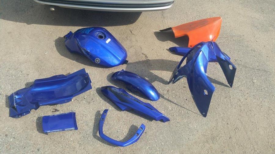

Picked up some bits to repair my bike, got a good mate that's mad on gazers.
[Image: 7B12EC02-2F4C-4885-B7B8-40EEE3562AAA.jpg]
#85
(23-09-15, 07:53 PM)Wild32 link Wrote:Picked up some bits to repair my bike, got a good mate that's mad on gazers.
AA gear lever, exhaust can, tail tights and an exhaust can.......WTF did you hit, a friggin bulldoser?

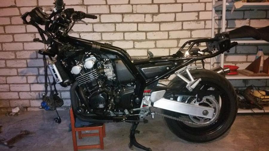

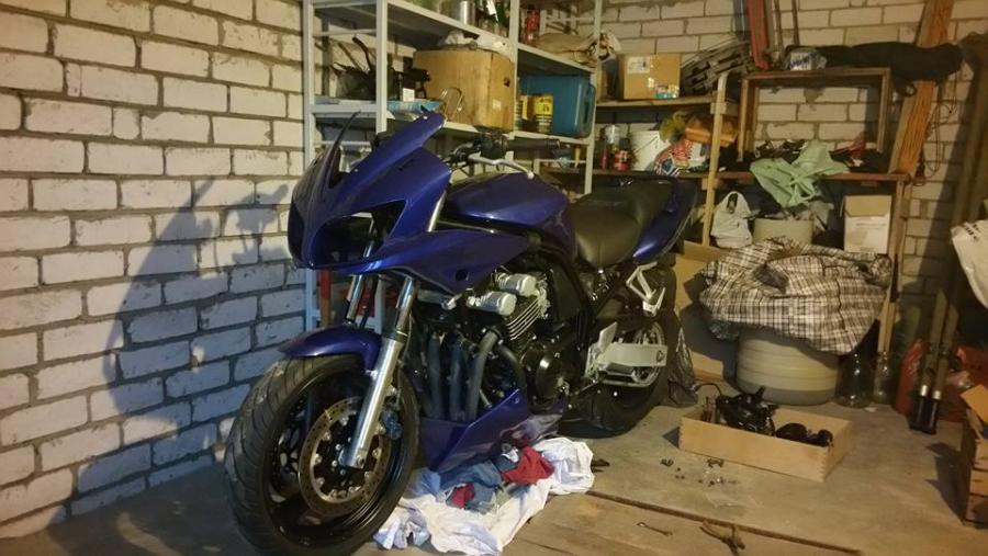

Got my end up about another inch....ooooer Mrs
[Image: aEWxMK.jpg]
I know the chains dry, not on the road yet and stored indoors so will survive a little longer
[Image: RrvoaW.jpg]Technical part now. Removing rear wheel may make it easier to move the swingarm to allow fitting of the dogbones but 2 dvd's and a piece of cardboard left the bolts about 1/4 of a hole out, plenty of grease and it slipped right in.....oooooer Mrs
[Image: W2Ro7M.jpg]
To ease removal of dogbone bolts you will need the Alien box set and two other dvd's of your choosing, Oh and a piece of cardboard. I didn't get a picture with my chock in place but this was the height of the wheel before fitting the new bones.
Length of time, start to finish, one roll up and my cup of tea was still warm when I'd finished.  Big Grin

(23-09-15, 11:49 PM)joebloggs link Wrote:[quote author=Wild32 link=topic=17296.msg211045#msg211045 date=1443034433]
No crash , only a matrimonial knife and hammer attack.
Have a look at the pics in my introduction.
#91
(25-09-15, 08:15 AM)Wild32 link Wrote:[quote author=joebloggs link=topic=17296.msg211090#msg211090 date=1443048540]
Bloody hell, she did a right number on that, what he do, foc her sister or something  :eek
