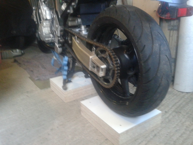

made this today and will do another tomorrow, one for the centre stand and the other for the rear wheel (no front end on the bike at the moment). only 100mm , but every little helps...... :thumbup
.jpg   20200107_184221.jpg (Size: 92.9 KB / Downloads: 133)

got the mighty thou on the blocks this morning.made things a bit easier for the rebuild . parts should be with me for next weekend so thats as much as i can do this weekend .plenty of other projects to keep me busy this weekend though  Wink
.jpg   20200111_113317.jpg (Size: 105.64 KB / Downloads: 86)
.jpg   20200111_113447.jpg (Size: 105.86 KB / Downloads: 87)
