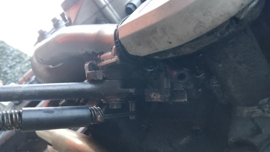

Had another gander this evening as it's due to rain tomorrow :/ the cam chain tensioner is making some noise......But most of the noise I can hear is still from the fuel pump. :/
Had more smoke this evening, but it was from the exhaust link pipe up the side of the bike, will try and upload pic. Any ideas why it's doing this?

Something I forgot to mention, was the other overflow pipe i seen by the side stand........pics attached.
#74
Air box drain hose with inline filter.

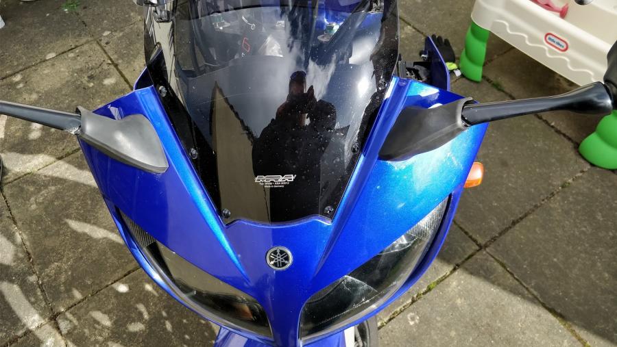

I also carried out the Fuzzy mirror mod, it does give alittle bit of extra space for possible fitment of handguards though havent cut down the rubbers yet as I'm unsure if it improves my view or just moves the mirrors down, will need to have a jolly about and decide. May have to put it back how it was with extenders on.

Went out for a bimble, Had to change back to mirrors, due to the reason I could get the bike through the gate posts :/
Think I'll just live with the blind spot behind me and hope nothing catches up  :lol
