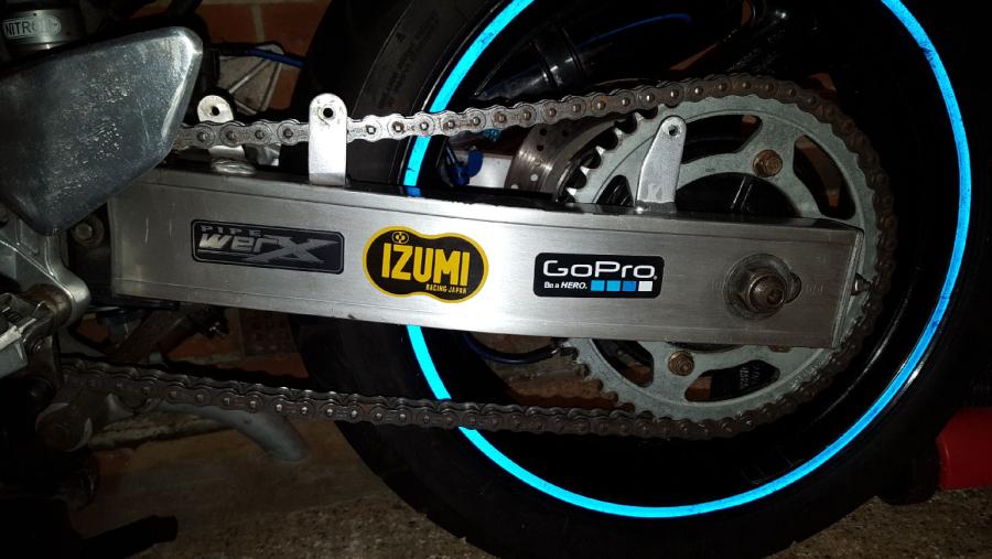

(06-12-17, 09:30 PM)darrsi link Wrote: Chain looks a bit taut there Sharpie, you got enough play in it?
Yep - think so,  30-40mm and just touches the underside of the rubber guide when pushed up perhaps its the angle.
Think it was a little too slack before - see here, I then pulled the wheel back by 1.4mm

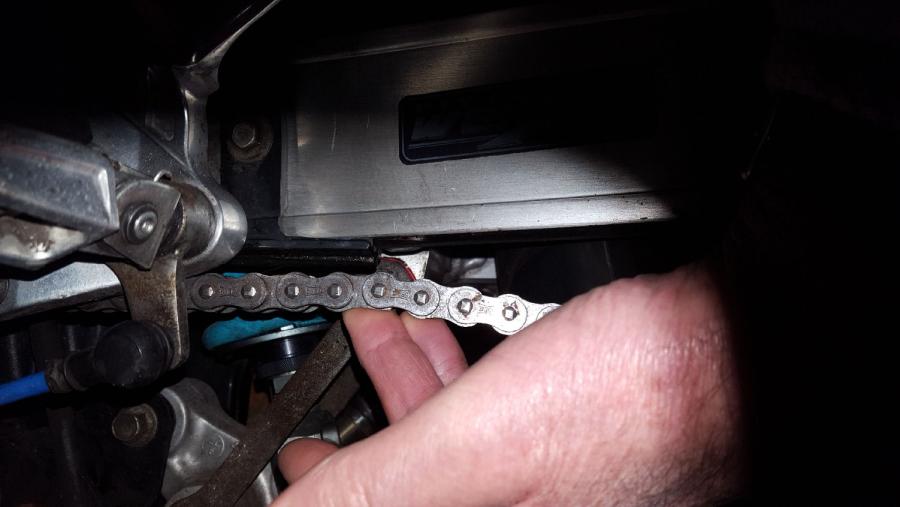

[Image: index.php?action=dlattach;topic=20030.0;...1006;image]

I must admit i took 'unfazed' tip of touching the chain guard with the chain when i refitted my wheel last week and it is a bit tighter than i normally have it, but it's not making any unpleasant noises and there's no feeling at all through the footpeg either so it must be spot on.

Got me thinking and questioning myself now, there is 1 tighter spot that still touches the guide but needs pushing up a bit harder than the rest. Don't feel or hear anything out of the ordinary but sometimes it would be handy if I just had someone who can give it a wiggle and a second opinion.
I measured it before I adjusted it and it was all a good 40mm slack, and easily able to slap it on to the bottom guide and beyond at a measured 40mm.

If it was way too tight it would grind a bit but you'd hear and feel it, same as if too loose you'd notice excess chain slap.

Didn't notice any problems before the adjustment, it just felt a little slack -sloppy when prodding.

The general consensus seems to be with the chain in the tightest spot of the chain run the chain should be able to touch the underside of the swinging arm rubber guide without a lot of force.
Bearing in mind if you lube the chain with one of the spray lubes that tends to set a bit then adjust the chain so that the tension is as above, one short ride and the chain will be slacker because of the lube being squished out of the numerous links, so I guess adjust the chain correctly then lube would probably be the best way.
