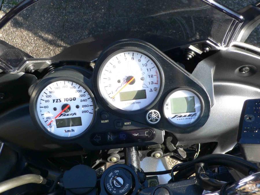

is it possible have a white face with the fazer logo on it like the one below  ?
[Image: url%5D]
#64
Well, that looks like white on white  Smile
Unfortunately I have only black anodized ones with white FAZER on it. But almost any decal maker knows the multi gauge and is able to provide a complete set in any colour you like. They can be mounted on top.
#65
As mentioned - we (I) would be able to supply pre-cut dial colour change - printed with anything you want...

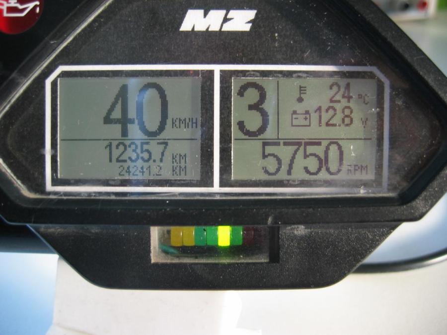

#73
Yes, with some slight modifications it would be able to replace the cluster. The idiots lights have to be added somewhere else. Only for the fan control you have to think of another solution (temp switch from older FZS600 or so).
A while back I did such a conversion for my son's small MZ125. I used 2 gauges. The first to display the odometer exclusively, the second for gear and the rest. The LED band below is for RPM (just to fill the window). The front plate was made of paper.
I did this because the dashboard was given and should stay. In your case I would recommend to go for a KOSO or alike. Makes life much more easy and neat.

Mine also arrived today and fitted this evening. Working great and looks really nice in there.
I was considering the GPS addon but unsure as yet.
