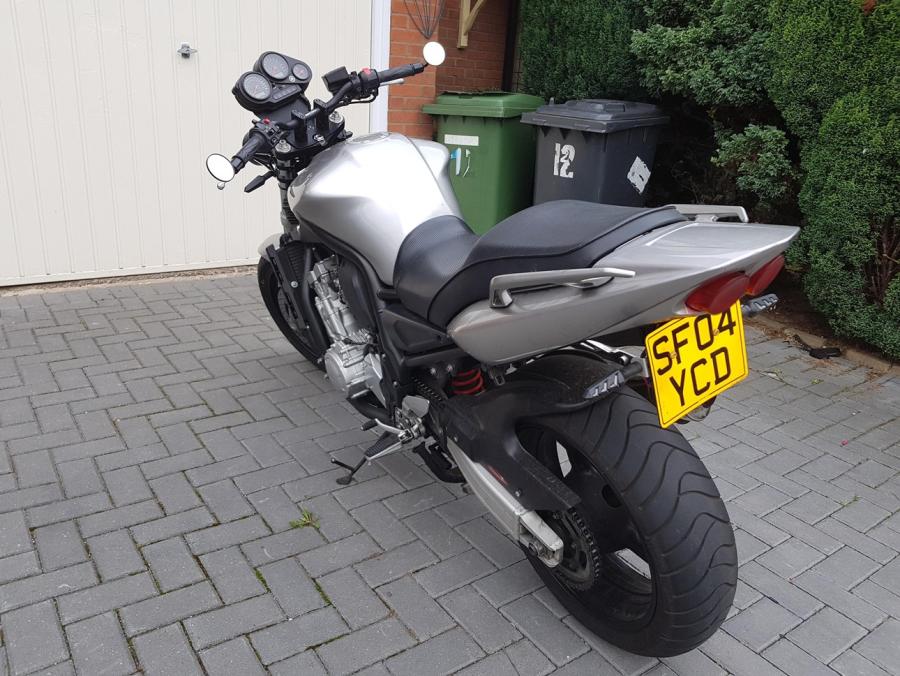

I'll have one, what you've done so far is brilliant, will definitely look better than the original clocks on my streetfighter gen1
If it aint broke, make it better
#47
Wow those old clocks certainly do stick out! lol! Love the streetfighter'd gen1! Tempting to do the same to mine!

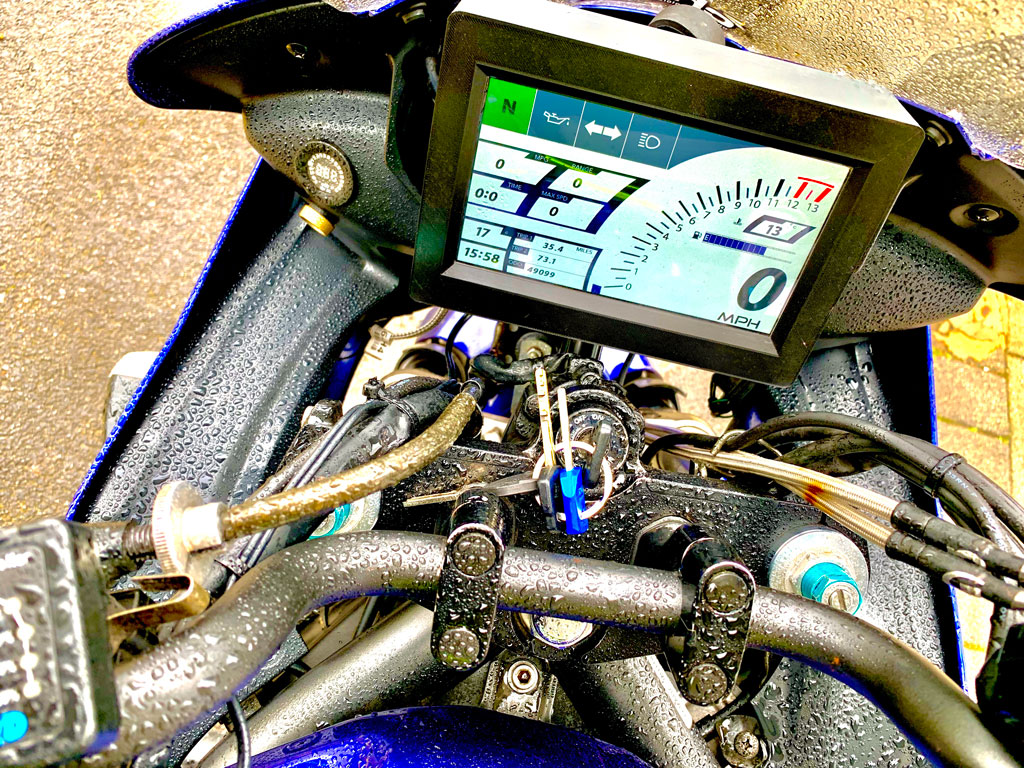

Here's a shot of the TFT Dash with the bike parked up on a rainy day
[Image: TFTDashRain.jpg]

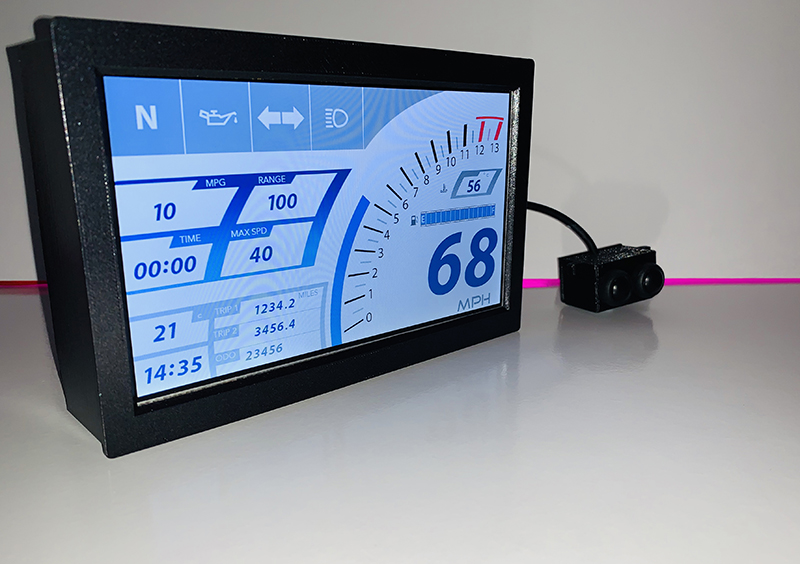

As promised (although a bit later than planned) - here's a pic of 'compact' unit. The one I've been running on my bike is my prototype with the rather large enclosure and bezel. This the redesigned enclosure which has now been assembled - components fitted in nicely. In addition to road testing my prototype really to nail down the accuracy of the MPG and Range displays, I'm also providing a mechanism by which these can receive software updates via USB. This now means any new features and potential software / firmware fixes will be available on the website, and all you'll have to do is download the update file onto a USB flash drive, insert into the provided USB slot on the TFT Dash and switch on your ignition. The flash drive will be detected and the update will be recognised and will automatically update both the software & firmware on the device. All you then have to do is remove the flash drive and switch ignition off.
[Image: TFTDashSmallEnclosure.jpg]
