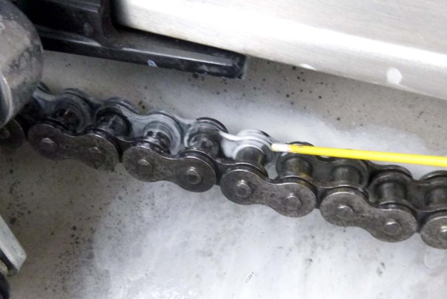

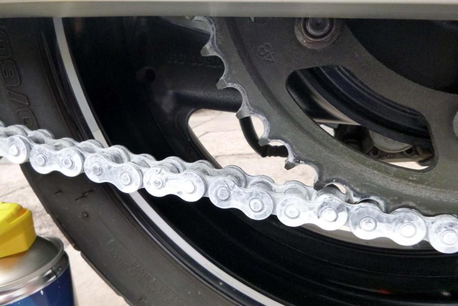

Update.
Blasted out the last of paraffin remains, re lubed one link and roller at a time watched it bubble and run into the rollers. adjusted the slack and re torqued up and took it out for a test ride stopped after 3 miles to check the wheel was still on and went on my way for another 10 miles. Got back and added some more lube on to a warm chain.

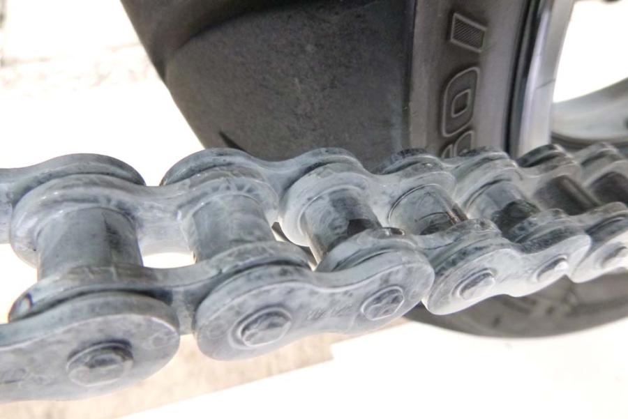

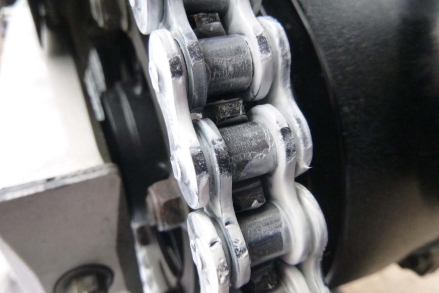

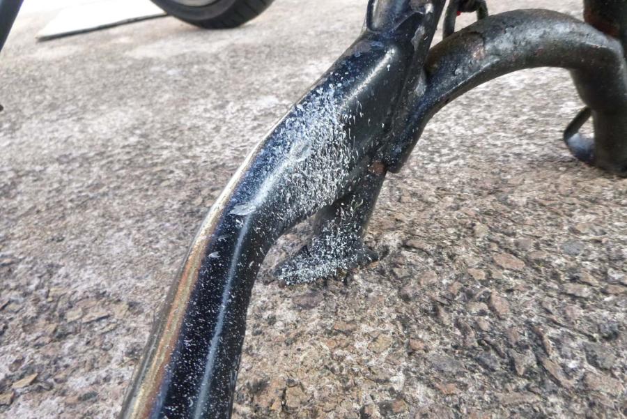

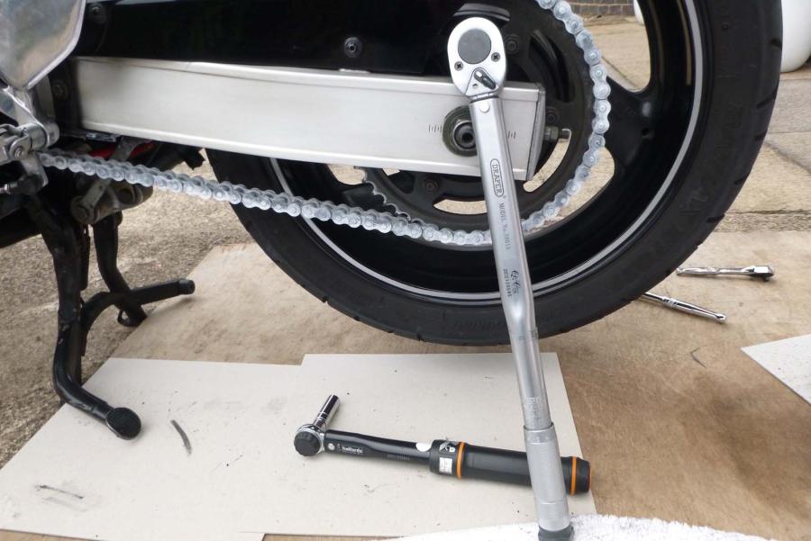

Here is the fling from fresh allied lube which reduces after a couple of rides as it settles in. The folded up centre stand gets the most of it I think really that what comes off is just the amount I over applied in the first place.

Chain looks a bit taut there Sharpie, you got enough play in it?
