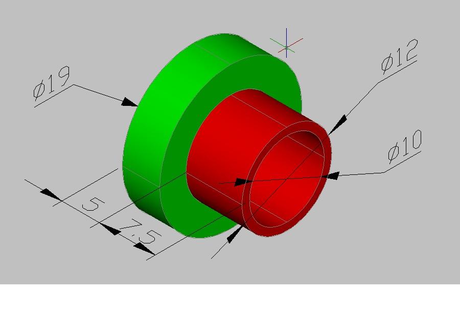

I'm attacking in a slightly different direction.  I'm going to sleeve down the M12 holes to match the shocks M10 fitting.  Advantage - I could refit the OE shock and still have a good, undrilled R6 shock.  Oh, and this should be easier than trying to fiddle about with spacers.  So the M12 bolt will be going and an M10 bolt fitted in its place.

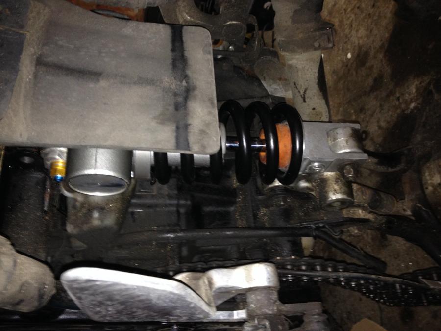

Done. Whilst the missus was at the park with the kid. Took the swingarm off for a good clean and grease up whilst I was at it.
I was nearly stumped as I needed an m10 x 75 bolt for the upper fixing, but found an m10 x 80 in wickes which fitted. I'll probably hunt down a high tensile bolt for that at some point.
Top hat spacers (cad design further up this page) did the job nicely.  They had been turned slightly out of spec so had to take about quarter mm off each side to get the shock in. Can't grumble as they were knocked up for a pint!

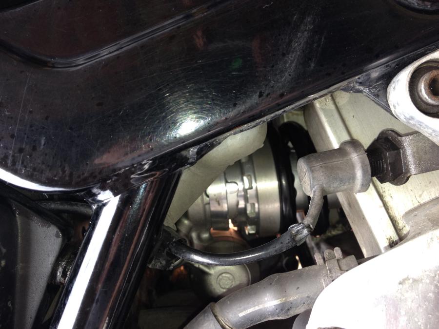

Pic of test fit with the swingarm off
All fitted Smile
My photos not so great though
I can't get the c spanner onto the pre load, so resorted to old fashioned long chunky screwdriver and rubber mallet.
[Image: 300668.png]

Lookin good, glad it fitted with no dramas, I like the top mount spacer idea. Let us know how you get on with the shock on the road and what settings you are using if you have them to hand, would be interesting.

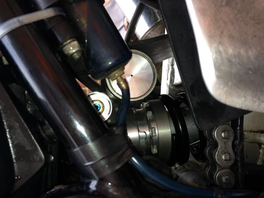

Can barely walk at the moment never mind ride... Prolapsed disk in the spine.  Still, it looks pretty Smile
I set all the rebound, hi/lo speed compression before fitting but damned if I can remember what I set them to... Somewhere around middle

(17-03-14, 11:28 AM)dcurzon link Wrote: Pic of test fit with the swingarm off
All fitted Smile
If you take out the upper peg hanger bolt and crack off the lower bolt you can push it to one side making the preload adjustment a doddle with the c-spanner...
#57
Yes, as above - or you could try from the offside of the bike instead.
#58
I could get the c spanner in, I just couldn't get it hooked up... I'll just knock it around, once it set it don't need to move no more

Faulkner 725lb
Dog Bones were 127.5mm (I think)
I'm roughly 85kg geared, plus I usually carry a load
Preload position 3
Rebound 13 out
Low Speed 13 out
High Speed 2 out
Took it for a ride today, only a 25 minute ride.  It immediately felt much better.  I didn't give it the beans, because the tyres are still fresh (I laid the bike up 50 miles into a new set).  Also because I'm not confident that the bolt I used for the top mount is really up to the job, it was a normal Wickes M10x80, not high tensile.  I'm going to replace it with a high tensile or Ti bolt for peace of mind. We did hit speed limit +/- 10% on some country roads though.
More importantly, I was able to assess my own ability to safely ride.  It was hard getting on the bike, it was hard getting off the bike, and in all honesty, it was hard transferring my weight around to properly ride.  So I think I need to wait a little longer.
On the plus side, the bike started first click of the button after a month laid up Big Grin
Next job - adjust the clutch cable at the engine end.
[Image: 300668.png]
