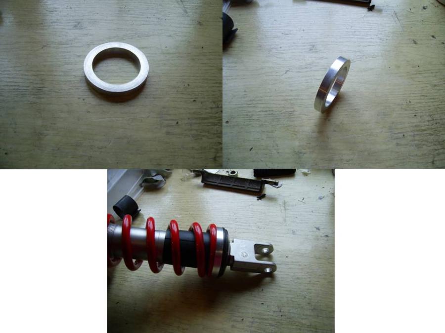

Finally got around to fitting the spacer to the S1000RR shock to enable me to set the static sag to my liking.
See picture it fits nicely
Joe Rock I have 2 shocks and both are slightly different top and bottom one is .15 more and the other is .15 less then the 29.5mm as the average of both measurements
