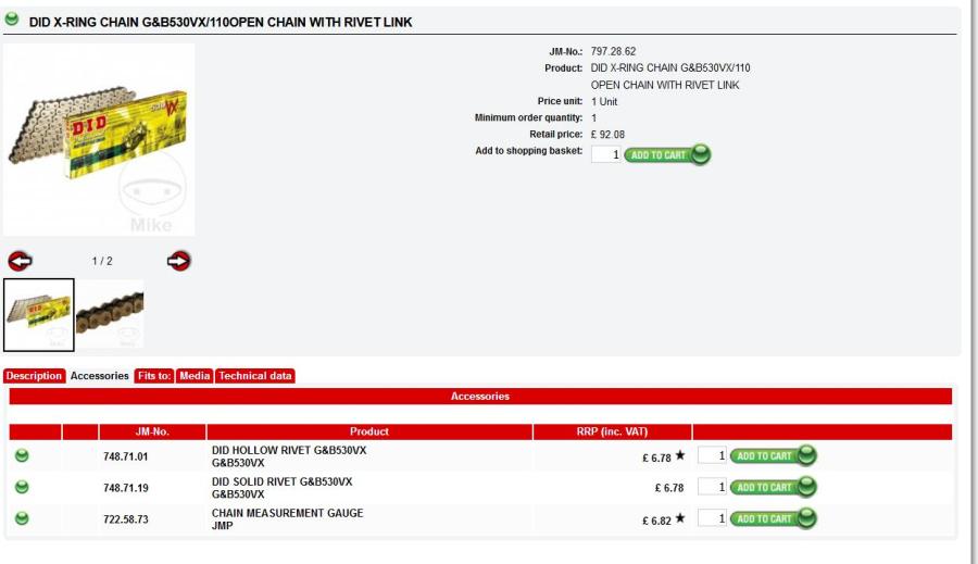

(28-04-19, 11:18 AM)bandit link Wrote: Don't think the chain is endless when fitting it just means it's supplied with a rivet link only instead of a split link option, so hence the endless in the description. [img alt=Smile]http://foc-u.co.uk/Smileys/efocicon/smile.gif[/img]
That has thrown me now.
Here are the 2 options in busters one described as "Endless" and the other as "Open Chain with Rivet link".  https://www.busters-accessories.co.uk/en...600:21149/
But both have a drop down list with "Accessories" which list separately either a hollow rivet or a solid rivet.
Screenshot attached

(28-04-19, 11:54 AM)fazersharp link Wrote: [quote author=bandit link=topic=25205.msg297100#msg297100 date=1556446706]
Screenshot attached
That is a conundrum  :lol
It says "endless" so you would think it was exactly that, but maybe they offer the links in case you alter the size of your sprockets later on, and are just covering all options?
