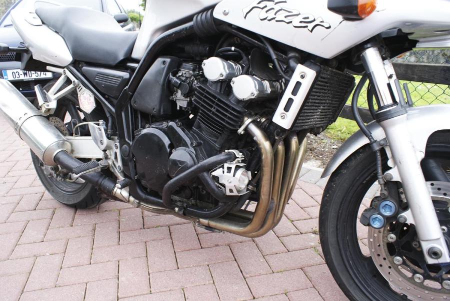

Took the downpipes to be sandblasted, it's not a shock to see these as the bike is 18 years old but with a bit of welding work and some paint they should be good for a few more years
[smg id=3321 type=preview align=center caption="20190430 163728[1]"]

Rewelded & Painted FZS600 Downpipes - 16€
https://imgur.com/a/gfwNKDn
Gunmetal Grey wheels - 50€ incl  tyres fitted and balanced
[size=78%]https://imgur.com/a/fVYOtAw[/size]
https://imgur.com/a/hzbiolb
Satin Matt silver paintjob -€100 - nose cone fairing missing but the same
https://imgur.com/a/5ndvzSL

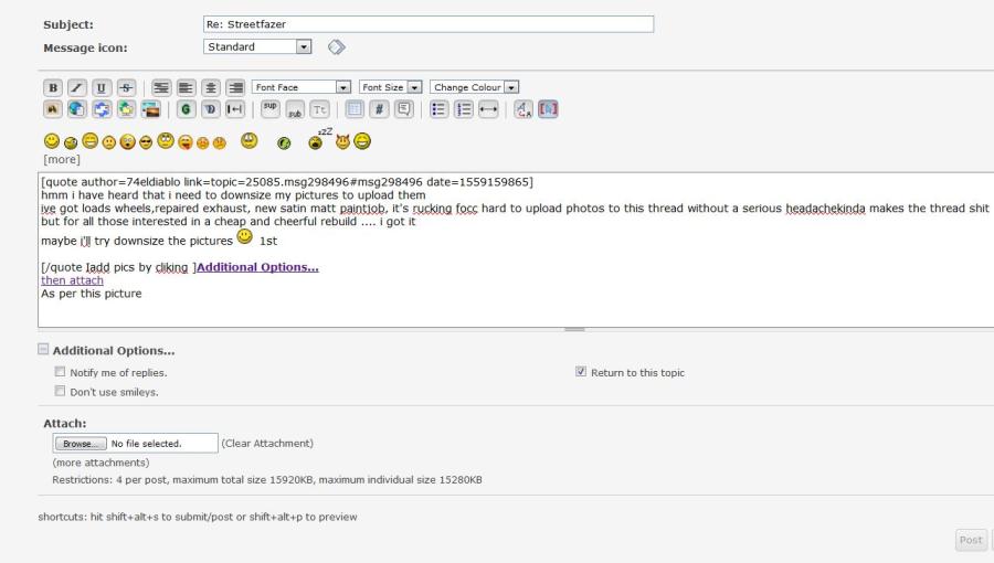

#38
[quote author=74eldiablo link=topic=25085.msg298496#msg298496 date=1559159865]
hmm i have heard that i need to downsize my pictures to upload them
ive got loads wheels,repaired exhaust, new satin matt paintjob, it's rucking focc hard to upload photos to this thread without a serious headachekinda makes the thread shit
but for all those interested in a cheap and cheerful rebuild .... i got it
maybe i'll try downsize the pictures Smile 1st
[/quote Iadd pics by cliking ]Additional Options...
then attachAs per this picture
