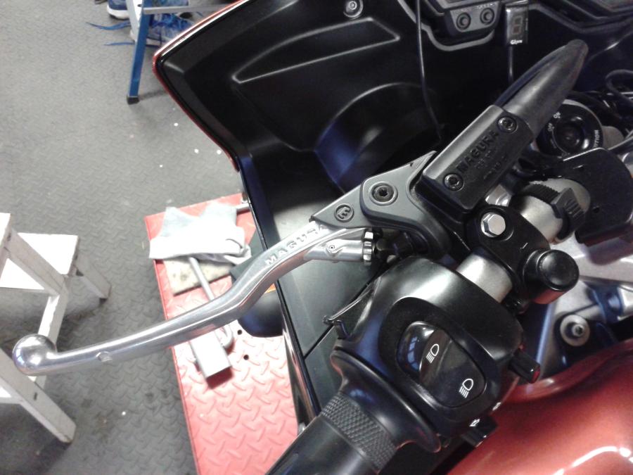

I converted my clutch to hydraulic, light years different now, operate it with 2 fingers its so light, and consistent too.

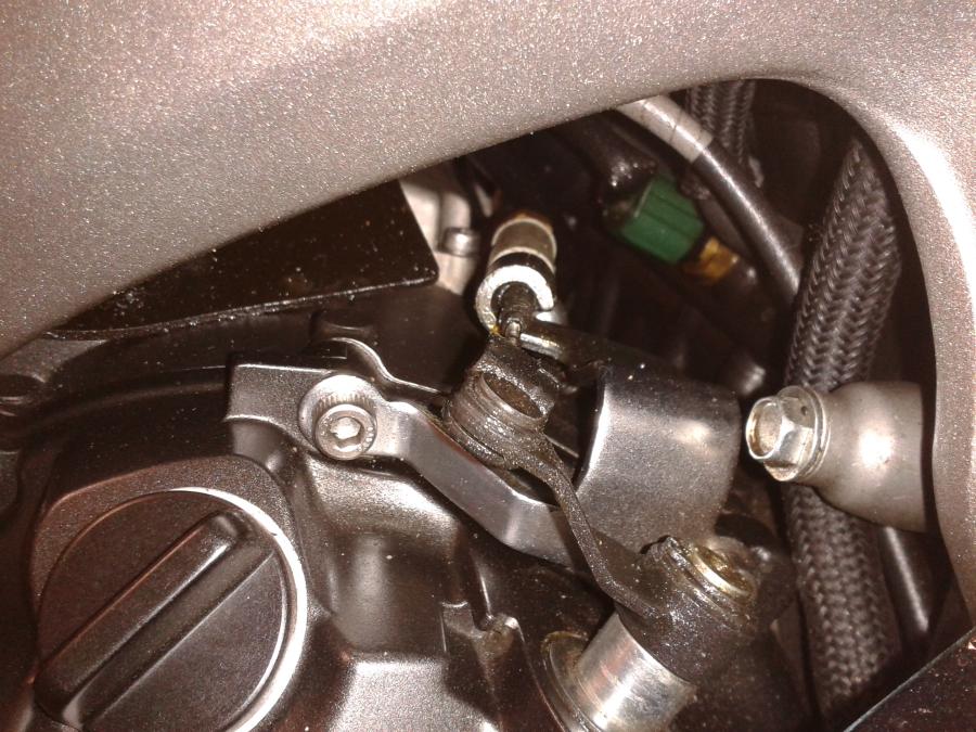

Not difficult at all. I bought a Magura kit from Venhill while I was at the Stafford bike show. Traders are willing to deal at shows and I got it at a really decent price. Everything to complete the job came with it, and it simply replaces the xisting, using the same fittings as for the stock clutch set up. Transformed the bike for me, I was struggling in traffic and on trackdays with constant gear changes impacting on my knucle joints and wrist, if I hadnt of swapped, Id have given up with the bike. No cables to adjust, lubricate, snap on me. Its a trade off as some would think them not cheap. You can get something simlar from China, but reviews and feedback appear to indicate the quality is a problem with them. You can see on the pic that the slave cylinder just locates into the existing bracket on the casing
