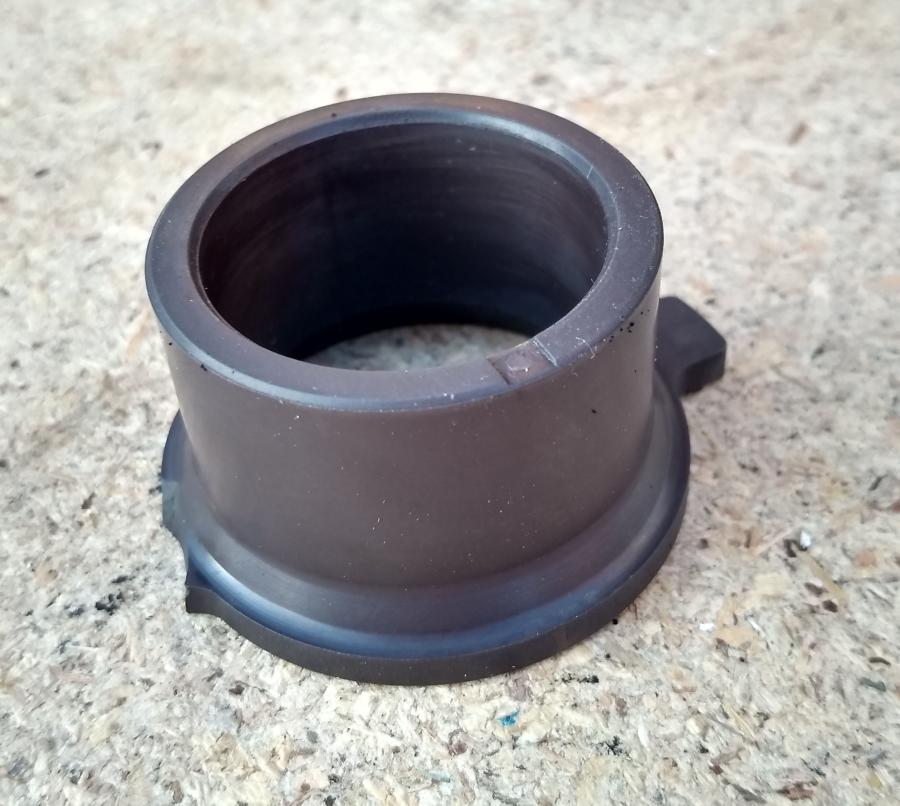

Ok job done today. I now realise that I have only been going half as fast as I thought because I only have 1 lug  :lol .

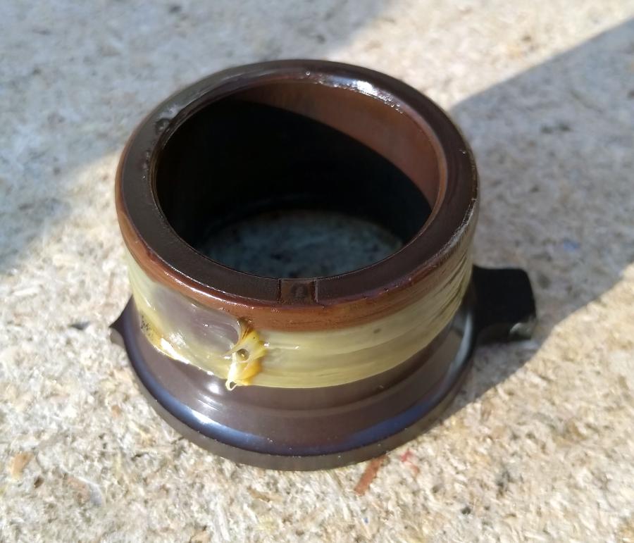

The rotor has already had one of its lugs snapped off by one of the previous tyre fitters  :lmao2 but there did seem to be enough grease and not dry at all. I find it had to believe  its almost 21 year old grease but also hard to believe that one of the tyre monkeys added any either.I cleaned it up and added my own grease so I know its done. I used my RG grease.

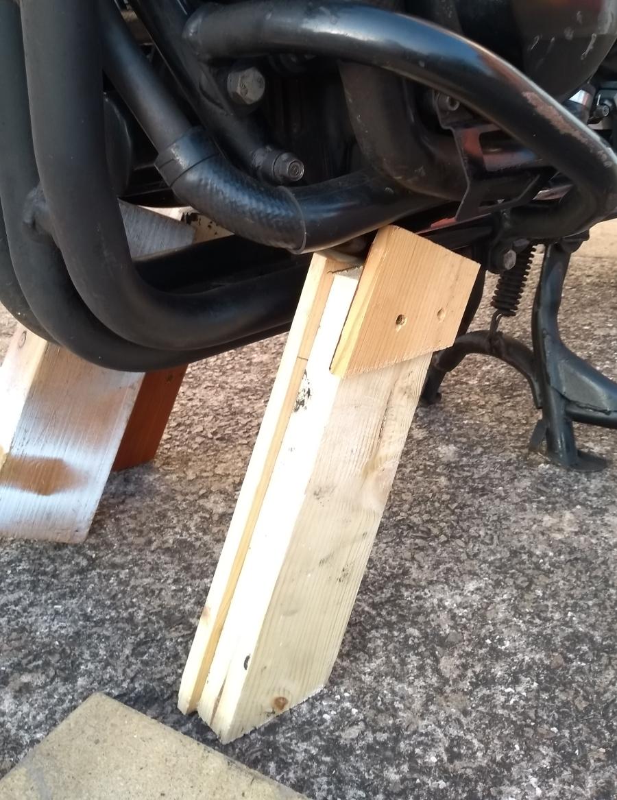

I made some wooden chocks that fit over the lower frame and also took the seat off and added some weights to the top of the undertray.
All torqued up. Not been for a test ride yet to test the rotor - might snap only on one lug with the new stiffer grease.
Pictures below - first one is the (21 year old grease ? )
