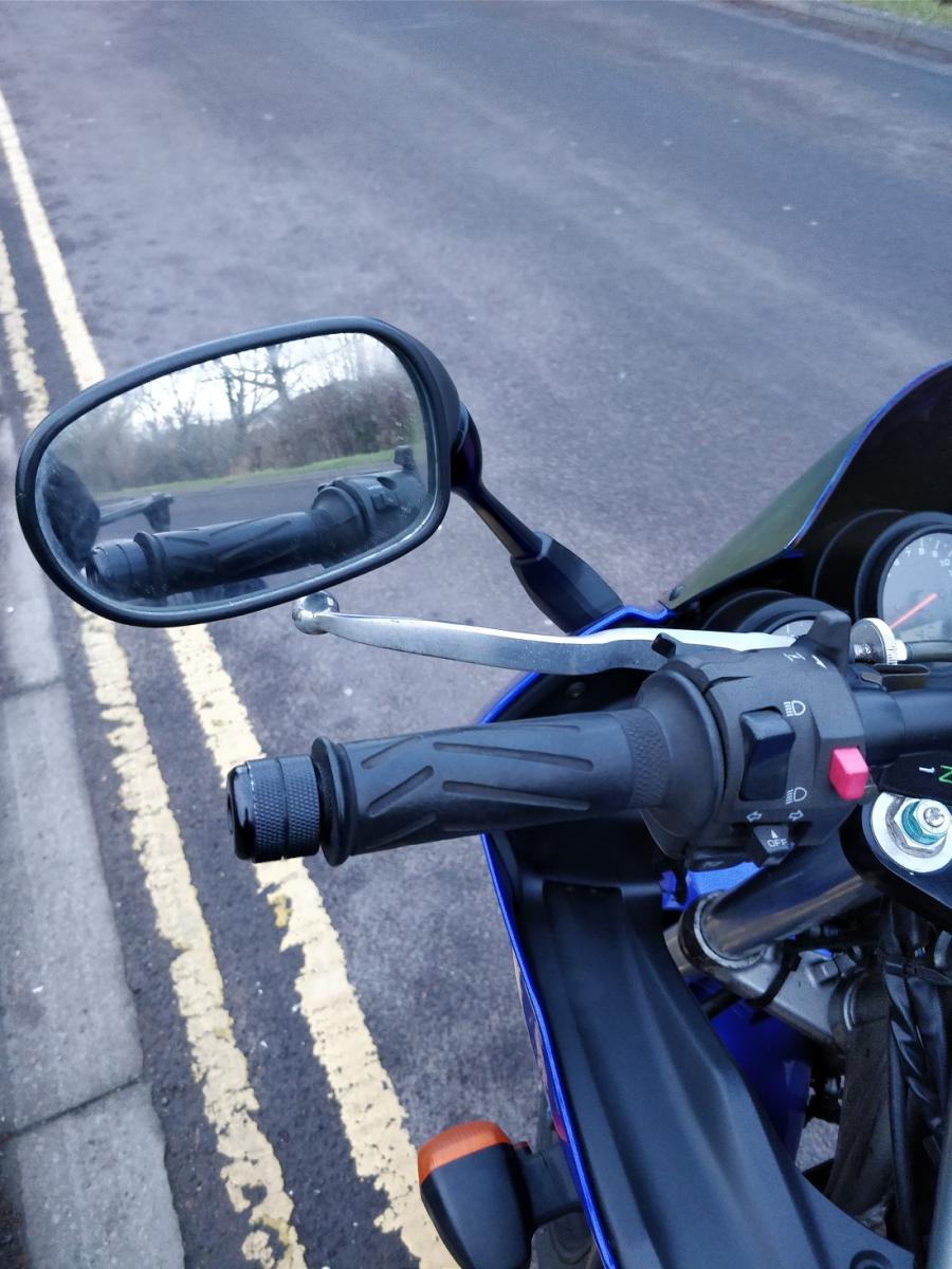

Handguards, I've seen alot of posts about them, but having a play with the steering, I can't see handguards fitting due to my mirrors. Would the fuzzymod help this matter, along side helping with the huge blindspot behind me?
Cheers all
