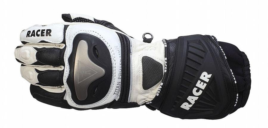

My issue is that I do have some very good expensive gloves that are both warm and have protection, Racer Titian these in the picture. But because of crap circulation in the fingers they get cold, my hands - per-say do not get cold neither do my thumbs, so that is why I was thinking of inner glove and only to heat the fingers.
