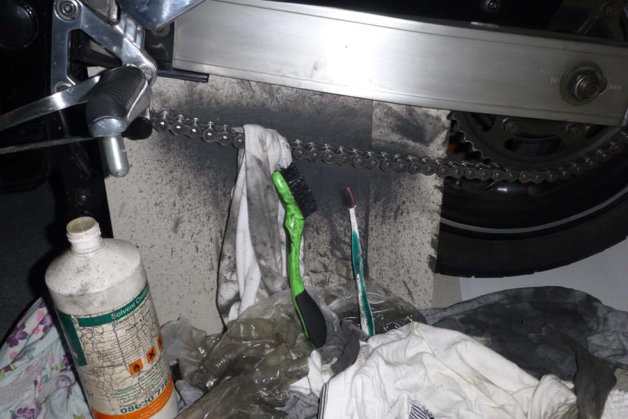

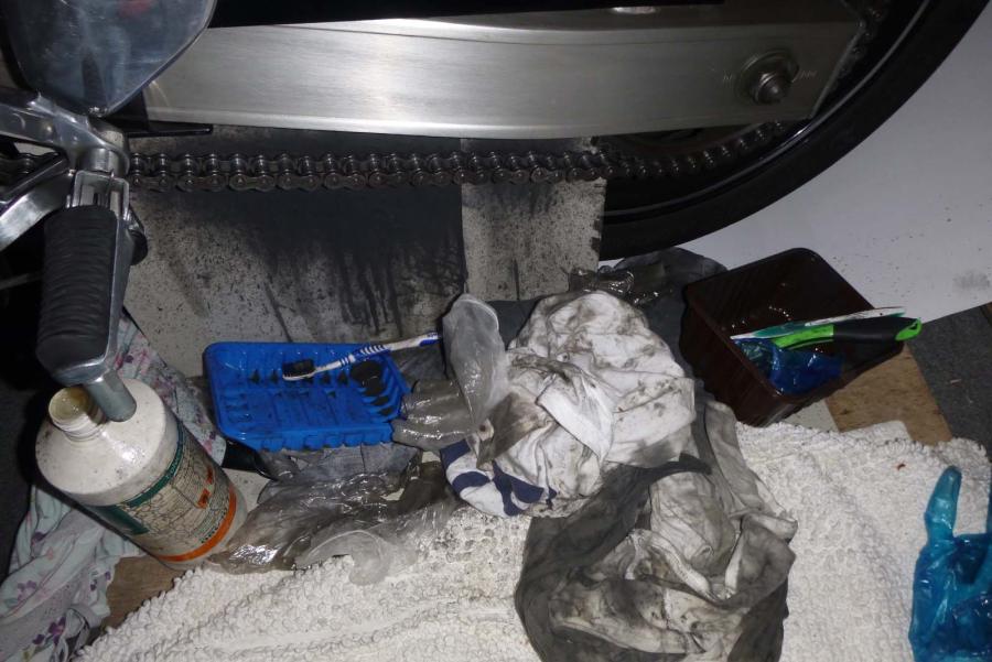

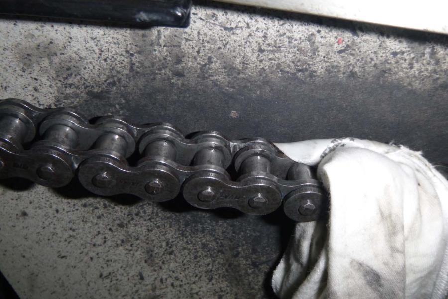

Had a search to find a better post to add to but couldn't find anything better so adding to this old one but all relevant.
Just been cleaning my chain with paraffin and to aid the drying I use a can of air and blast out between the links but it soon freezes up and slows down.
Question -------- could I use brake cleaner to finish off with as that blasts out of the tin and would do a final clean and also push out the paraffin and then very quickly evaporate unlike paraffin that does not quickly evaporate. I am thinking that if it is safe for brake rubber then its safe for o -rings ?
#36
pictures, don't panic its not solvent in the bottle -its paraffin
#37
Brake cleaner is brilliant stuff, but i don't see why you'd want to totally degrease a chain.
Cleaning is one thing, but completely degreasing it wouldn't be my choice.
#38
(05-12-17, 10:25 PM)darrsi link Wrote: Brake cleaner is brilliant stuff, but i don't see why you'd want to totally degrease a chain.
Yes that is a thought,but as I am a bit OCD I think all the grease is off or most of it and i was more looking at removing the left over paraffin so I can get new lube in there but with paraffin there its going to be fighting that.
I use Putulene Chain Tech that comes out thin and gets everywhere and then gos hard and is nice and white.
I will have a look tomorrow to see if the paraffin has had a chance to dry up between the plates and rollers, so we think brake cleaners is safe to use do we?.
#39
Brake cleaner is defo safe for your chain will not effect the o rings.
