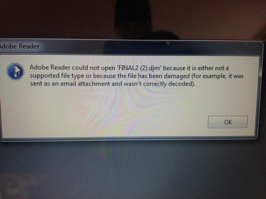

Ive managed to get the software on the go now & up.oaded all of the maps from the dynojet site which going by the descriptions are totally bonk...none with fce or air box mods or de cat or o2 eliminators........perhaps they will still be better than what ive previously had ie....nowt :lol
When i try getting brookers map i just get this message
#37
No idea what that means, hopefully someone with more computer knowledge can explain the error and show you how to get it sorted.
As for the dynojet maps just about all of them are for standard bikes or with more free flowing air filter and various end cans only, you could try a few but they will not work properly with your mods, at best you will be still running lean probably.
You could try a few out from the American FZ1oa site, that is what I tried, some were abysmal and some were quite near but still not good at all revs, this is why I eventually went for the custom map even with my few mods.
#38
He e.mailed it to me, I just saved it and opened it with the power commander software and saved it.  also make sure you "get" the map from the pc5 (if it had one) and save that too.
#39
Noggythenog, from your post #33 it looks like you somehow associated the Dyno Jet Map file (*.djm) with Adobe Reader so when you double click the file to open it you are getting the error message because Adobe Reader doesn't know WTF it is.
I suspect you'll need to load the DynoJet software then Open the file from within there.
#40
Be aware that the PC5 software won't default look for pc3 maps (suffix .djm), which is what Brooker had. You will need to pull down the box to change the file type. The PC5 software will then interpolate to create the more detailed map - you could then save it as a .pcm file
